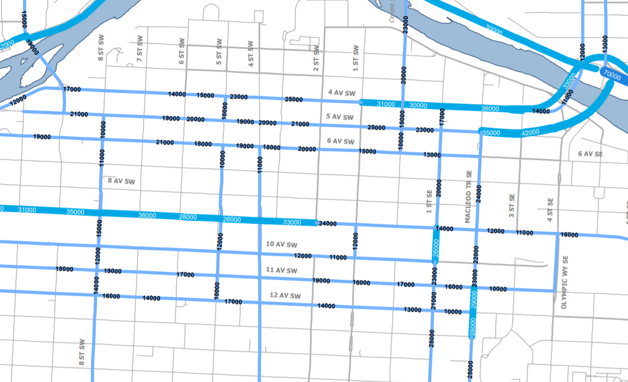

Sure it's not new, but it's sparking a discussion around eliminating lanes in the CBD. Here's the traffic volume per day in 2019:

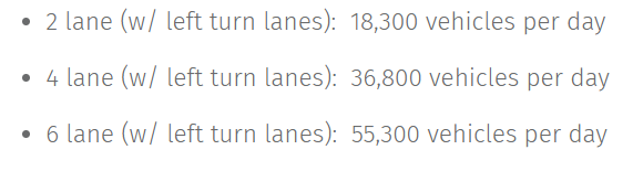

Notice how most streets are between 15k-25k vehicles per day. Here's some capacity figures from traffic engineering:
It shows that our streets downtown are largely too wide for the capacity they see. Also note the capacity figures are 2-way and many streets downtown are 1-way.
TLDR: eliminate as many lanes as necessary to make the green line happen, we have the space.
Theres no need for 9th Avenue to be 4-5 Lanes the entire length of the core, same goes for 6th as well. It never hurts eliminating a lane or two on roads that are under utilized to improve the realm for pedestrians and street level activities. Further more, where the station at 7th Avenue and 2nd Street is supposed to go it would hurt no one if the closed that section of 2nd street to build a decent square around the entrance to the station considering that this station would probably become a small transit hub.
totally fine with 2nd being a woonerf.
Thanks for this image. Based on this, is there a particular reason why the greenline has to be underground in the beltline? The whole point of the low floor LRV is for it to be integrated with the streets itself. I wonder how much cost savings would come from not having it go underground until 2nd ST SW. If it's a significant amount, I wonder if this could make the north leg go further past 16 AV N then? Because I do agree with the Alberta government that it is pointless for the greenline to end there simply to just make future extensions easier financially.
