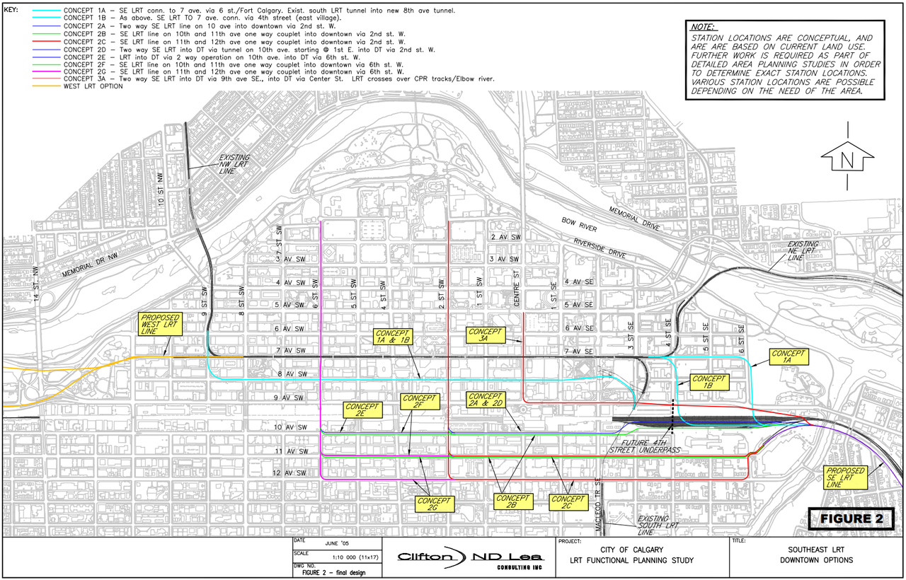

I've always been really curious how 2nd St SW was chosen, and why it has never been reconsidered when seeking cost reductions (though 10 vs 11 vs 12 Ave and grade has always had a lot more discussion). I have a sad feeling that the reasoning is as simple as 'it wouldn't lose any traffic lanes', but I've always thought 1st St SW had a ton of advantages over 2nd St.
I've never been able to find any reports on the early days of deciding the N-S downtown alignment...does anyone know if these options were ever public? Can anyone tell me why they are taking the challenge of tunnelling under the Lewis Stationary building and ripping an eyesore through PIP when 1st St looks so much easier/cheaper?
This is another interesting alternative; not sure if it was ever considered seriously. I think missing the beltline would be a big loss, but they offer some other strong arguments (and we're barely touching the beltline as it is)
I assume 2 St SW is more centrally located and was selected before the NCLRT was combined with the SE and no longer branching off the blue line to run up Nose Creek.
2nd St was a compromise. At the time the alignment was being considered the City did a study that showed the highest concentration of jobs downtown was along 4th St and so that was seen as the ideal alignment to put transit riders closest to the bulk of the jobs. Once 4th St was chosen as the ideal alignment they started looking at soil conditions for tunneling and they realized 4th St was going to be extremely problematic and so 2nd St was chosen as it was the furthest west they could get the alignment without creating a large construction risk due to soil conditions.
