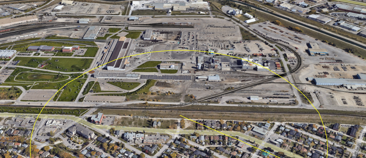

I don't think I fully understand the 78 Ave tunnel project.
As a pedestrian connection from Ogden to the canal pathway, it's great.
But why is a vehicle tunnel needed? If the idea is to get trucks into the area bounded by the tracks and the canal, they can already do that via Barlow and 61st Ave. I suppose the tunnel would divert trucks currently cutting through the community along Ogden Road north of Glenmore, and using the existing 69th Ave crossing, but how many trucks are doing this? And would they not just switch to Barlow and 61st if 69th were closed?
The city's page says 78th will not be designated a truck route, further confusing me (unless they just mean west of Ogden Road?)
I also don't understand the bike/ped infrastructure north of 78th, or the 72nd Ave pedestrian tunnel. Who is walking into that area in great enough numbers? Is there a major employer?
If the area between the tracks and canal is slated for some major TOD, I can see the need for all of this. But much of that area looks like an active railway yard and intermodal distribution centre.
Pure speculation but I suspect that it may have something to do with the fact that with with the railyard bound by the canal and tracks there may be requirements for emergency services to have multiple access points. With the crossing at 69th closing if anything were to shut down the 61st bridge there would be no other route in.
It's a textbook example of surplus extraction. The basic act of building the green line will bring in enough benefits to the city that it could be built for twice the price and still provide a net benefit, so the various 'stakeholders' will put in asks and requirements and scope increases and so on until the price has doubled. It still technically provides a benefit, so it'll get built, the local stakeholders get their goodies and who cares that we could have built twice as much instead. See also the underground Beltline section, see also the trenched West LRT at 45th Ave, and so on. If we built the Green Line at the price that Ottawa built their Confederation line for (adjusting for inflation), we'd be able to build 30 km instead of 20, up to 96 Ave N. If we built it at Edmonton Valley Line prices (again inflation adjusted), we'd be building 40 km instead of 30 and could do the whole line in one shot.
There's absolutely no need for this tunnel; it crosses a rail line that has about one train per hour, and increases access to basically nothing. But CP doesn't want to have the same disruption to their staff that they are absolutely fine with dishing out to everyone else, and they have the right of way, so they put in a demand in the negotiation. And there's no real pushback; in this case the legal framework around railroads in Canada is a fairly unique problem and one that should have been sorted out a long time ago by the feds, but there's plenty of other situations where it's just caving in to expand the scope and cost because that's easier than making a few people mad.
This area (400m circle from pedestrian tunnel) does not need millions of dollars of enhanced access.
To add for the reasoning for CPKC, the orientation of Ogden Road/69 Ave/Ogden Dale Rd means that typically 5-7 vehicles get through the light to make the left hand turn onto Ogden in the afternoon, creating large backups for employees leaving. When the Green Line goes in, there won't be room for vehicles to queue when waiting at 69 Ave. Large trucks going slow/stopping at the crossing would be a large risk as well.
The other impact for Ogden Road traffic comes when a train passes through during the morning commute. This creates large traffic backups as dozens of cars line up along Ogden Road waiting for the crossing to clear. The tunnel will help a lot in that regard.
