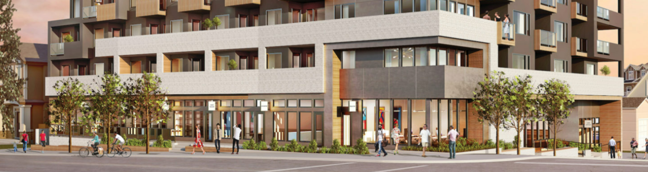

I went back looked at the concept elevation drawing on Sarina's website and the only reason why we got this elevation is because of the sidewalk. If you look at their picture the sidewalk is up against 33rd, leaving room for the stairs. Why have the sidewalk so close to the building with a plain grass boulevard? I assume it was done this way to meetup with the existing sidewalk to the east. Is that a thing? Why not just have the sidewalk transition? No excuse for 18th St. though...
I wish they kept the store entrances at sidewalk level and just stepped the entrances down a few feet so every door is at street level even though it's on a slope. The 1st floor roof can still be the flat slab to simplify the construction, but just vary the first floor heights to match the profile of the street (shorter on the west, taller on the east). That way it's contextually designed and considers the street it's on first, not last. All good walking cities with good main streets but have hills do this to their buildings.
As it's designed now it's pretty sloppy and totally defeats the purpose of having retail on the ground floor. Huge miss.

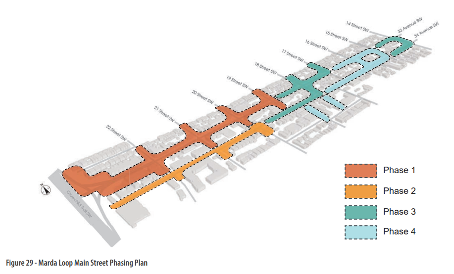

Phasing here:
I’m hoping the City does this Project in fewer phases given how long it has taken to get to this point (still waiting for detailed design to be completed).
I also don’t think the phasing they originally proposed makes sense.
First off, the idea was that developers of properties fronting on later phases would undertake some of the work/cost to complete the streetscape, but we’re seeing smaller “missing middle” proposals popping up. Getting developers to undertake the work only makes sense for larger, half block developments, and only if they’re all happening close together in time. 33 is not going to evolve quickly enough as you get closer to 14th, to put the onus on the developer, and the City has failed to get the developers who have built buildings recently to incorporate the Mainstreet vision because they have taken so long to get detailed design completed.
Secondly, to implement the Mainstreet, they have to have utilities relocated, change road/sidewalk alignments, etc. How do you properly implement cycling infrastructure on 34 if it’s in 4 phases?
I just can’t see the phasing working out the way it’s outline in the Masterplan (but maybe it will have to because funding keeps going to downtown instead).
