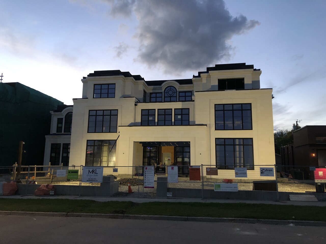

Big infills in Crescent Road
It really is not an optimal solution at all in my opinion. There are other ways of reorganizing smaller slab-on-grade townhomes so that they don't produce this excessively hardscaped, car-dominated public realm experience. Limiting this to one curb cut and having the garages off of the rear with a narrow strata road would produce a much nicer public realm with these buildings. I think the reason that they organize the buildings this way is to maintain the required larger front setback. If the builder was allowed to push the building closer to the front property line and sidewalk, they could add the parking in the rear or centre of the site via a strata road.

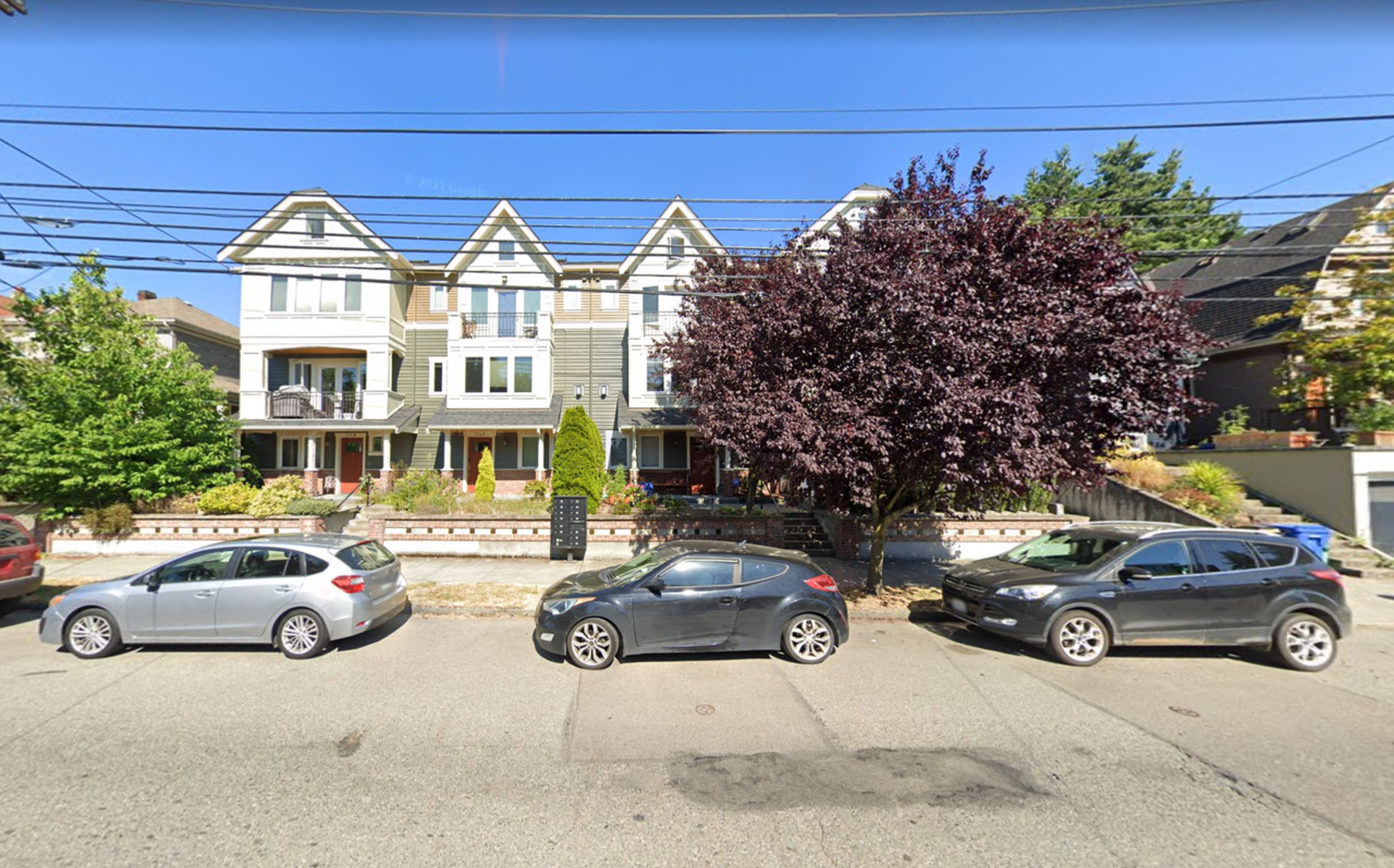

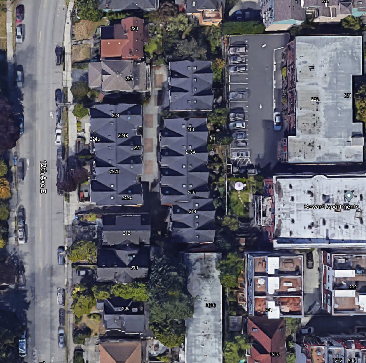

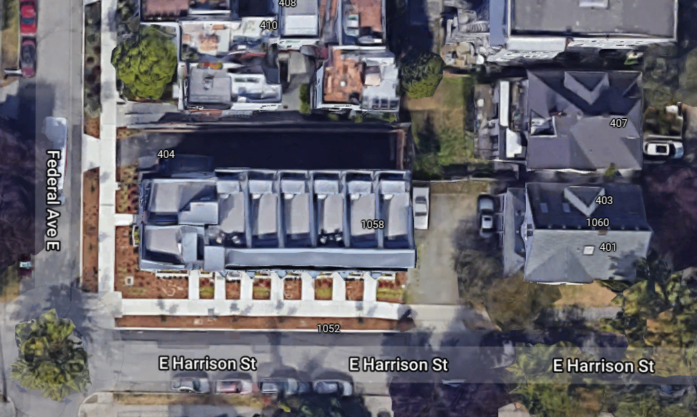

Here are a few examples of slab-on-grade townhomes on laneless parcels in the Capitol Hill neighbourhood of Seattle. They keep access to one curb cut that has a centralized strata road so that the public realm allows for interaction with the street and landscaping.
Heres the first:

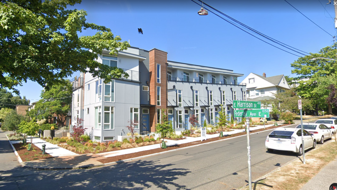

Number 2:
View attachment 348896View attachment 348897

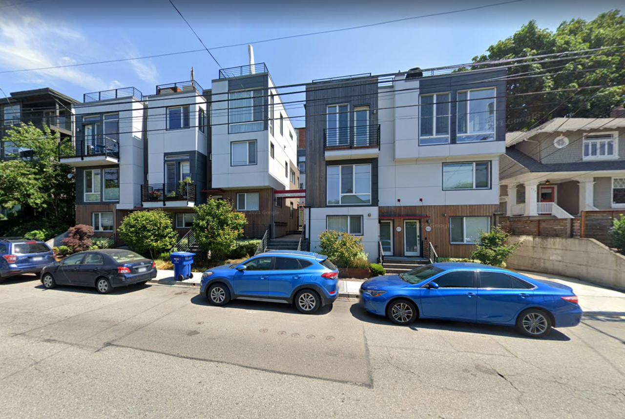

Number 3:
There appears to be a critical mass (minimum 8 units) to allow necessary radius.
