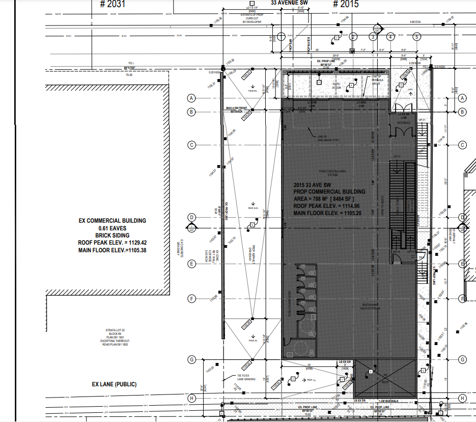

What moron in mobility engineering required two curb cuts onto a Main Street when the lane configuration could've provided the neccessary vehicular access? Or is this first submission on DP (pre-DTR1) that the applicant submitted?

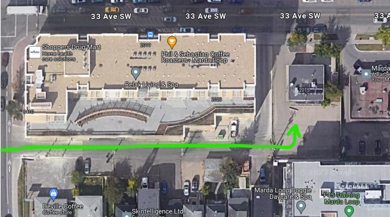

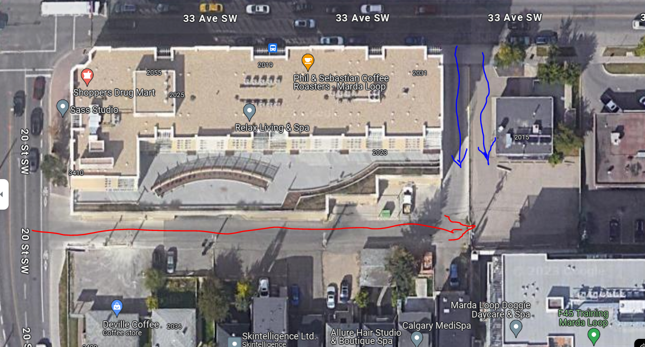

Red entrance is the dead end lane that could be maintained but the blue side by side entrances would be entirely redundant with a hammerhead design somewhere on the lane:
Centrals Taps is a nice add, and the materials are nice, but no way this should move forward with this many curb cuts along a Main Street. The planners who are working on Main Streets policies should fight mobility on access for this block or they will be compromising the main street improvements happening.
Totally agree. Everything else about the location and proposal is fine to me.
I find it hard to believe that using 25% of a parcel with existing lane access to allow for casual vehicle circulation (that is duplicative to adjacent lane access literally 1m away) is good planning. On a Main Street that is championing pedestrian walkablity none the less.
Take away the duplicative lane and all problems are solved. Plus the business can widen their revenue-generating part of the project that is the entire point (I.e. the building).
If I was a planner on this file I’d die on the hill on this one - not because it’s particularly important, but because the absurdity of creating double lane access points adjacent to each other, on a laned parcel - that arguably needs zero connections to the redeveloping Main Street, not two.
If there’s a point to planning, this is it. Prevent dumb duplicative accesses that contradict the design outcomes of a nice Main Street.
