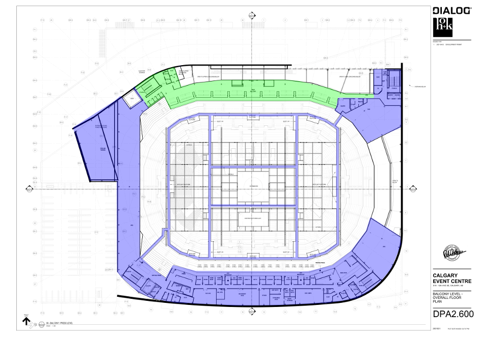

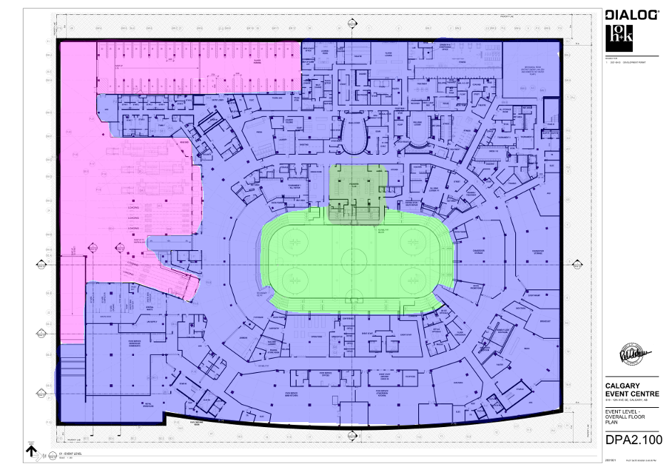

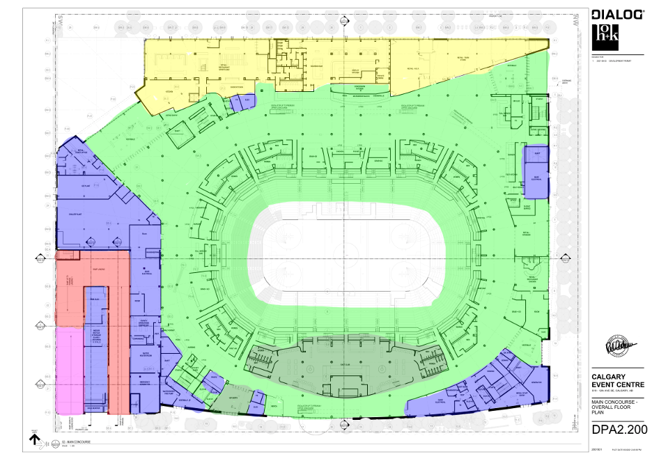

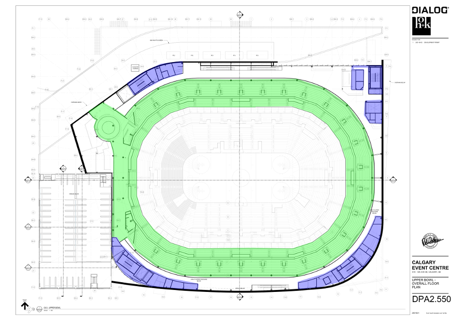

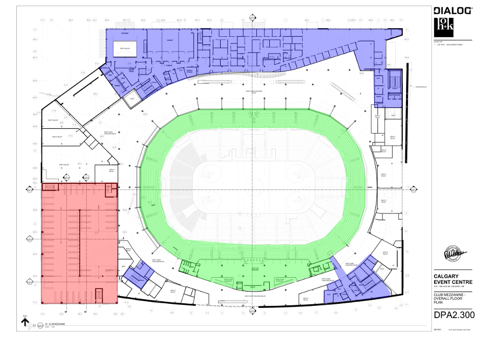

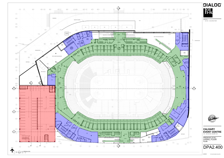

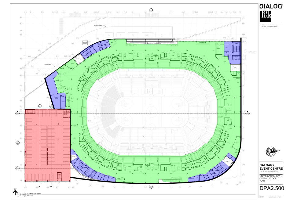

Here's a quick functional illustration of the floor plans based on the high def images. They're ordered from lowest to highest; ground level is the second one. I've coloured the areas (roughly) by use:
  • Blue: Staff and operations areas (e.g. storage, cooling, electrical, offices, dressing rooms, media, etc.)
  • Green: Attendee areas (e.g. seats, concourses, vendors, washrooms, the ice) -- dark green are 'exclusive' (club or suite) spaces, light green is the remainder of the attendee space.
  • Yellow: Public areas (accessible to people without tickets; restaurant, bar, merch store)
  • Red: Car areas (magenta - lower level - is loading docks, media truck, player parking space)
I wasn't super exact; most of the vertical circulation space (stairs/elevators) is in staff/operations. There's a west balcony on the highest level that I think is public space (and coded as such) but I'm not sure.
Just to bust this myth: Exactly the same place they would otherwise!!! The parkade includes exactly 190 stalls. 98% of the people entering this venue will do so on foot, from the street -- not to mention 100% of the people walking by should this become some sort of entertainment district. So the street level interaction is paramount. Ditching the parkade would enable a design with much more street interaction and would save money. The 190 millionaires can park across the street, the same as everybody else.
The parkade appears to be a premium parking option as it's only connection to the event centre is on the suite level. The city wanted to remove the parkade to save money when the project went over budget but CSEC insisted it be kept in the design. My guess is that the only way CSEC would have agreed to it's removal is if they were allowed to build a parkade across the street but the city said no.

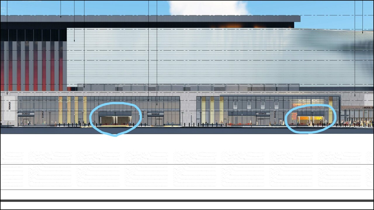

Assuming Dialog are the primary designers of the exterior while HOK designed the interior. Looking at the retail projects Dialog has worked on now makes me think they might be at fault for how terrible the street front is. For example the Edmonton studio designed the Edmonton Brewery District which has retail fronts eerily similar to the ones on the Event Centre. The Calgary Studio has only Deerfoot City listed as design credit for retail.
Edit - Looking at the elevation plans I noticed what looked like large openings for retail on Stampede Trail. Investigating further they appear to be folding glass doors.
