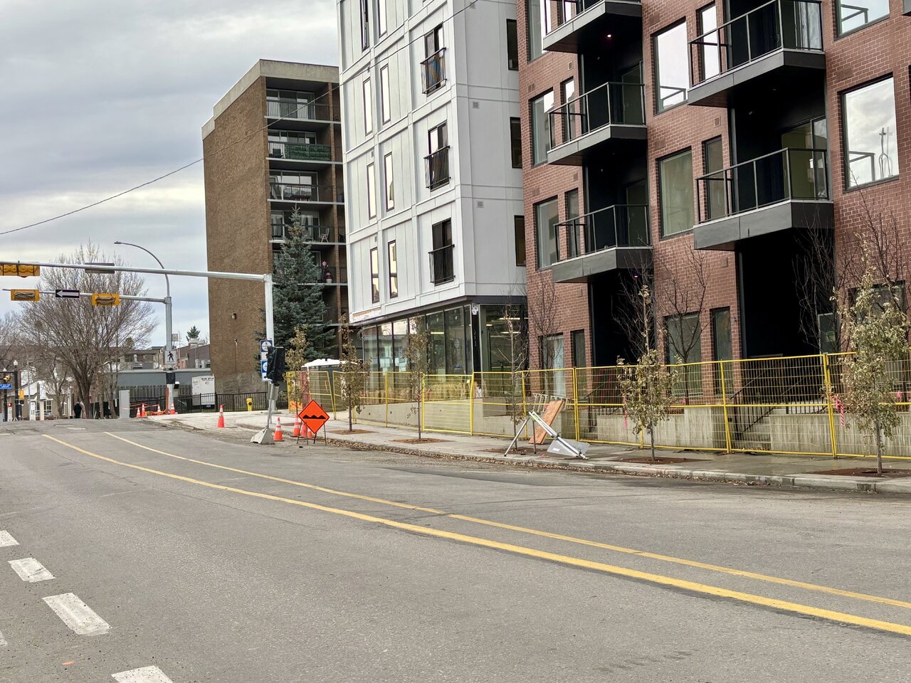

Man, it was just missing some retail along 2nd Street. Even two shops would've gone a long way; instead, they went for some sterile landscaping with planters. Otherwise, nice building.
Isn't that a retail bay with the glass walls, underneath the Broward sign? It has a for Sale/Lease sign up in it, and in the second photo, you can see the sign on the fence saying a commercial bay is for sale.
