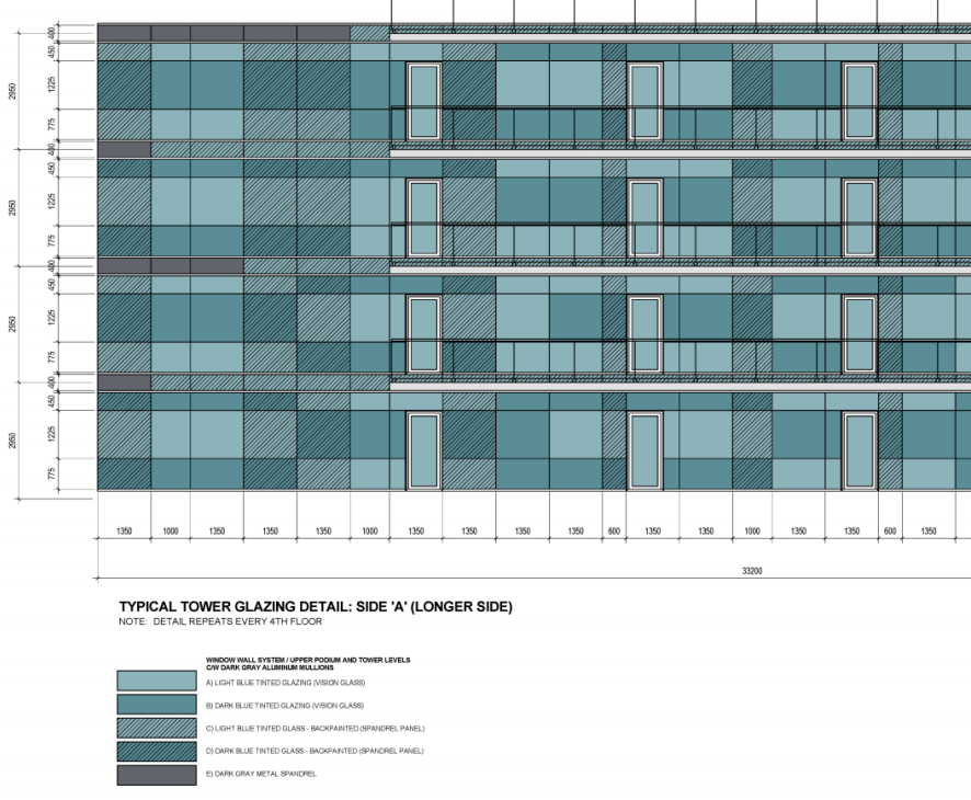

Here is what they say about materials on the towers:
181155

The two colours of glazing looks messy. The site plan does as well. The retail/restaurant spaces are a halfhearted gesture with only one space on either side and the rest of the street frontages occupied by loading and storage spaces.
There appears to be a lot of spandrel on this one as well. I think the glazing on West Village will give us an idea what this will look like as they want these 2 to be their signature towers.
