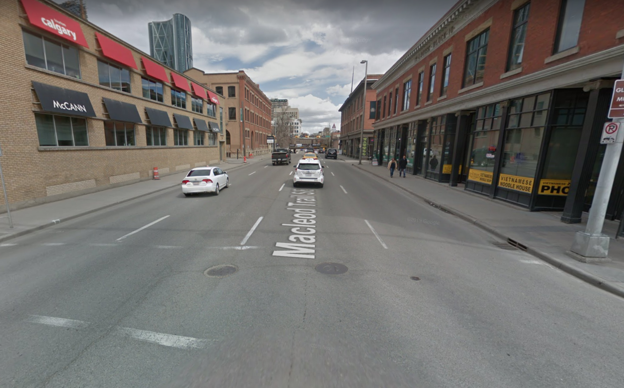

This picture pretty well sums up what is wrong with the public realm in the core. What could be a great connecting point for pedestrians into the CBD is a four lane car sewer with 4m wide lanes and narrow cluttered sidewalks
3 of the 4 buildings on that street are quite nice though, and Louise Block has retail at grade. I'l love to see a more pedestrian focus there, but every attempt has failed, McLeod is a dead zone and I don't see it changing any time soon. Like I said before, I think there are a ton of other streets that we can improve the streetscape and actually be successful.

It being a "deadzone" is a symptom of the root cause - a car oriented streetscape. Start to address that and the pedestrians will follow. The two are interrelated.

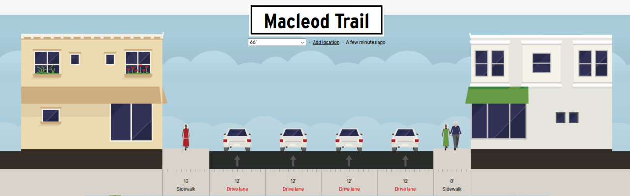

I strongly disagree that any change requires a negative effect on traffic. Here's the block Disraeli linked above as it is:

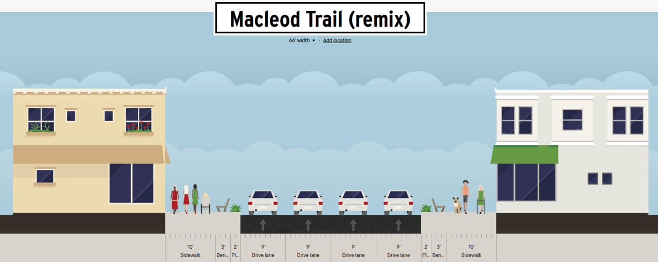

Here's an option:

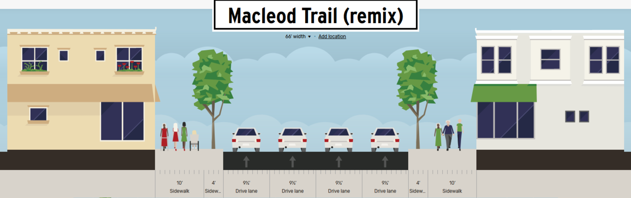

Here's another one:

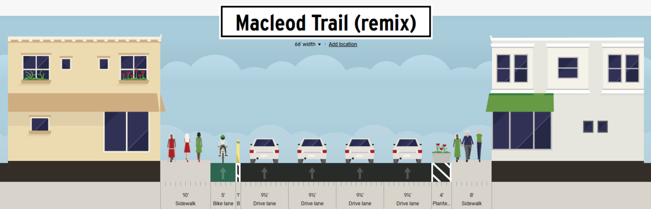

Here's one that doesn't require any concrete, although it would require signals changes for the cycle track:

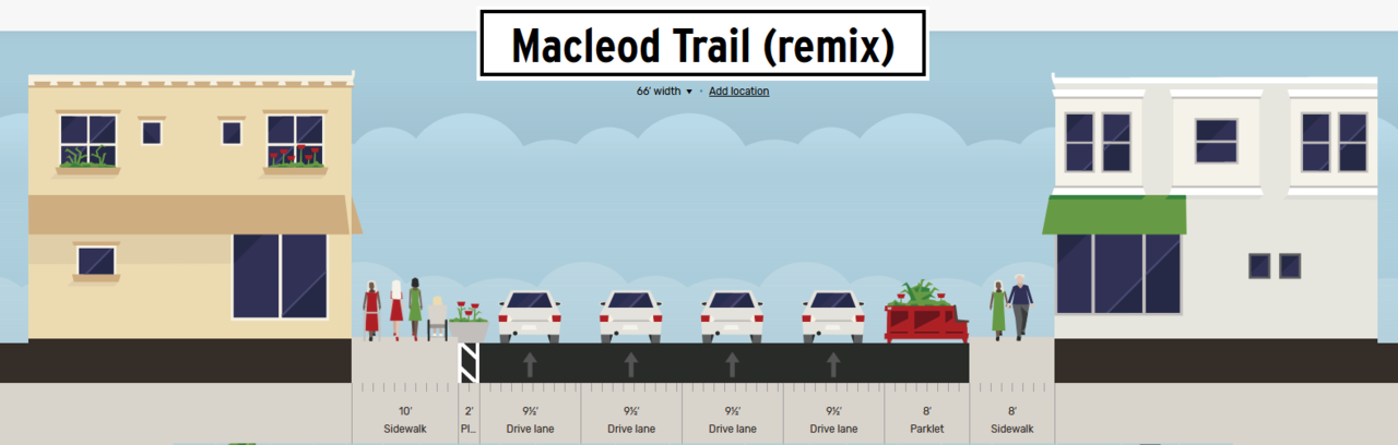

This one doesn't even need signals; it could be done for the cost of paint, planters and parklets:

Note that the number of lanes is not affected in any of these.
What's the minimum lane we can have that will accommodate buses or truck traffic? I'm OK with squeezing it a bit to make it more attractive.
