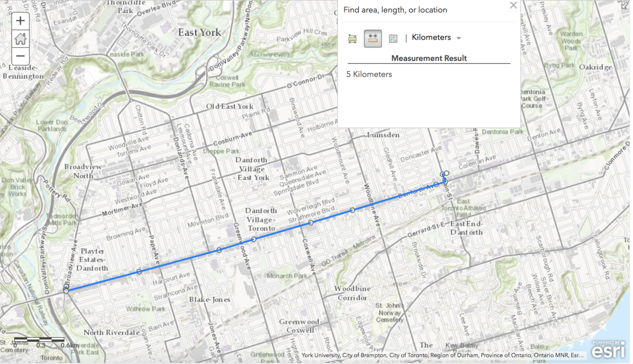

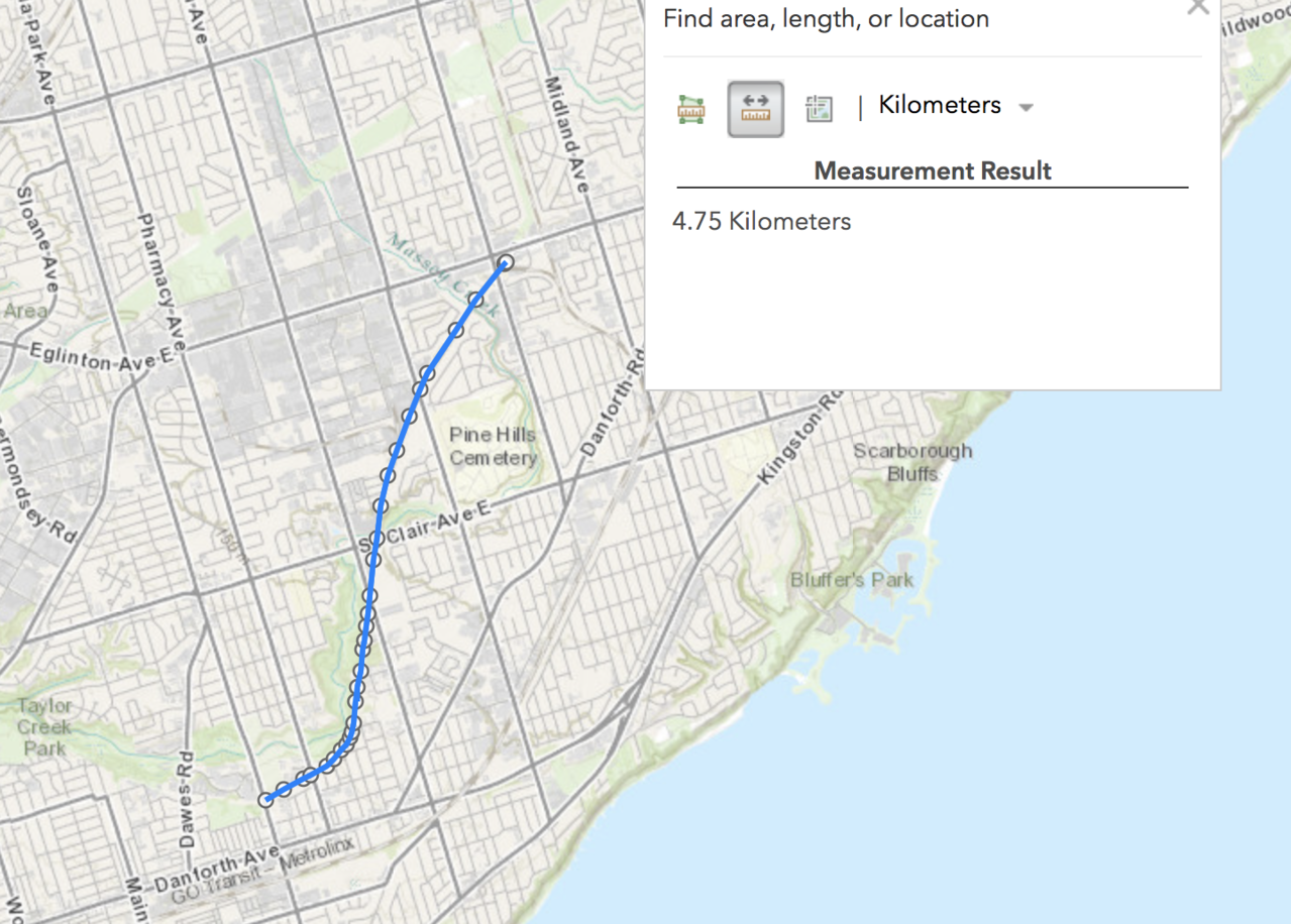

To be entirely fair to the first statement, The Broadview to Main section of the subway is 5.25km while the Victoria Park to Kennedy section of the subway is 4.8km
According to Google, it's 4.78 km.
Victora Park to Kennedy is 4.91 km.
In total, the Vic Park -- Kennedy section sees 2722 vehicles
The Broadview -- Main section sees 3024 surface vehicles without considering the extra capacity of the streetcars. If this is taken into consideration, that number increases to 4,310 bus equivalents. In essence, the Old Toronto section of the subway sees more buses, has more stations, runs entirely underground, has greater density, and has relatively the same ridership as the Scarborough section of the subway. In fact, its rate of ridership per kilometer is less than that of Scarborough's.
Are we considering the 'extra capacity' of the RT and travel distances?
I used ESRI,
Note, the Old Toronto section does not include the extent of the platforms, which, when included, would increase the length to about 5.25km.
