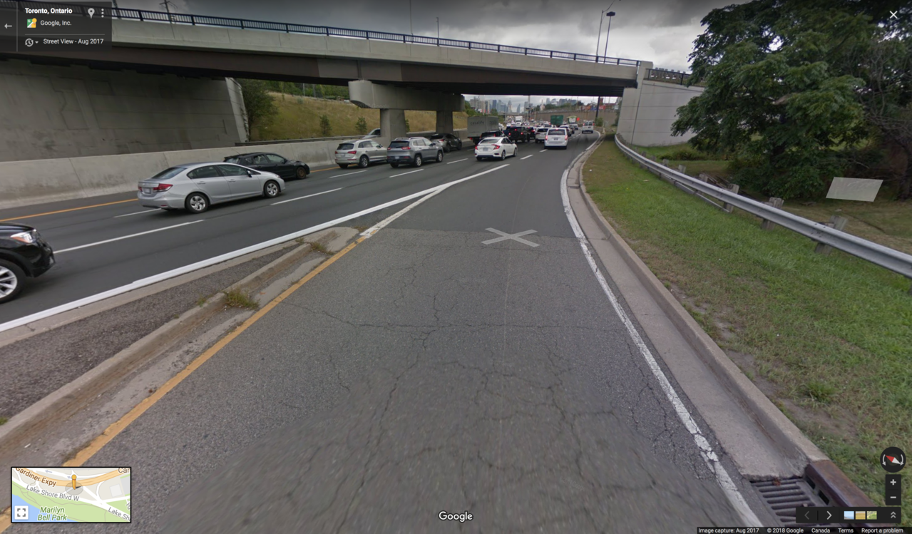

A particularly problematic example of this is the acceleration lane from eastbound Lake Short Blvd. to eastbound Gardiner. This acceleration lane is extremely short, and nothing warns drivers beforehand about how short this lane is. On numerous occasions I've witnessed cars accelerating to highway speed on this ramp, and then suddenly braking when they realize that they've been provided with no room to safely accelerate and merge. If the City isn't going to build a proper acceleration lane, they should at the very least put up signage to alert drivers to the shortness of the lane.

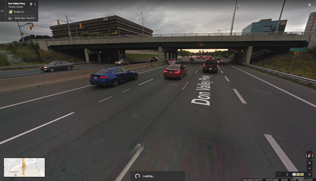

Anecdotally, last time I entered the Don Valley Parkway North from Eglinton Avenue, I immeidately noticed that there were no signs indicating that the lane was ending. Accordingly, I treated the lane as a through lane, and didn't prepare to merge into traffic. It wasn't until a little bit down the road that I noticed the lane actually did end, and I had to very quickly change into the left lane. Although I was able to handle this unsafe situation fine, it could have been totally avoided with basic signage.
To be fair, that speed change lane doesn't end; it exits. A lane ending sign isn't appropriate in that situation. A more appropriate sign might be a right pointing arrow. The Eglinton exit does have a sign showing that the lane exits, and the short dashed lane division line is a visual cue that the lane will exit or end soon. The design of the interchange itself is more problematic than the signs. Having the same lane for entering and exiting traffic isn't really done anymore unless the distance between them is much greater.
I think you've got the location confused. On the northbound DVP, just north of Eglinton, the merging lane does end. You can see the streetview here.

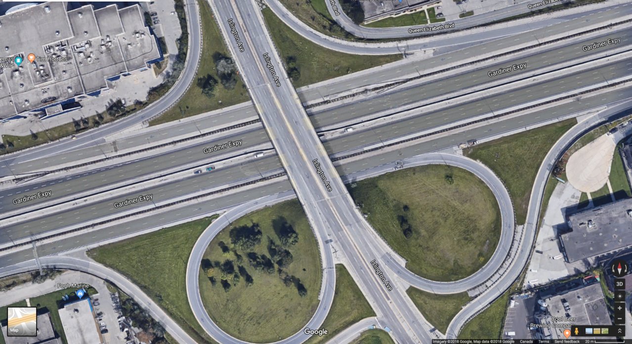

The connection between Islington Avenue and the Gardiner Expressway is a combo onramp/offramp. The length of the area you have to merge here is stupidly small - just 100 metres. In my experience, if you have someone already in the onramp/offramp trying to get into the through traffic lanes, you're going to have a very difficult time merging into the offramp.
I'm embarrassed to admit that the first time [attempted] to use this offramp, I missed it because it was so short. I was leaving room for the car already in the offramp to safely merge into my lane, and by time they did that, the merging area had ended. I hadn't realized there was so little room to merge, so I assumed I had plenty of space remaining.
The signage in your post, with something indicating that the merging area is only 100 metres, would help prevent situations like this.

Ahh yes, you remind me of another pet peeve of mine.
Oh I see. That interchange has two ramps to the northbound DVP; one from the westbound lanes of Eglinton and one from the eastbound lanes. I thought you were talking about the other one. What you're describing is actually pretty standard on provincial highways. There's often no sign signifying that the lane is ending at the end of an acceleration lane; the short, wide lane dividing lines are enough to tell drivers the lane is going to end. Here for example. That said, it does seem like a sign is typically added in the GTA but not in rural areas. Or maybe it's a new standard that was adopted in the last decade or so. Which means Toronto will adopt it sometime around 2060. :D
