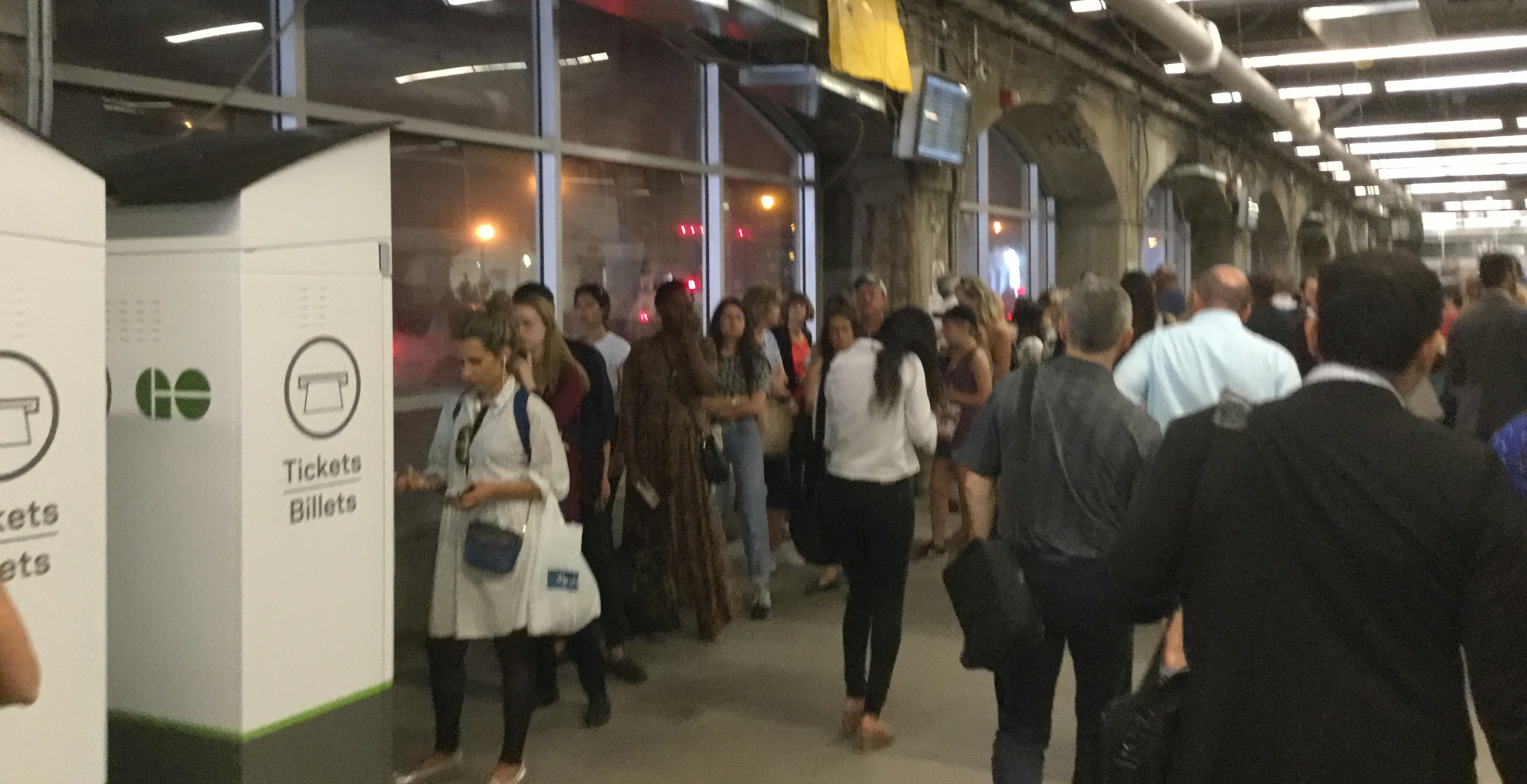

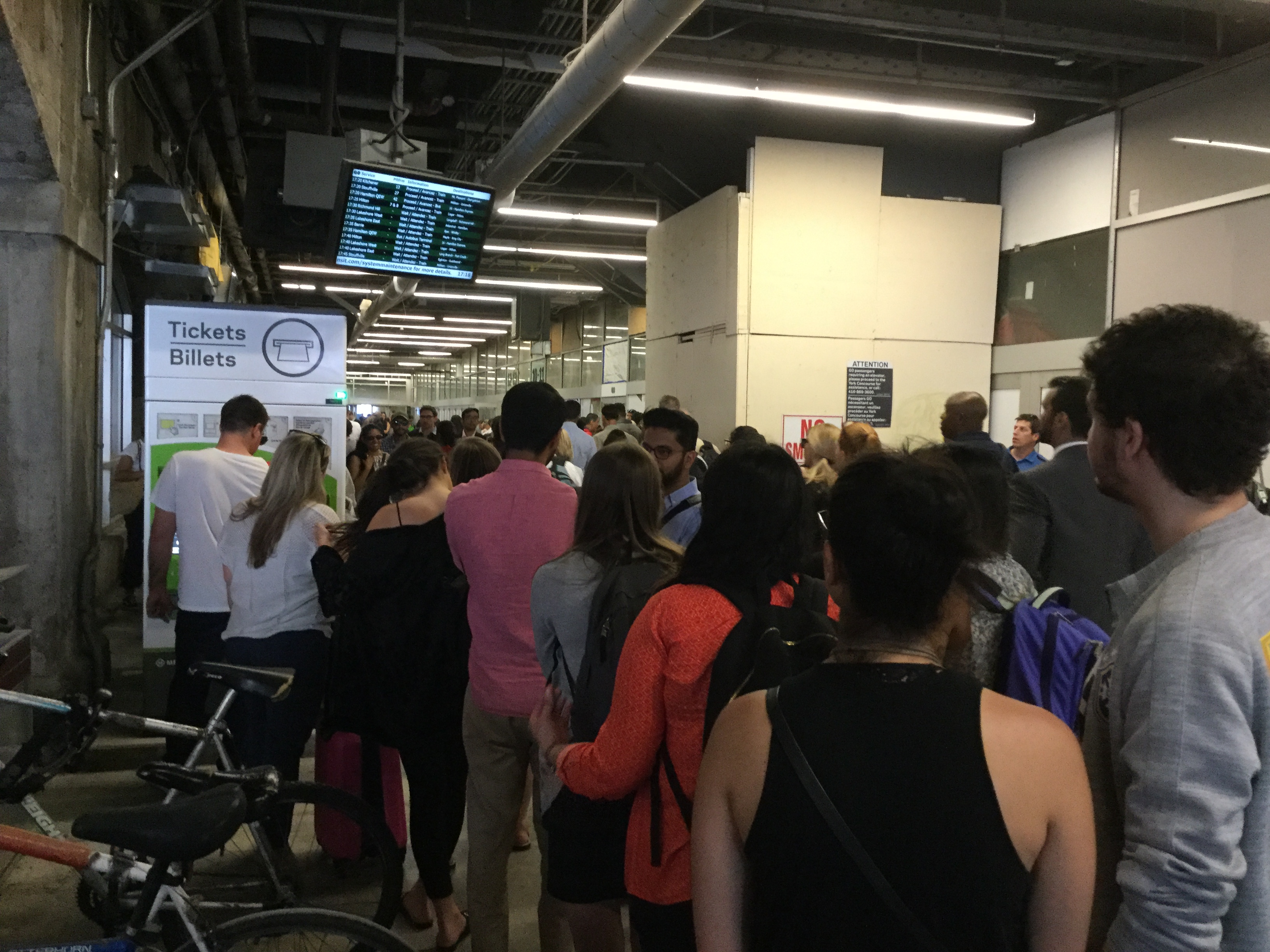

Factor 1. There is often a very long lineup at peak (5:00-5:20pm) at some machines
At 2-3 minutes average per user (due to slow performing machines and two major issues).
....a 10-15 person lineup like this photograph forces a 30 minute wait!

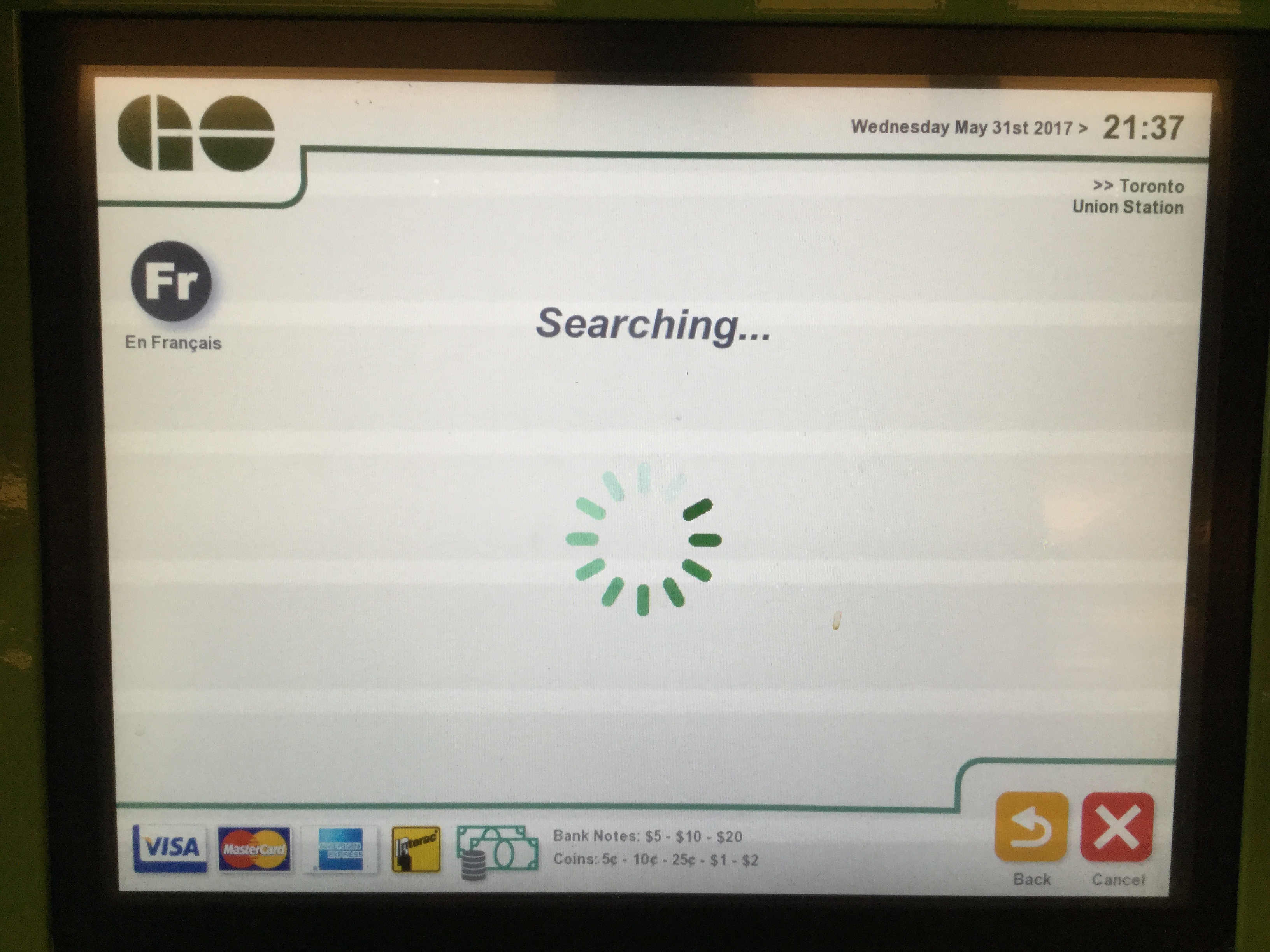

Factor 3. Peak Searching Overload. The "Searching, Please Wait..." screen frequently takes longer at peak
This isn't even about slow touchscreens, but the even super-slower "Search" screen.
Sometimes it decides to take 75 seconds instead of 5 seconds!
Most are familiar with typing in a station name, and being greeted by "Searching". It takes an few seconds offpeak but I have seen this screen take over one full minute at peak for some commuters sometimes.
Compound this peak-period "Searching.." overload delay -- and a 15-minute lineup takes 30-minutes to clear because of searching-slowdowns -- Many people are searching simultaneously, which seems to have an effect in a "Searching..." slowdown system-wide. (Server? Congested network? Regardless, this screen always dramatically takes much longer at peak)

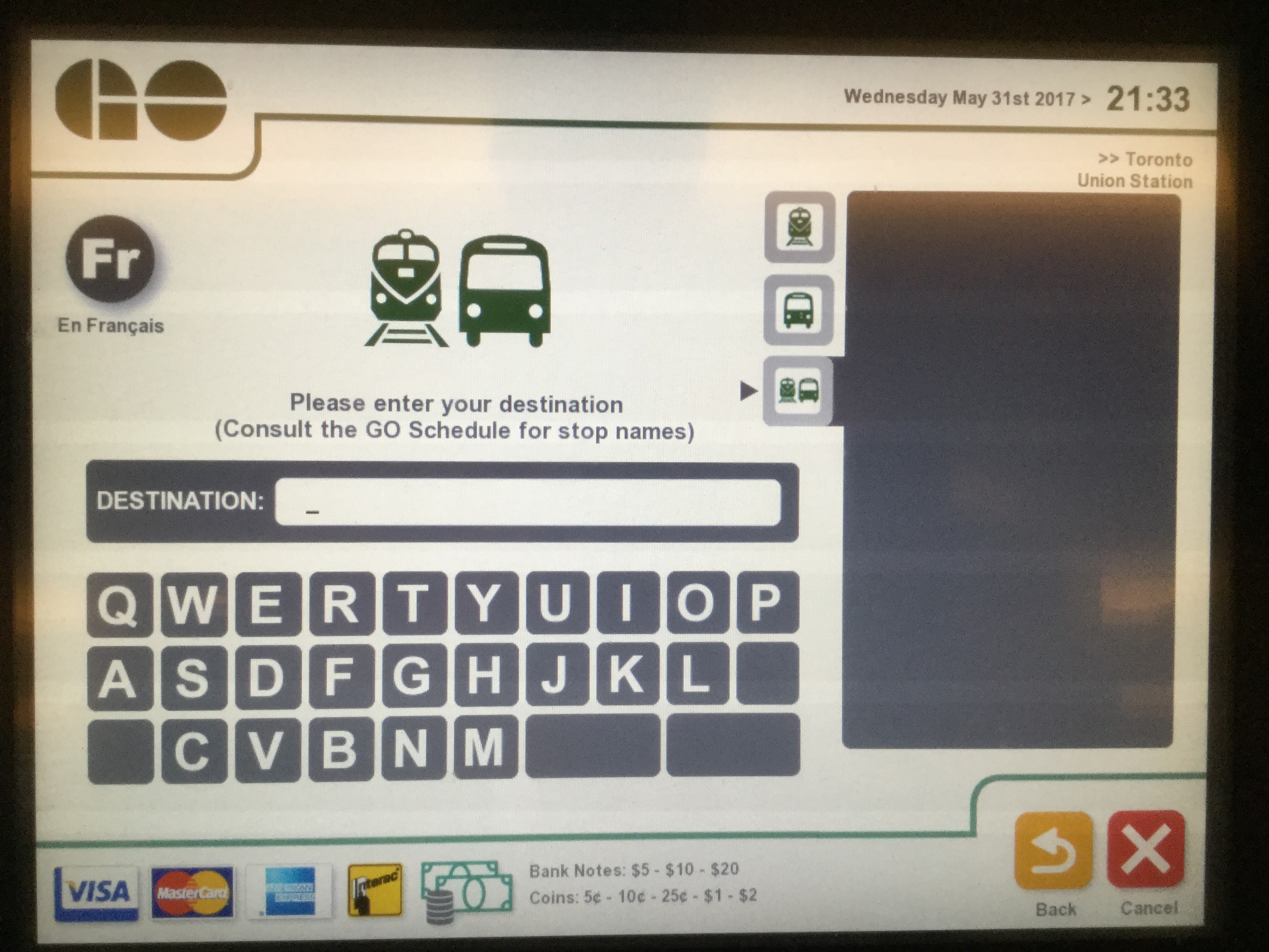

The search screen. Typing lags like hell.
Often takes 1-to-3 seconds at peak (overloaded machines) for the next keypress to respond.
This leads to typos as users try to type ahead.
Even offpeak, there is still a noticeable keypress lag (1/4 sec).
Perhaps the drilldown needs to execute in a multithreaded way, with higher priority to the keyboard thread. It is an old single-threaded microprocessor, but a firmware upgrade can minimize those slowdowns. Interrupt routines? Timers? Sequence of code?
Commuter's #1 most dreaded enemy of these GO ticket machines.
....especially when this spinner spins for 75 seconds instead of 5 second, with a lineup of 15 annoyed impatient commuters behind you.
Why not cache common search results?
There is enough memory to cache "Union" and "Oakville" even if not enough memory to cache the whole GO network list. Skip the "call-the-server-every-time", please. The server's tired at peak, it will thank you.
The previous 5 users probably searched for your exact station, so why can't the software simply remember these results from 5 minutes ago, and skip trying to connect to a peak-overloaded server?
That's not even the worst thing.
The "Back" button is located in exactly the same location as the "Cancel" button.
If suddenly Search decides to complete at the same time you try to tap "Back", you're accidentally tapping "Cancel" of the next screen below (and frustrating the commuter behind you as you start your search over again).

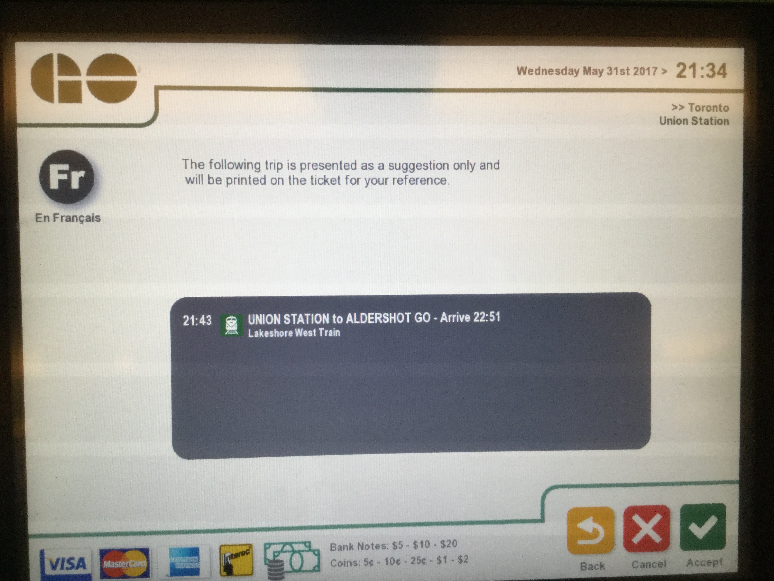

This is an easy screen.
We finally calm down a little.
We tap the green "Accept" button, but it lags bad. Sometimes bad 2 seconds instead of usual 1/2 second. Some inexperienced commuters mash the "Accept" button again, and then it eventually becomes the next screen.
....fortunately, if that inexperienced commuter is still mashing "Accept" in a hurry to get their ticket to catch their train, at least it harmlessly mashes this above greyed-out button:
Rare UI design compliment.
Correct graying-out of Accept button rather than rudely replacing an Accept button with a Cancel button.
Thank you -- but why isn't this best-practices exercised in the other screens?

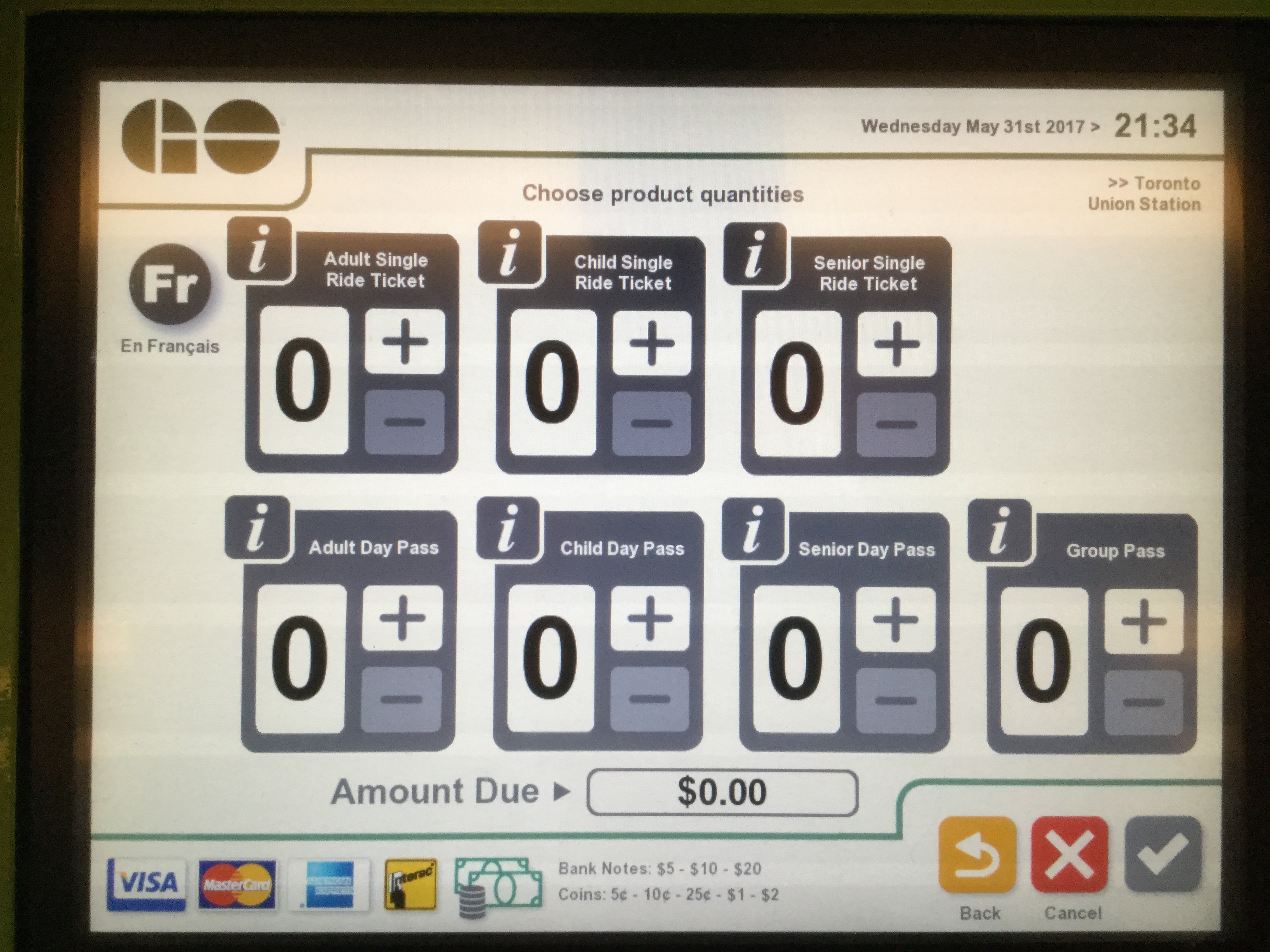

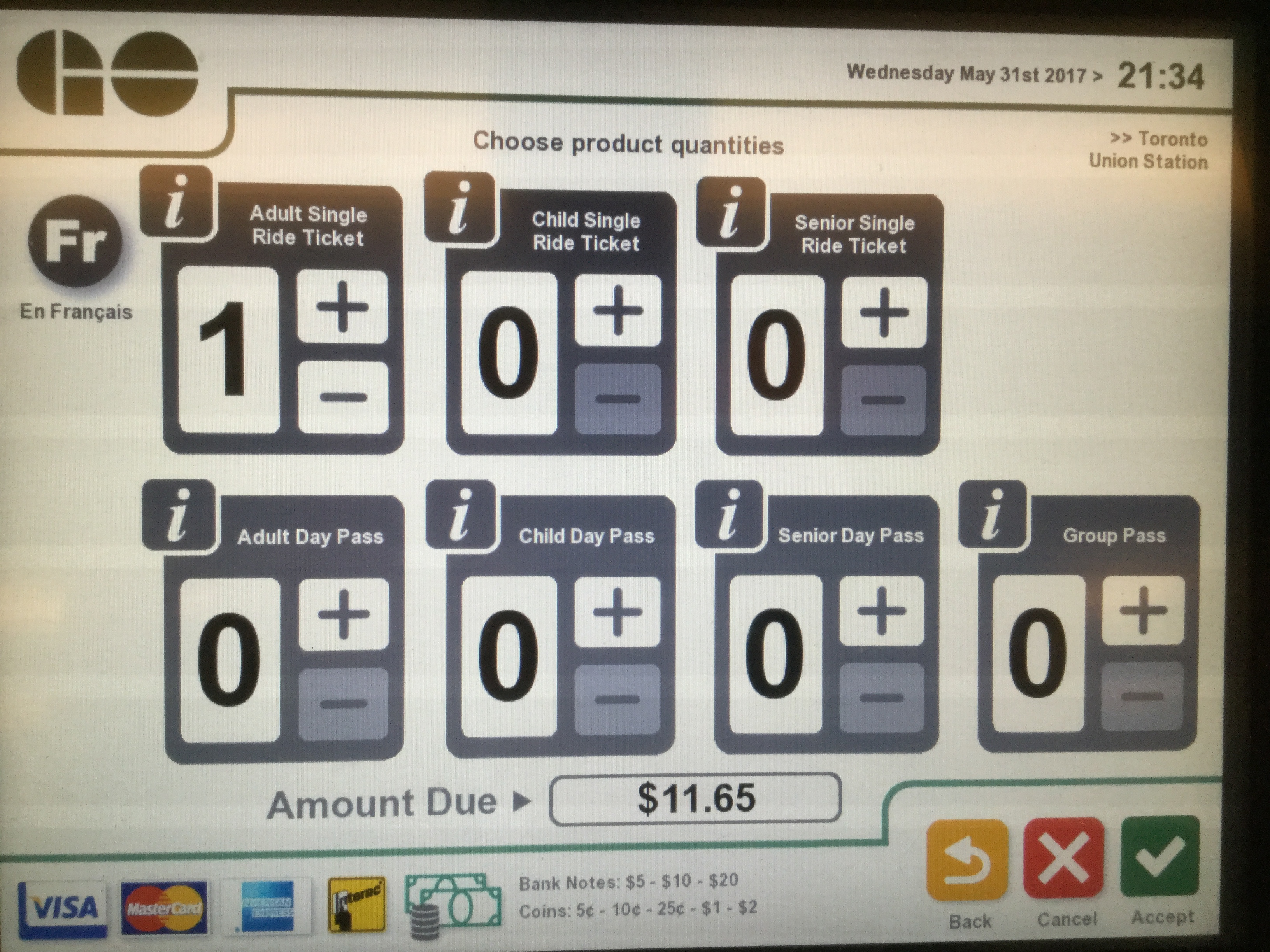

Once you increment passengers, things go quickly back to bad. The green button now appears, but sometimes it doesn't respond instantly. So the commuter begins to tap "Accept" again:
....but the commuter accidentally clicks "Cancel" below when the exact screen-surface location of "Accept" becomes a "Cancel" button.
Grumble.
Now that inexperienced commuter in front of me has to start all over again (with a slow search again too!)
All just because the slow nearly-non-responding "Accept" button suddenly becomes a "Cancel" button while the impatient commuter is still mashing that corner of screen in a hurry to buy a ticket.
Why this byzantine user interface decision? ☹️

1. Slow (at peak) uncached search spinner screen.
2. Slow
Accept buttons that suddenly become Cancel buttons (especially as user tries to aim at re-tapping a non-responding Accept button)
Fix Ideas for Ticket Machine Software Developer
- Caching searches to cut machine time waste dramatically.
- Simulate slow networks using custom router firmwares or "Apple Network Link Conditioner". Ping 2000 milliseconds, 10 percent packet loss. And test at 5:10pm. Challenge yourself to make machine behave faster under such network duress.
- Grey-out or hide buttons. Keep Accept/Cancel in same physical locations without shifting buttons into each other's place in subsequent screens.
