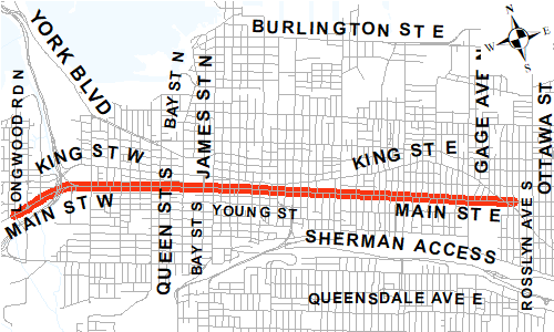

Main Street in Hamilton is likely getting converted to two-way traffic from Dundurn to Delta. This is a pretty problematic street for pedestrian accidents, and the redesign has sparked a lot of debate within Hamilton on its effect to residents.

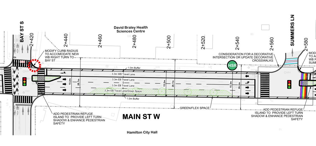

On mobile so I’m having issues pulling the PDFs, but design plans are here:
Very odd looking design drawings:
Travel Lane/Green Space? Which is it?
I can't make any sense of that as a road configuration.
You're creating a zipper effect (forced merge) for no obvious reason, to me.
I can understand wanting a right-turn queue lane, but pull the boulevard treatment back to Bay at least.
There's lots of whacky ideas here.
A median? You want to buffer the WB traffic from the EB traffic? Uh, no. You want to buffer cycle tracks or sidewalks from the cars.
Really bad design choices.
Bike lanes, yay! Oh...wait:
I read this as a painted buffer, instead of a curb or mini-jersey barrier............1.8M is adequate, barely. I would rather remove the 3rd vehicle lane entirely; but at the very least, slash the width of the non-curb lane to 3.0 from 3.3 and re-allocate that space for physical separation of the bike lanes.

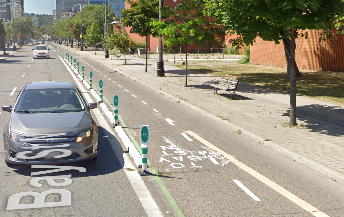

Barriers on the bike lanes will likely look more like this, which is closer to the standard Hamilton uses for new cycling installations right now:

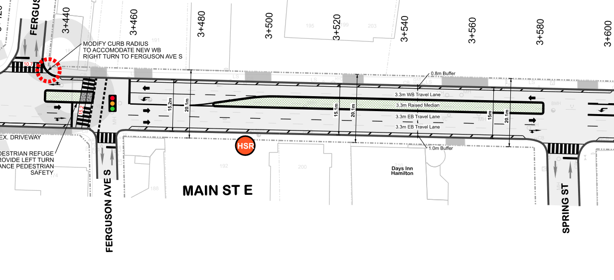

The median location is fine as it's only a small section with "excess" road space, not enough to really add bike lanes to the stretch.
My issues are with the off-peak parking in the much-reduced travel lanes, especially west of Downtown.. that's going to be a huge traffic causer for no real benefit.

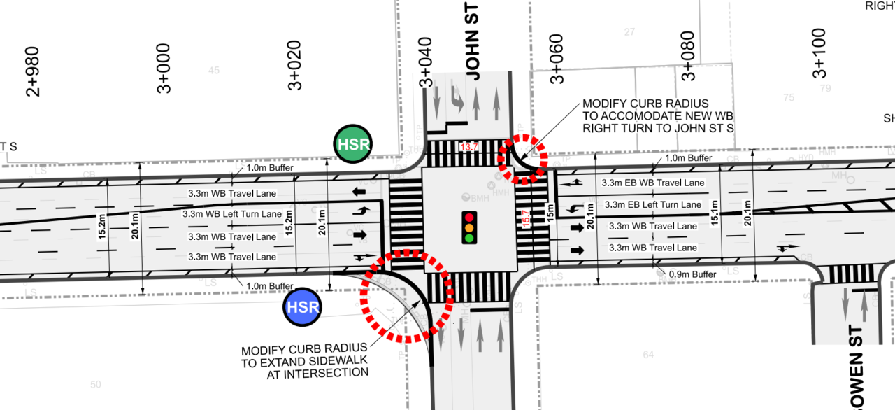

Also, these pointless curb barriers - widen the sidewalk here damnit! Adding curb radiuses westbound to allow for right turns is also going to be problematic at a lot of the tighter intersections which already have very small sidewalks.. I'd be tempted to ban right turns at some intersections to improve this , or at least widen the sidewalk into those curbside buffers to give a bit more pedestrian space:
