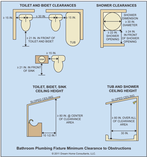

I went and looked up what your unit was supposed to look like, and jeez, that's one annoying pillar. I agree with you that the placement of the toilet would've irked me the most though. That's WAY too close to the vanity, and it's not like you can just put a toilet paper holder on the other side of toilet since there's a whole bath right there. Are they still actively working on your unit? I'd love to know what some of those other taped items are. I see some missing grout, missing handles - anything else?
I will say, it's nice that they seem to have otherwise stuck to the floor plan - did you happen to measure from wall to wall and see if the dimensions were as stated? If this is what you were excited for when you purchased it, congrats! It certainly looks like apart from the toilet, it'll be there once those taped items are addressed. I'm sure not much can be done about that pillar, as you seem to correctly assume.
standard building code shows that you need to have 15 inches between anything around the toilet to the centre of the toilet (diagram below). I wonder what the builder will do as i dont think they can move the plumbing/toilet home. I think standard toilets being 18 inches wide (the top tank), it does not look like your vanity cleared 15 inches.

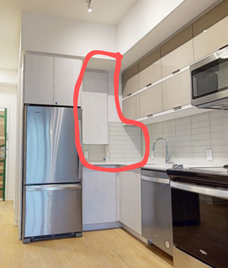

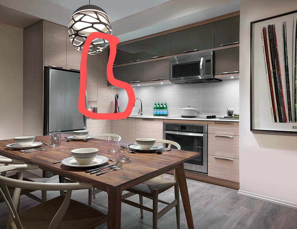

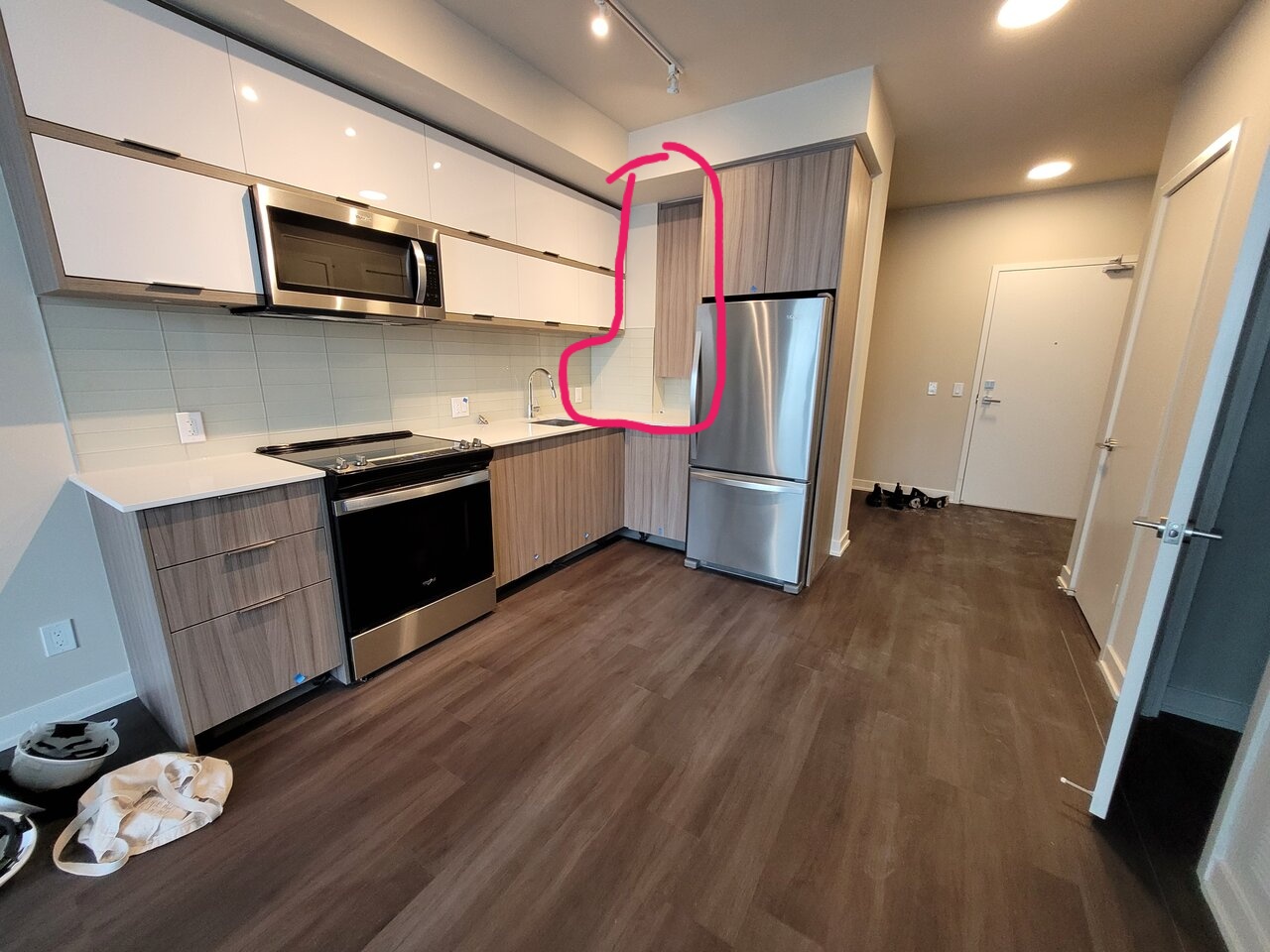

I found this really different from model suite and rendering, and what they have done to the unit bothers me alot...(it makes look very cheap).
Is it even possible to complain it during PDI?
This is from model suite I saw back in 2016 https://theravine.ca/suite.php (it has same color and texture as cabinets on the left, looking like it's integrated with surroundings and looks more luxurious)
This is what they have done to the unit based on other units pic (doesn't looks integrated with surroundings as there are tiles, cabinet and white wall. Looks cheap to me):

While I'm not a big fan of what they did with that corner, even the render looked like that section of the wall was wasted space. Regardless, I don't like that they extended the backsplash, and would rather they didn't have it there at all.
I think you can/should mention that you didn't sign off on having the backsplash there.
Ya if they won't do integrated side like model suite, then I definitely agree not having back splash on the side would've been better.
Not sure why they did it in that way... Definitely not the design by Cecconi Simone

- The toilet in the bathroom (I'm in a 1 bdrm) does not have enough clearance from the vanity, maybe 11 inches from the center of the tank to the vanity. The paper roll holder basically sits right up against the bowl so you cant put a roll on it. I'm going to be asking for a custom sized vanity so everything will fit up to code.
