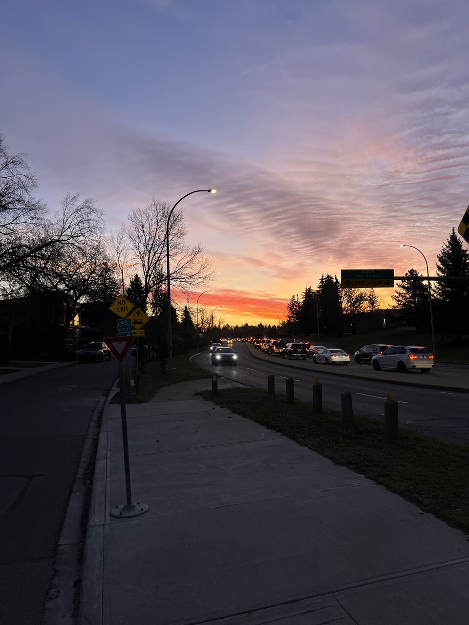

I’m not so sure about that one, 2-lane roundabouts can handle up to 50-60 thousand cars per day which works here, although is likely already near that upper limit. The real issue is 114th up to University Ave which is dependably gridlocked every single morning because of the Uni Av level crossing. If grade separation ever happens there and at 76 Av then it’d be great. I’ll add, the picture isn’t meant to show the ineffectiveness of the intersection, it’s backed up all the way from University Av and often down to Fox Drive. Was really smart to squeeze all of the SW to central traffic onto a few 4 lane roads

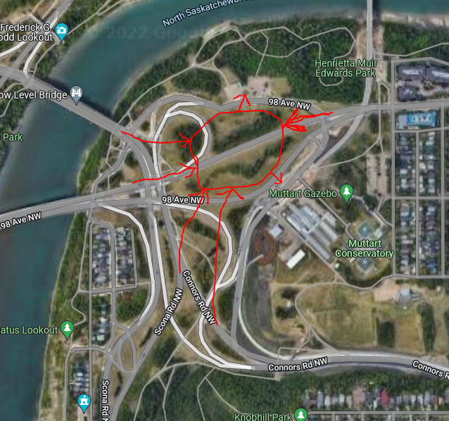

My proposed roundabout solution for 98 Ave/Scona Rd/Connors Rd

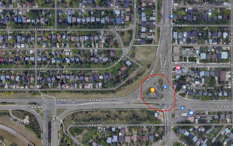

109 St/63 Ave
