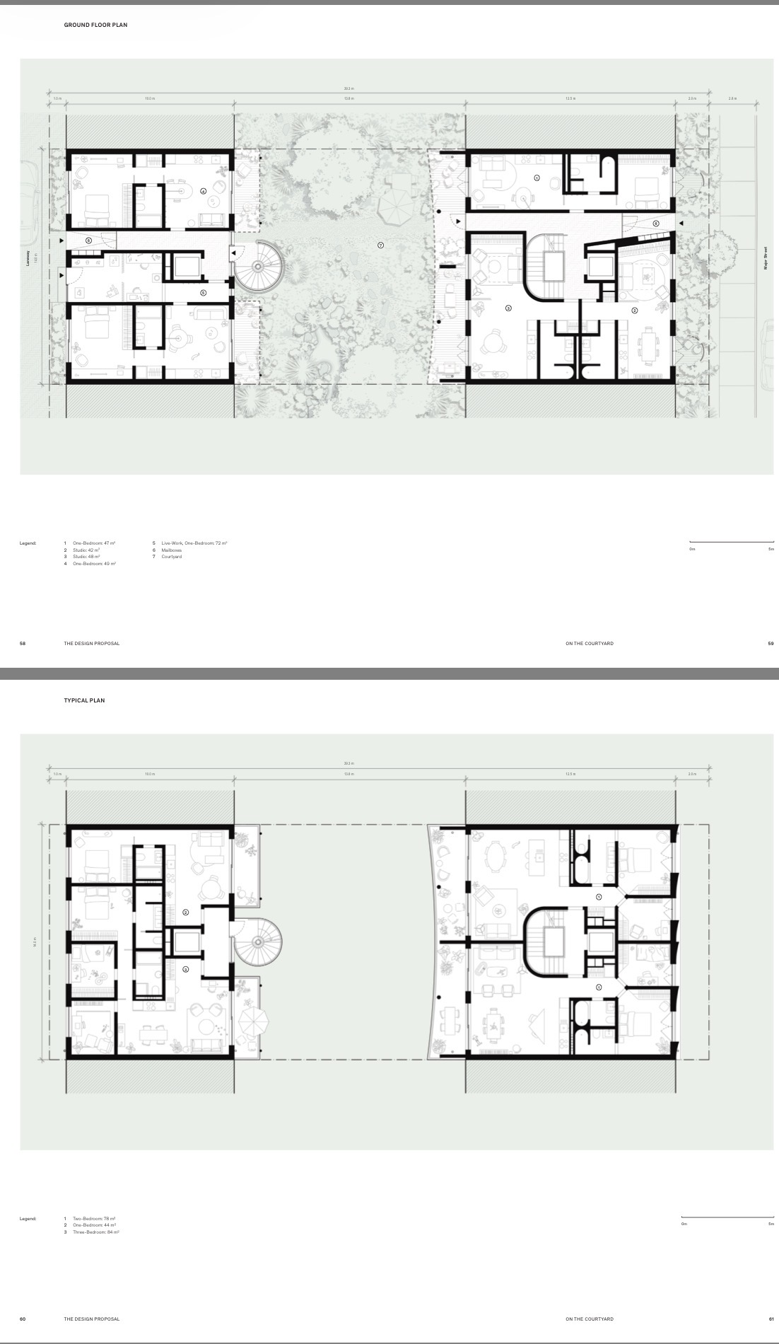

A design prototype with floor plans:
https://impossibletoronto.ca/design
Nice renders; I don't see any costing though.
I also think there is fairly close to a zero chance of an outdoor, steep, spiral staircase passing muster as the only means of egress in a winter climate. This design also counts on a single elevator, making every unit above-grade inaccessible, since when the elevator fails or is down for maintenance every person using a mobility aid would be trapped inside or outside their unit.

Conceptual layout of site, this is the S/W corner of Bathurst and Harbord:
No street trees on Bathurst, that's an immediate no.
Interior layouts: Exterior circular stair on left, interior stair on right:
Statistical assumptions:
Proposed unit sizes are unreasonably small and unlivable, and completely defeat the point of the arguments for the choice made.
All that effort to achieve 472ft2 1 bdrms and and 904ft2 3 bdrms, all with virtually no storage.

Here, we get into the probable issue with the need for wider stairs:
The assumptions on how waste would be handled are a complete fiction. Don't get me wrong, the underlying ideas, borrowed from Basel work well there, but they aren't in place here, and I don't foresee that changing.
It would be a complete overhaul of everything:

This is a highly detailed and well-informed proposal that generates an urbanism superior in every way to what we have now.
It isn't approvable, and it won't be.
Its a fantasy.
Just like anything drawn by Partisans, and so far, most things drawn by Gabriel Fain (whose work I like, for the record, but whose clients use him to get zoning and then dump him when they go to build, throwing his designs out in the process).
I like the pretty renders as much as anyone else, but between being un-approvable, and un-buildable, they would provide crappy places to live in terms of unit size and layout.
I'm all for aspiring to be better urbanity can we focus a bit more on the achievable; while also hopefully delivering housing that's more affordable?
