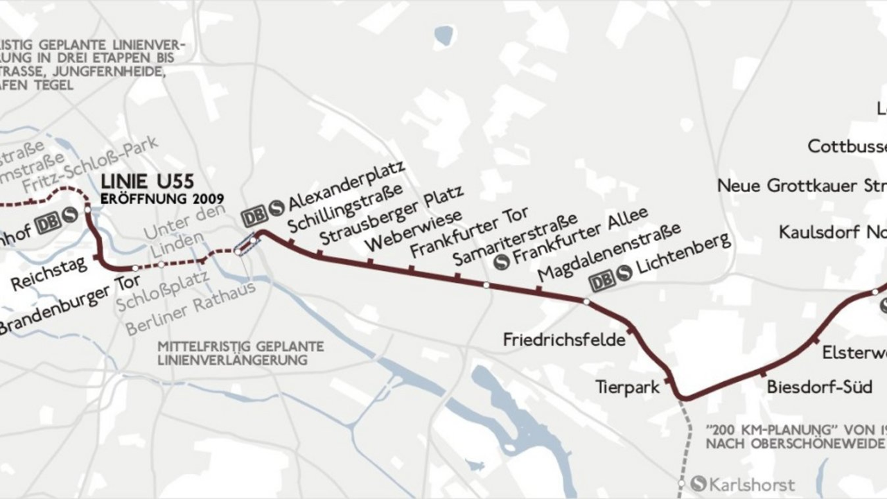

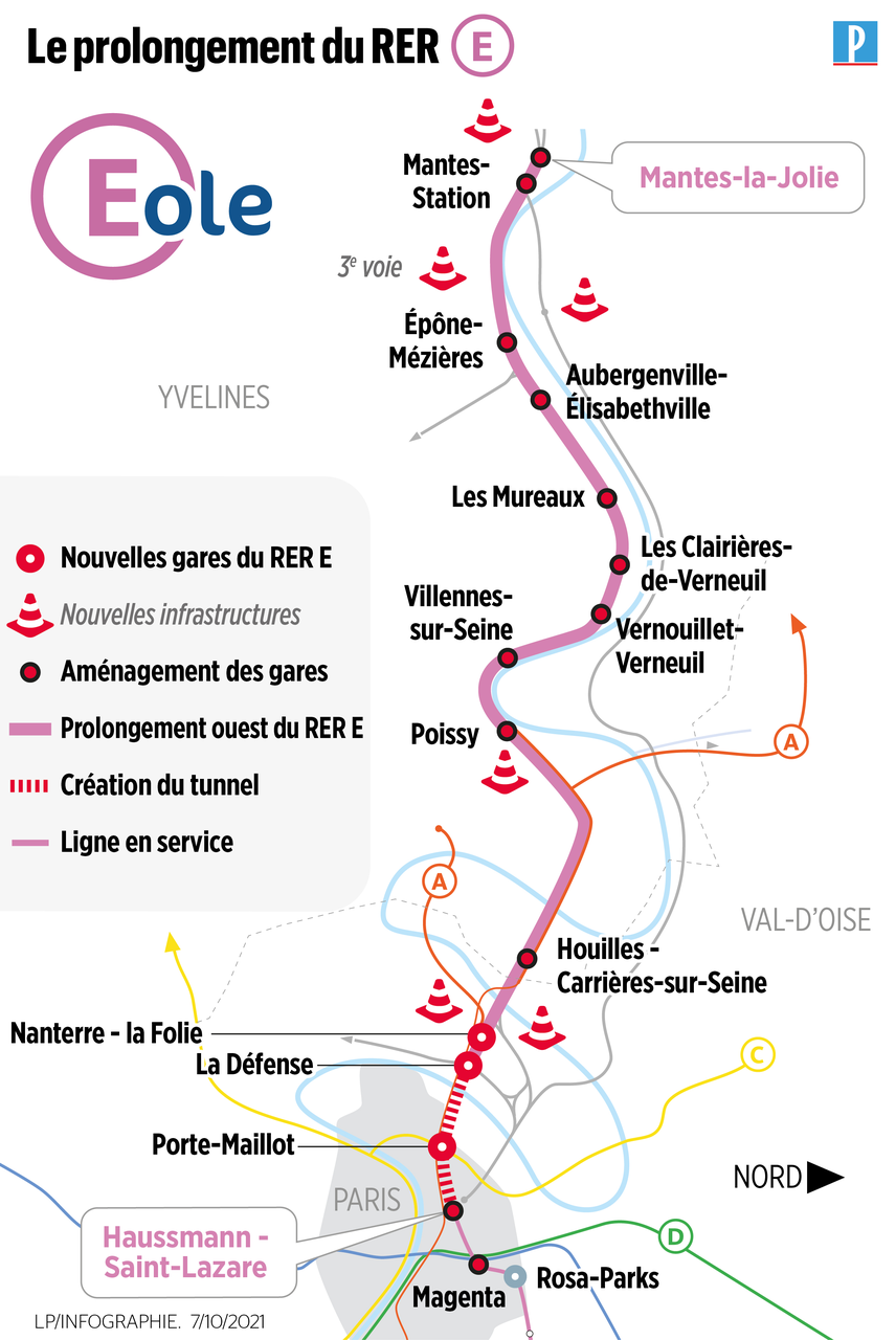

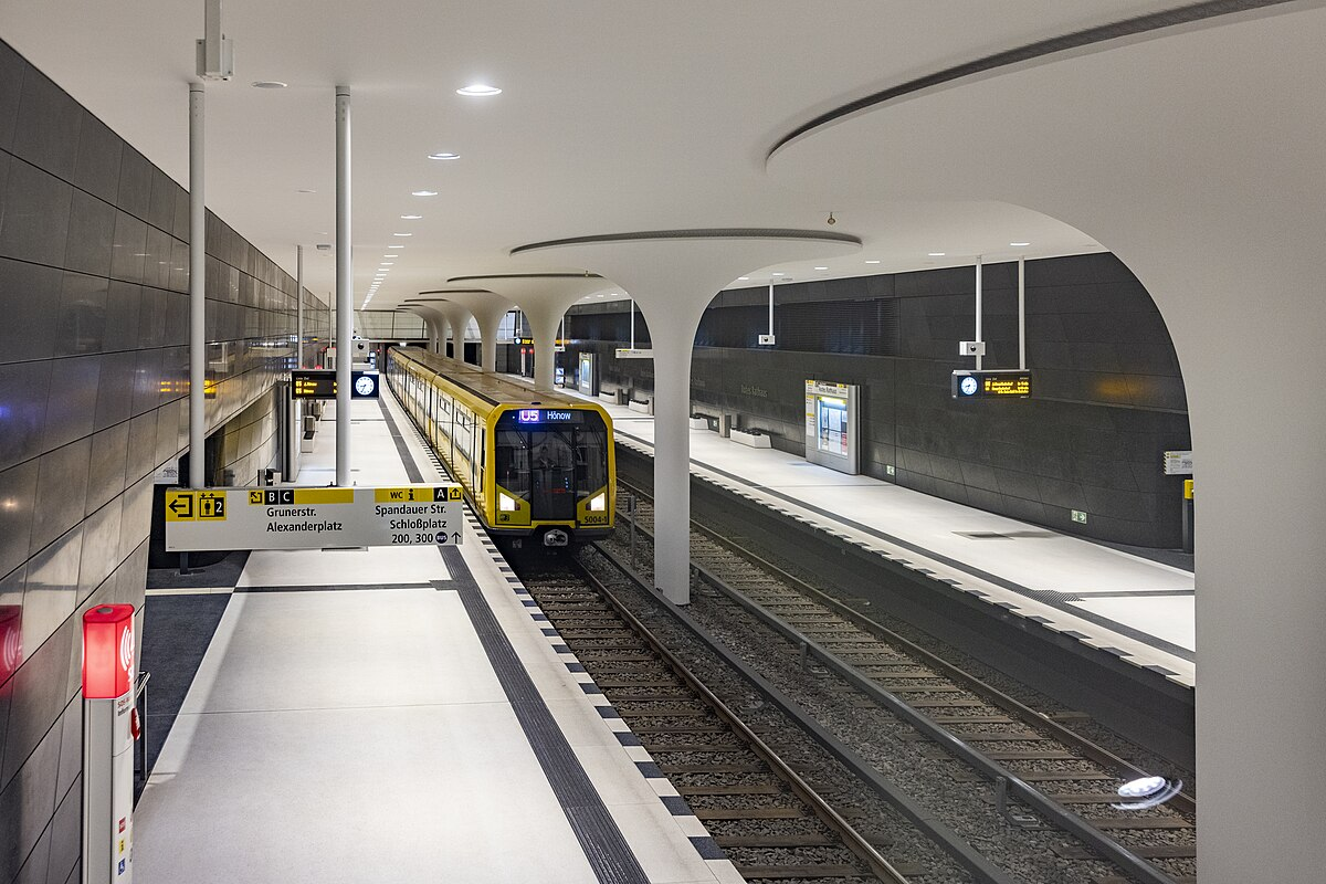

This is in comparison to downtown European projects, such as Berlin's U5 from Alexanderplatz, which cost maybe $400 million/km (CAD); Paris's RER E to La Défense, which was a similar amount; Milan's Line 4, for $200 million/km; Barcelona's L9/10, a little over $220 million/km; even Amsterdam's Noord-Zuid Subway, built in the Dutch soil and taking 14 years, cost maybe $700 million/km.
