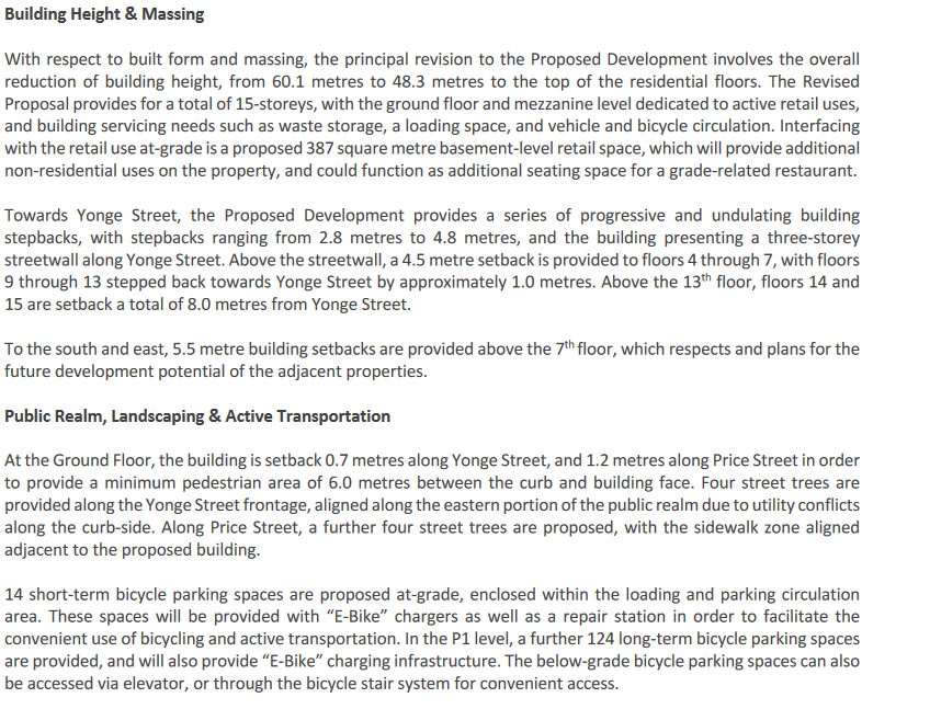

From the Cover Letter:

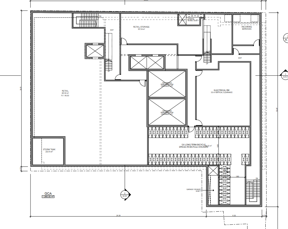

Retail on P1:

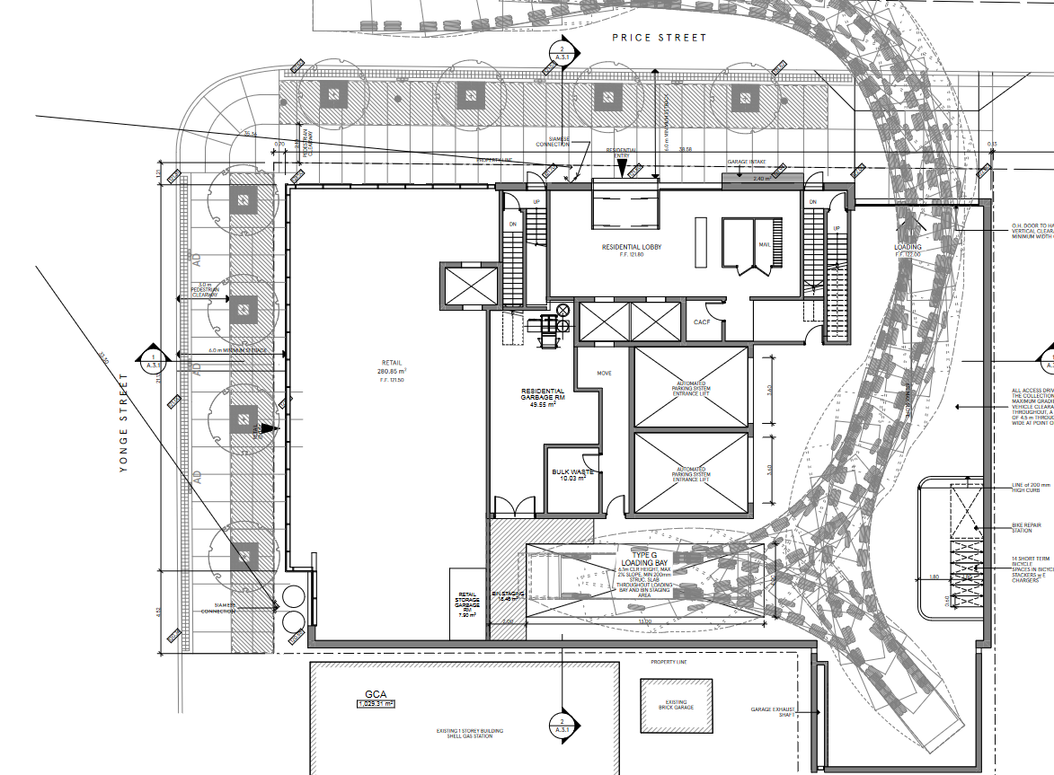

Ground Floor Plan:

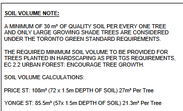

Forestry will have a fit when they see the soil volume calculations for the trees. That will have to change!
at 21m2 of soil per tree, they'll all be dead in 5 years.
Retail on P1:
Ground Floor Plan:
