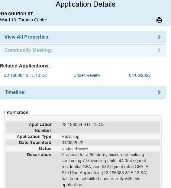

@AlbertC 's discovery now has a formal application in the AIC:
The complete list of properties assembled is thus:

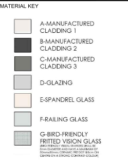

Material Board:

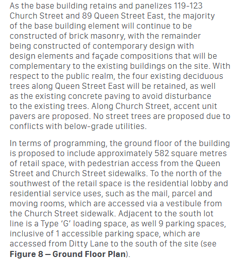

Planning Report:

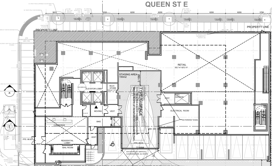

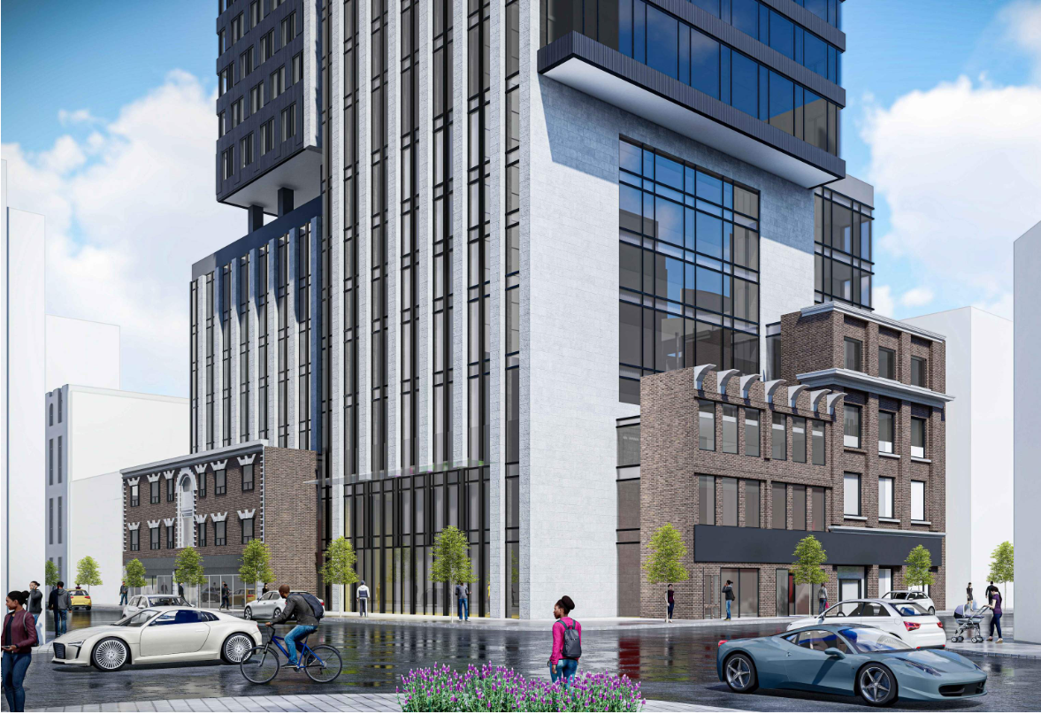

Comments: Podium is a miss, needs a re-think. The way the new meets the old does not work for me. The zero residential parking is great, but the incorporation of visitor parking, and loading at-grade and other choices serve to make the lobby far too prominent in this location.
Tower: Too busy, has potential, but needs less going on.....
Heritage: More retention (deeper) on the buildings being retained would desirable, even if only an elevation/facade. South elevation should be preserved or re-built. Treatment of retained facades is off.
Landscape Plan: No new trees, no enhancement to planting conditions of any existing trees, unacceptable.

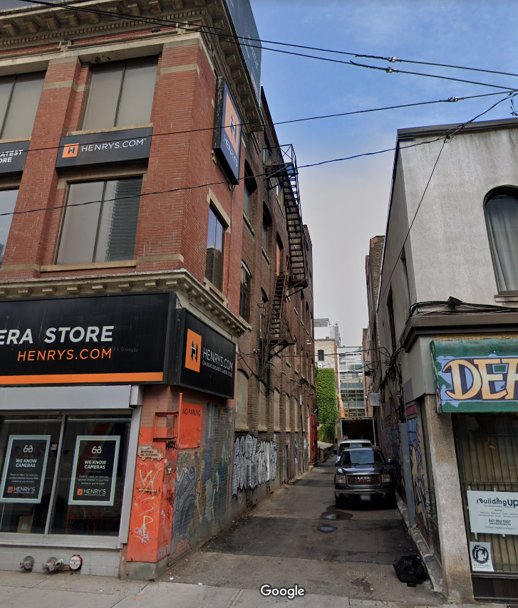

Missed opportunity:
This laneway space could be made so interesting........old school Toronto brick surface, ivy growing, old-school lighting and/or uplighting of architectural features.

Four elevators for 700 units? Good luck with that.
Sometimes retaining heritage facades seems to really impede the internal layout of developments. I'm not sure if that's the case here, but considering it's a small site, that extra setback must have some impact.
