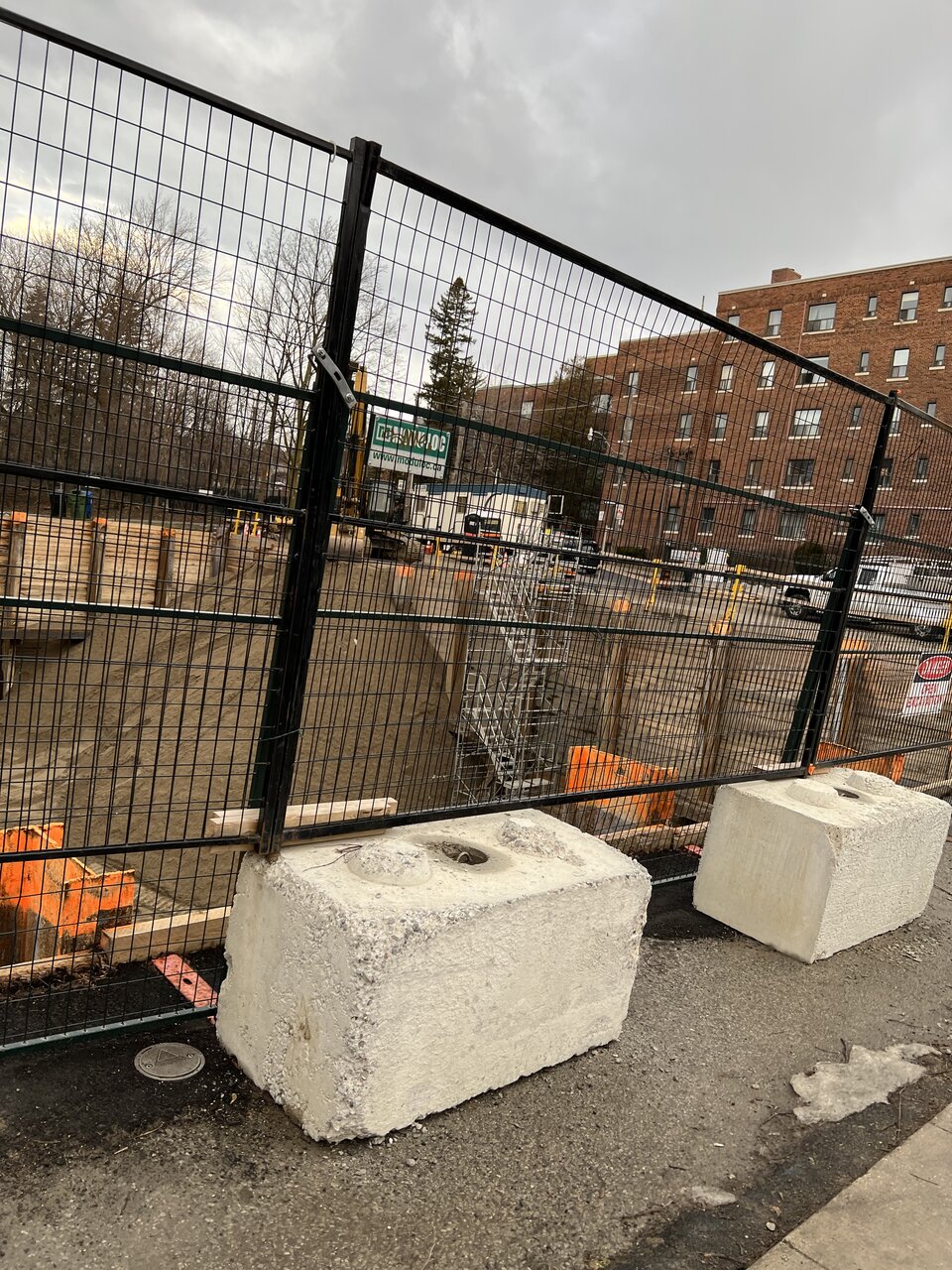

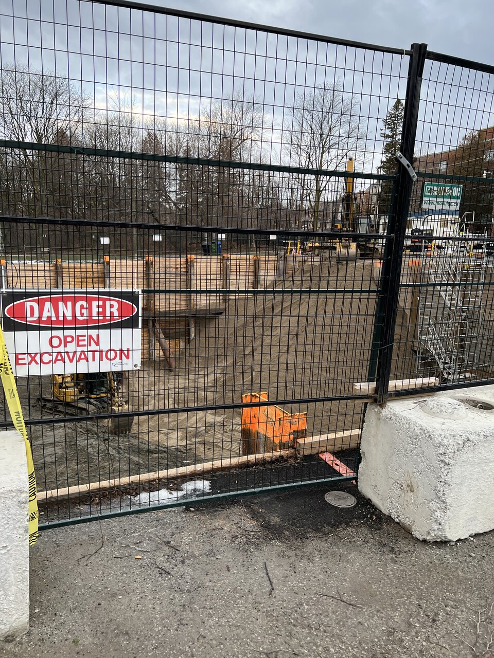

I wonder if they back filled to put the project on hold. They have not marketed it at all, and their website shows it as a future development.
That's possible. While we have it listed as a condo, it's possible that it was rethought as a rental (and we may have missed that), and then work started for it as a rental (so no marketing)… but It's a challenging time for financing these days, and it may have been rethought yet again. All purely speculation on my part.

There are no City permits even applied for, for this site.
That almost certainly indicates the work here was entirely related to remediation, which is not a City permit.
