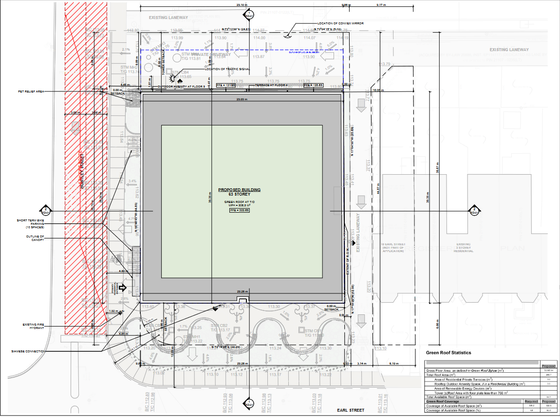

Site Plan:

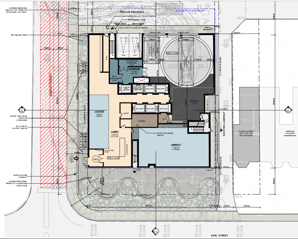

Ground Floor Plan:

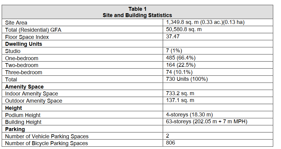

Statistical Summary:

- Elevator Ratio: 6 elevators to 730 units, 0.82 elevators per 100 units or 121.66 units per elevator.

- Setbacks that are a bit problematic (offset to the east by an LDA, but not to the north, and there's some issue w/the western frontage.)

- Floor Plate size is above guideline (887.6 M2 per the Planning Report)
