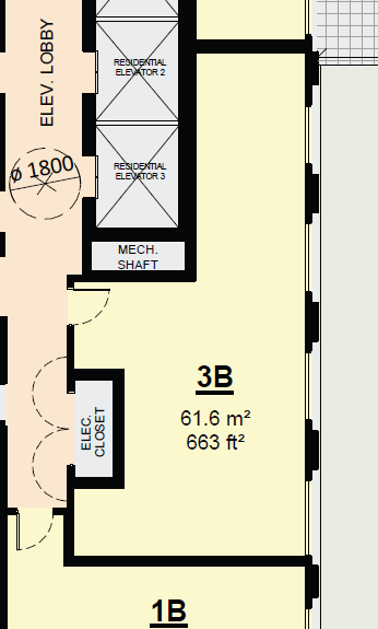

I wouldn't read into this as anything more than it is - a mislabeling of the unit type.
Using OBC floor area minimums, you cannot achieve a 3B in 663 sq ft.
A lot of developers are pushing for 610-620 sq ft 2B units in Toronto these days and it's not really workable. 650, yes. Below that is not ideal.
Fun fact, that size is perfectly doable in a tiny-home. I get to 562sqft not including closets or mechanical.
