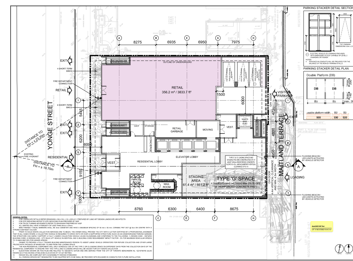

I've been looking over the Ground Floor Plan:
It's 50% non-retail; with an oversized lobby entrance and too many staircases that will be blank walls at street level. I see how they got there, you've got loading zones and parking clogging up room to the bring the stairs down at the rear.
But they're wrong, the layout can and should be shuffled. 2 sets of stairs can come down at the rear and still accommodate what's required.
They'll love me for this, but they need to shift the elevator core and its orientation in my opinion. They could just pull it forward a bit, if they shuffle the mail room and a couple of other functions up/down one level; though my preference is go to 3 elevators on each side of a E-W orientation here, which would require reorganizing every single floor plate in the proposed building. They're welcome. LOL
The lobby entrance needs to shrink dramatically..
I want retail with a minimum of 75% coverage on Yonge and would prefer something closer to 90%
