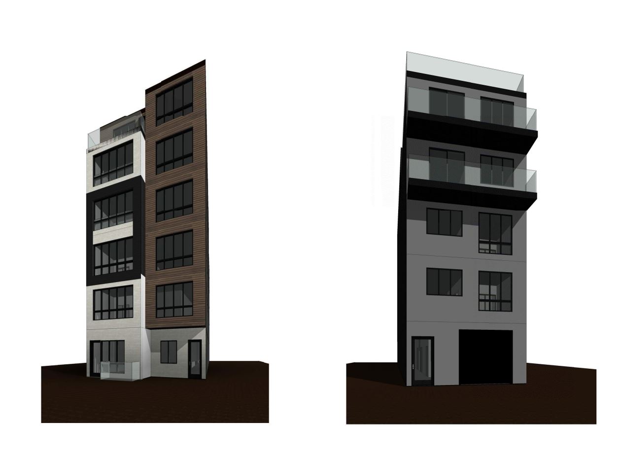

To construct a new six-storey semi-detached apartment building (containing ten dwelling units) with a ground floor rear integral garage accessed from the abutting laneway (for one parking space), a front basement window well, a front sixth storey balcony, rear fourth and fifth storey balconies, and a rear sixth storey rooftop terrace (green roof outdoor amenity area). The north portion of the front of the building will be cantilevered over the ground floor front entry.
I vote no.
Accessibility, I simply don't want to see buildings built with 1 elevator. Aside from breakdowns, and maintenance these do need to comprehensively refurbished every 20 years and replaced every 40. During such a period, the people on the sixth floor would have no elevator for up to six months.
On top of which even if an elevator is down for a day, you could trap someone with a mobility aid.
The proposal as conceived should be illegal.,
That to one side, its ugly beyond words.
If the locals want to NIMBY this one, I just might whisper to them how to blow it out of the water. I could see a Human Right complaint, a divisional court charter challenge........... I really think we need to nix dumb ideas like this completely. They are toxic in their disregard for the elderly and the disabled and the sheer ugliness is just giving the finger to the neighbours.
