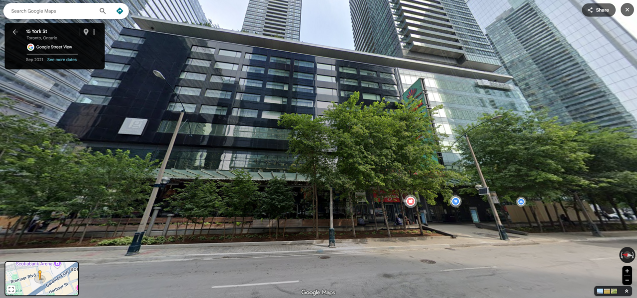

Really hope that the larger and deeper beds here provide for an outcome similar to Maple Leaf Square where the trees, and the resulting urban experience, are second to none:
How is it one of their flagship projects? The unit finishes are entry level compared to Kings Landing.
Here's hoping. That kind of treed buffer is absolutely excellent at buffering the traffic sewer that is York St next to the Gardiner - it would be useful on Spadina as well which is even busier.
