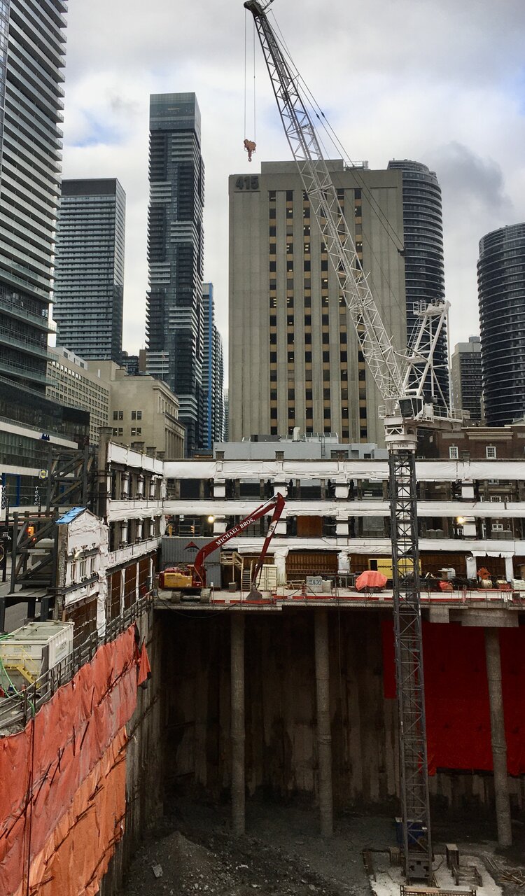

February 23; 2023. After observing 4 meters extra excavation at Concord Sky, My Prediction Concord Sky planning to go over 100 floors, probably 102 floor.. I know how could I say this, well time will tell.View attachment 458249View attachment 458250
They can't go any higher due to shadowing, so only that many floors if they chop the floor to floor height, which I believe they already went to the min. 2.95m

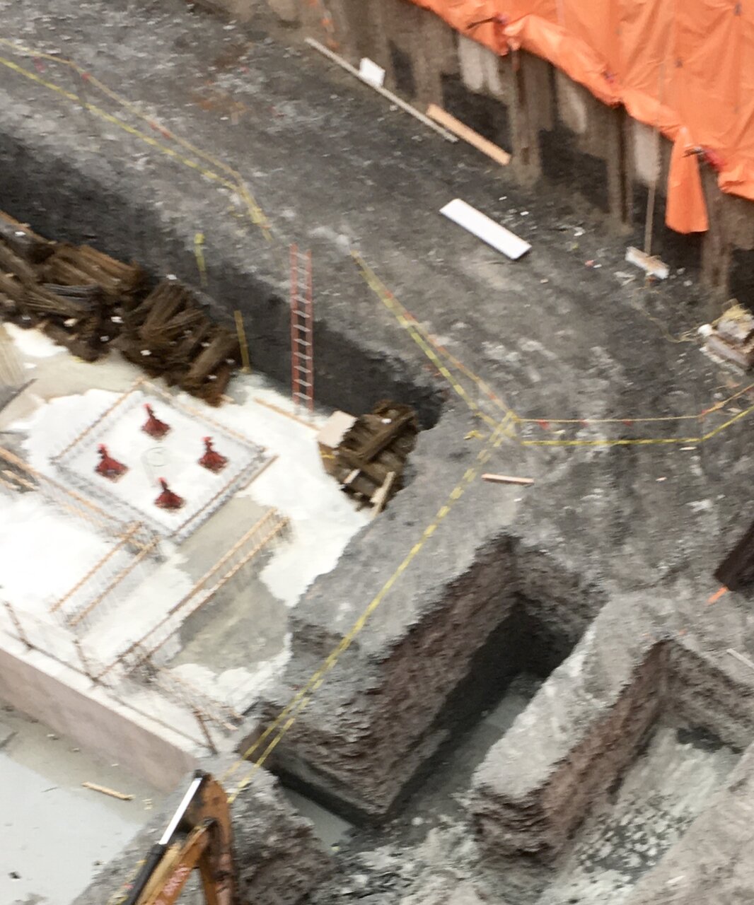

You are looking at the 2.6m deep raft slab excavation (as well as the Footings below some of the other walls) that is below the Main Elevator Core that will service above ground floor up the the Mechanical floors.
These footings (engineers went with local footings under the walls/columns vs the full building being a Raft or Mat slab) will "disappear" below the Level B05 Slab on Grade once it gets poured.
Current set of drawings still has the building at 299m above grade.
