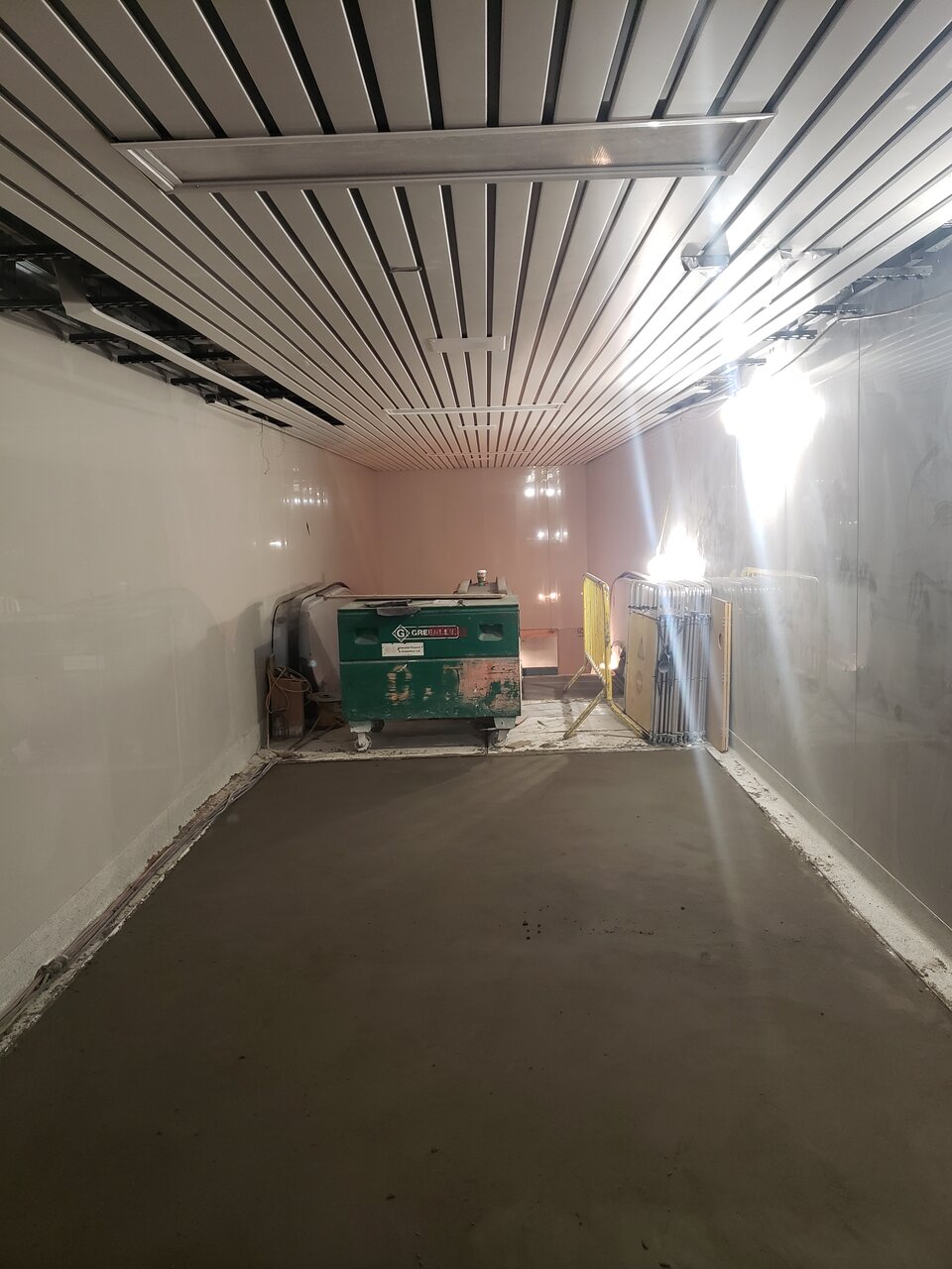

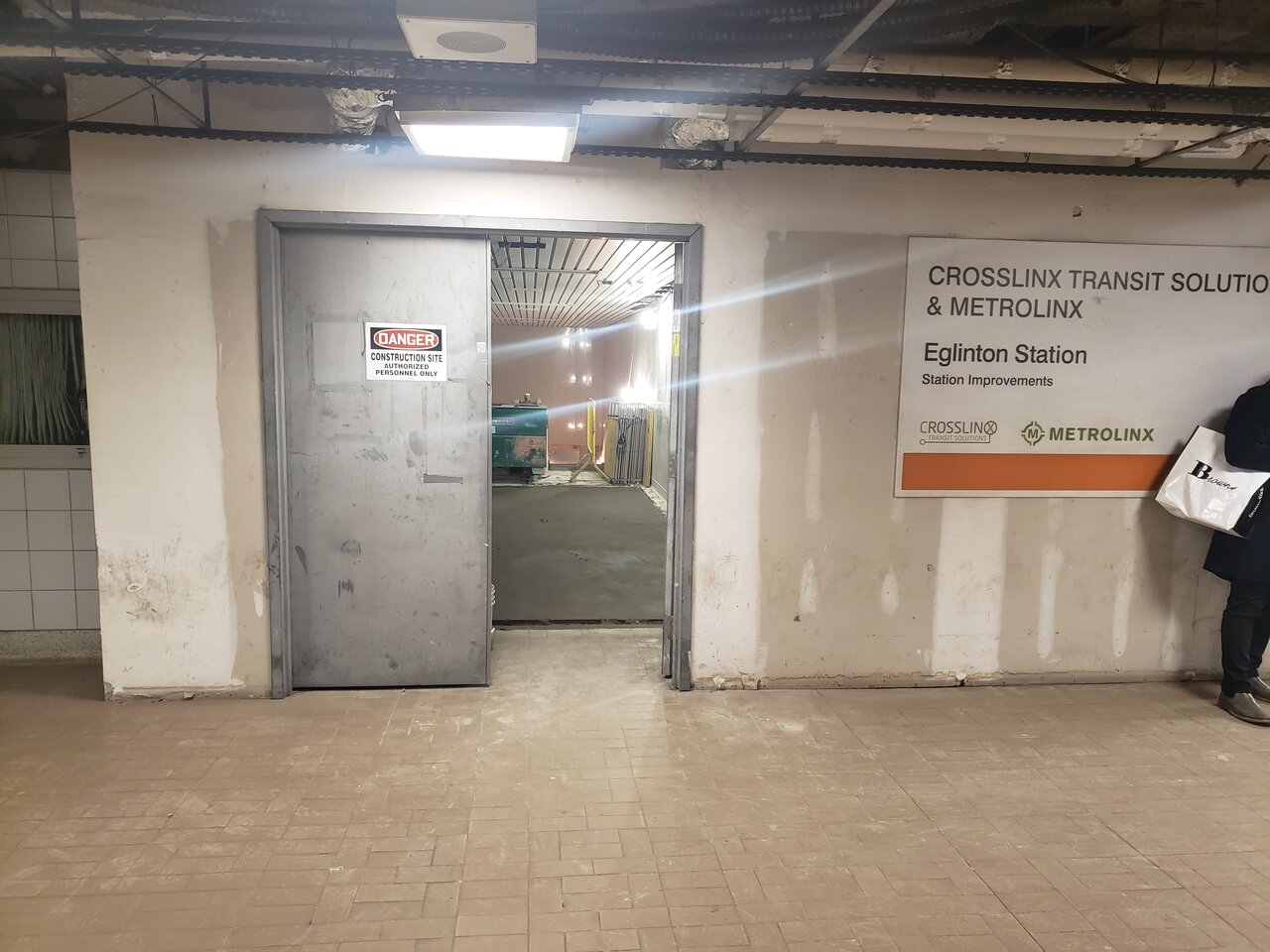

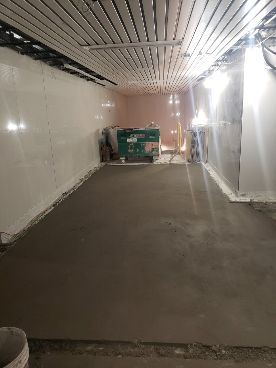

This is not much, but I managed to get these photo on Dec 29th.

That doorway you are looking through is the north wall of the existing Yonge line station box?

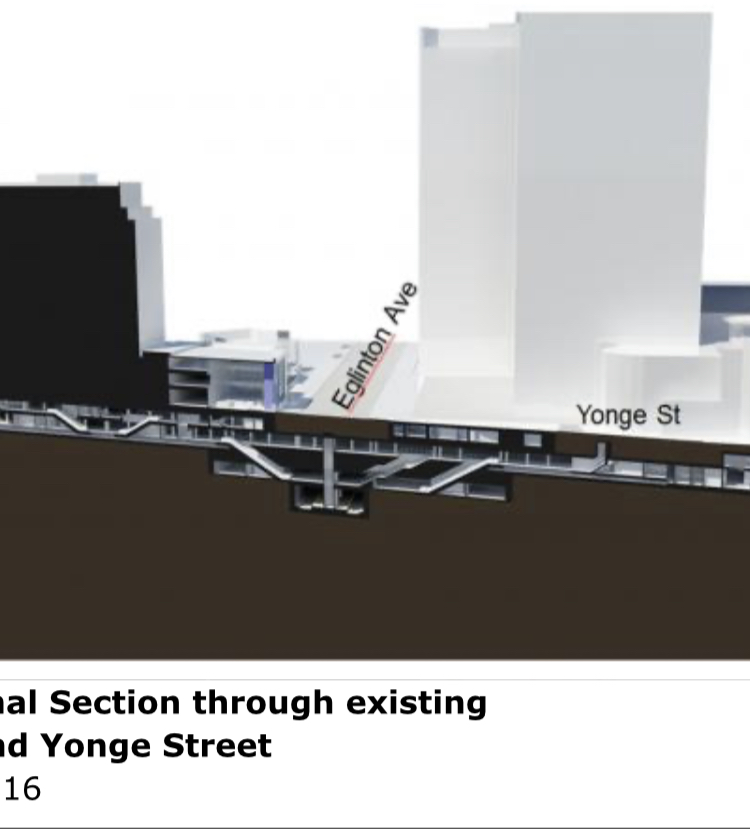

Edit. Adding the rendering released by ML way back when… looking SE through Yonge and Eg intersection. If they don’t shift the yonge platform north it looks like half the vert circulation goes “poof”. How typical for Toronto. I hope this isnt true.

Firstly, thanks to Urban Chairman for the photos. We still haven't heard Urban Chairman's response to tnarduzzi's question above confirming that this is at PLATFORM level. Let me throw something into the mix in the meantime.
Perhaps these photos are not of (the north end of) the subway platform but instead are one level above. Crosslinx are replacing one of the existing escalators to the line 1 platform with an escalator running the opposite way. (It goes up to the north replacing the one going up to the south). Maybe this is looking south at the existing level above the line 1 subway platform at the new escalator going down to the platform. If that is the case, directly behind the camera would be the existing (and unchanged) stairs going down north to the subway platform.

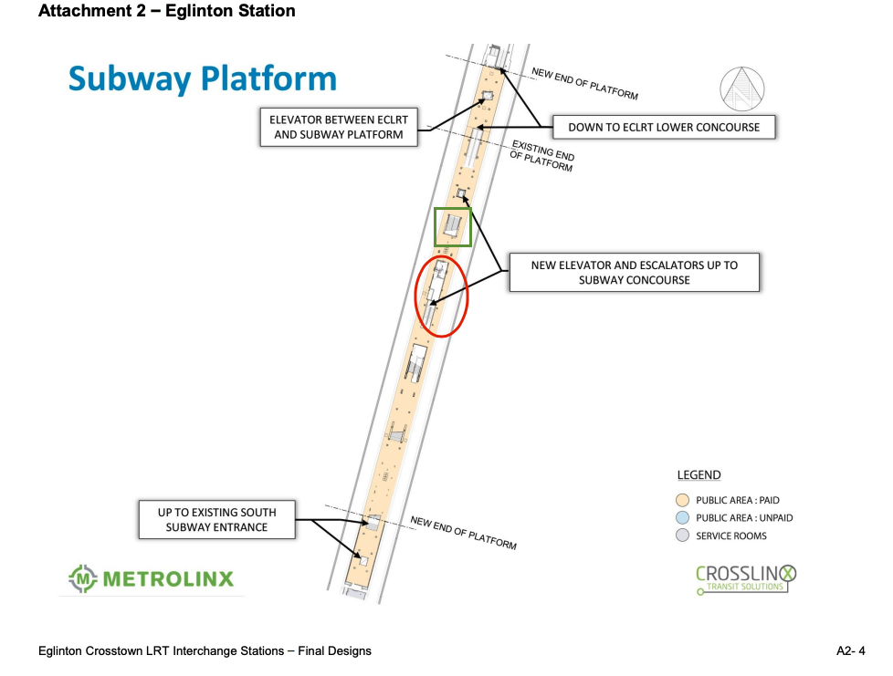

My comments are based on assumption that Urban Chairman’s photos are on platform level looking north at the new escalator I circled in this render. If that IS the case then I maintain the platform isnt moving. If not then I totally agree and must admit all bets are off.

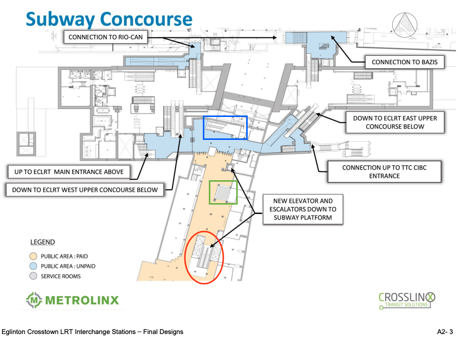

I commute through Eglinton Station every day and know where this is. Urban Chairman's photos are not at platform level. This photo is from the mezzanine level above (i.e. Cinnabon level). You'll see this construction fascade when you come up the staircase at the northern-most end of the current platform.
Here's what that looks in the final design for Eglinton. The render that everyone is referring to is out of date. Frustrating that Metrolinx keeps it on their website, it's not accurate. Here are the final designs:
The existing north staircase is in the green square. Urban Chairman's photos are of the future escalator in the red circle, planned from the Cinnabon level down to Line 1 platform level. If it helps, the blue square is the escalator up from the mezzanine to the (former) BMO at street level, at the intersection of Yonge and Eglinton.

Here's what that looks like from Line 1's platform. Again, green square is the existing north-side staircase. Urban Chairman's photos are of the future escalator in the red circle. The future Line 1 platform will be extended north, but by less than originally planned. Per the final design doc:
"The preliminary concepts approved by the TTC Board in 2013 included a possible 70- metre extension of the subway platform to the north, to improve customer transfer distribution. The final design reduces the platform extension to approximately 24 metres. Although this platform extension will result in a shift of the train position to the north, access to the existing elevator and stairs to the south entrance will be maintained."
