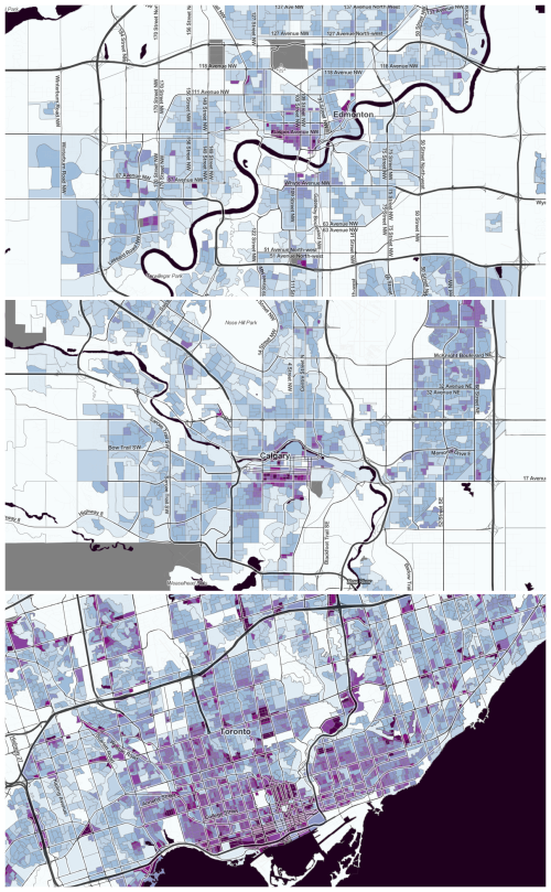

No I mean the suburban stretches of Eglinton. With population densities rivalling those of downtown Edmonton and Calgary - the very places you say tram LRT makes sense.
data from CensusMapper.ca

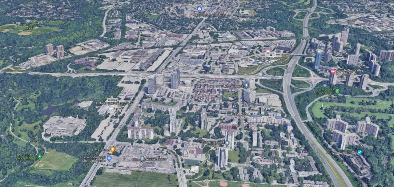

That's population densities, however that doesn't take into account things like office and commercial buildings. The map above shows that this:
has the same density as this:
Even looking at the satellite view you can see a massive difference:

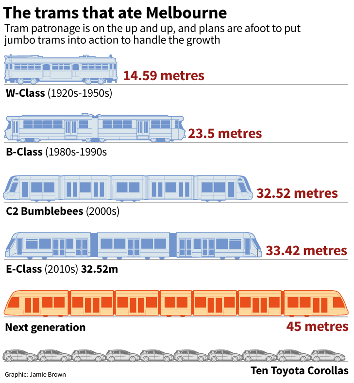

What's the bug deal with that? The space won't make or break having sufficient capacity, and I don't think the dead space is as much as it appears to be.
Not now it wont, but let's revisit that thought in 20-30 years. The deadspace is much more significant compared to the dead space we have between subway cars (T1s).

I think he means with conventional light metro vehicles, not what we're getting now with all the dead space gapped LRVs.
Old heavy metro vehicles had couplers and usually dissuaded passengers from trying to go between cars. We are spoiled with the open ended cars you can walk through from one end of the train to the other.

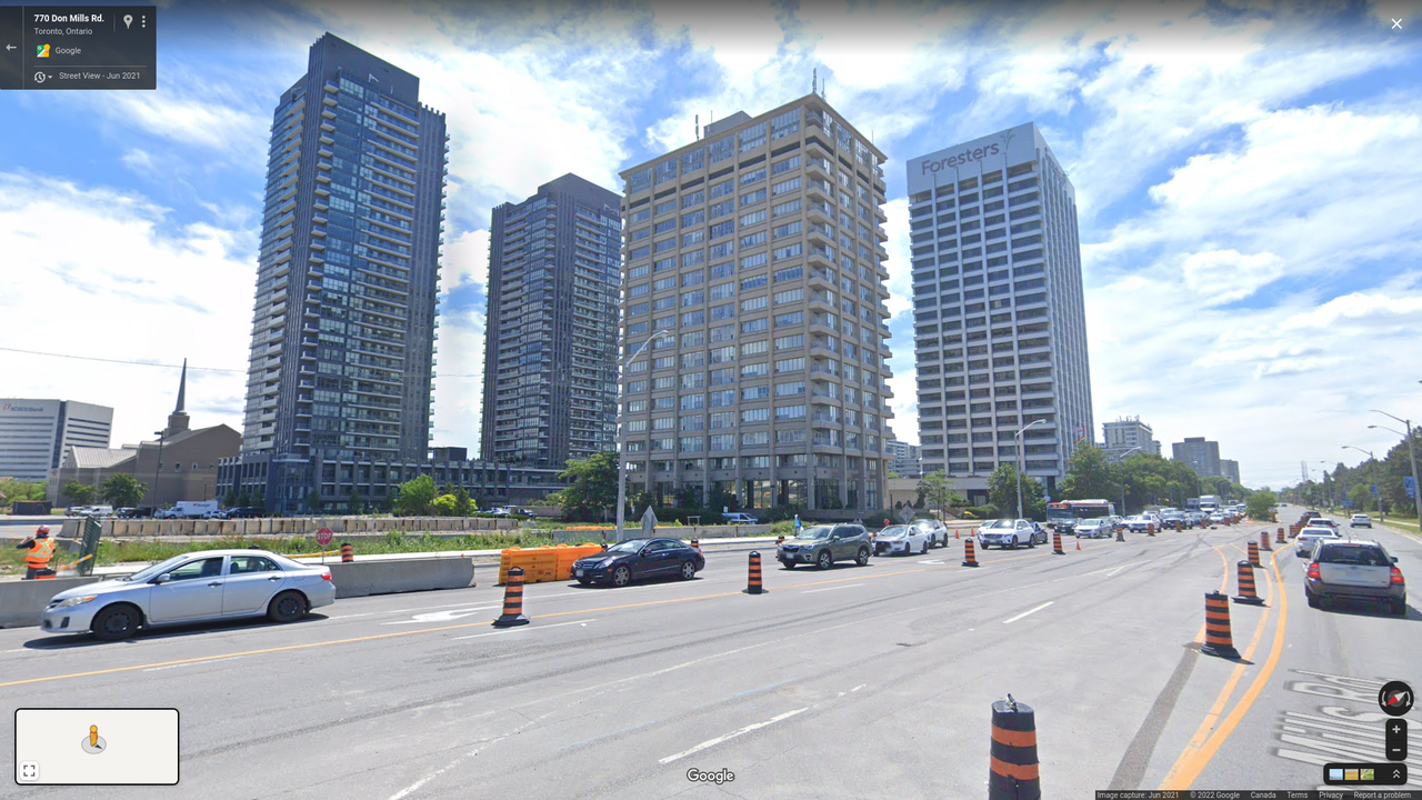

You do realize in 10 years Don Mills and Eglinton intersection will have an additional 30 condos/mixed used buildings there if not more lol?

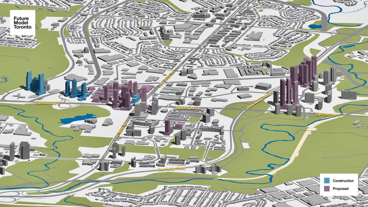

Here's a rendering of the proposed projects in the Golden Mile:

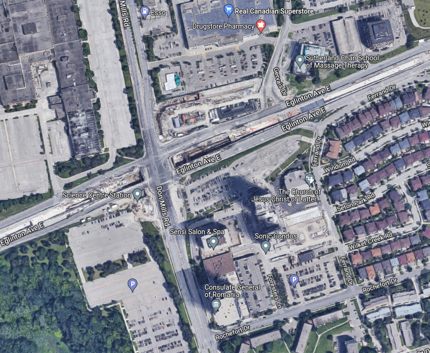

Here is what the area currently looks like:
Also, Don Mills and Eglinton area below:
Which currently looks like this:
So if density is what you're looking for, then it'll be there in the next 10 years. It might not be as vibrant as the Calgary downtown you're describing, but also, you need to compare apples to apples. Downtown Calgary needs to be compared with Downtown Toronto, or in the case, Yonge and Eglinton area. And Yonge and Eglinton area has a lot more density and ridership than Cargary downtown. If we were to compare suburban Calgary with The Golden Mile stretch of Eglinton, then again, with the in-work projects along Eglinton, it'll be miles ahead in a matter of 5-10 years.
And my question still stands, what do you propose is a better system than LRT in this section? It is expected to see a pphpd of 8,000, which is too high for buses to handle, and too low for subways to be feasible. LRT is the ideal mode to deal with this capacity requirement while also future proofing for the medium term.
