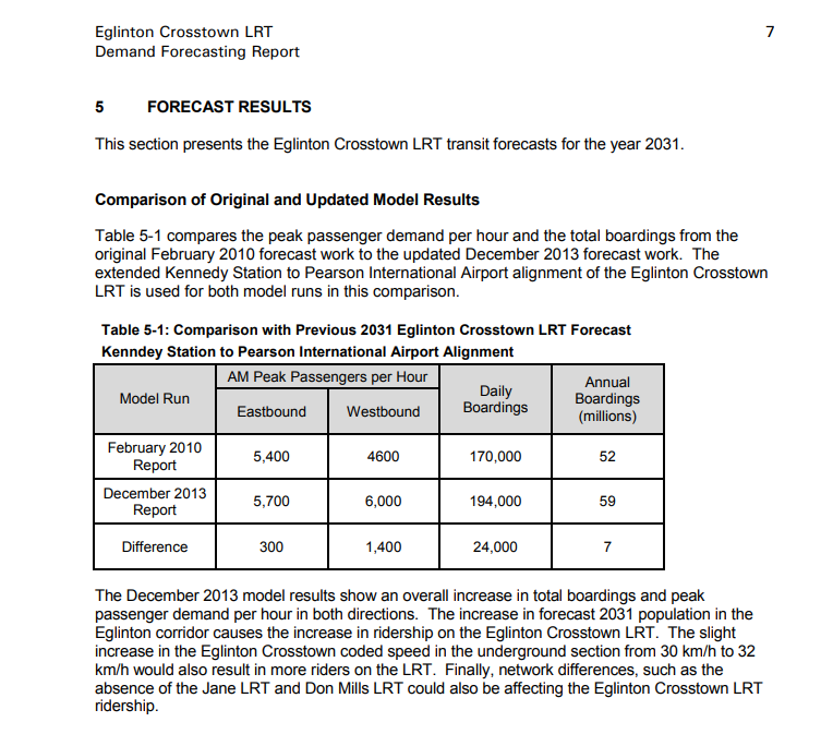

Where is your source on 20k pphpd?
Here is my source of 6,000 pphpd along Eglinton: Eglinton Crosstown LRT Demand Forecasting Report
From going through the document in more detail, it furthers my support of removing the Hakimi-Lebovic stop as well as the Aga Khan stop because of the low patronage.

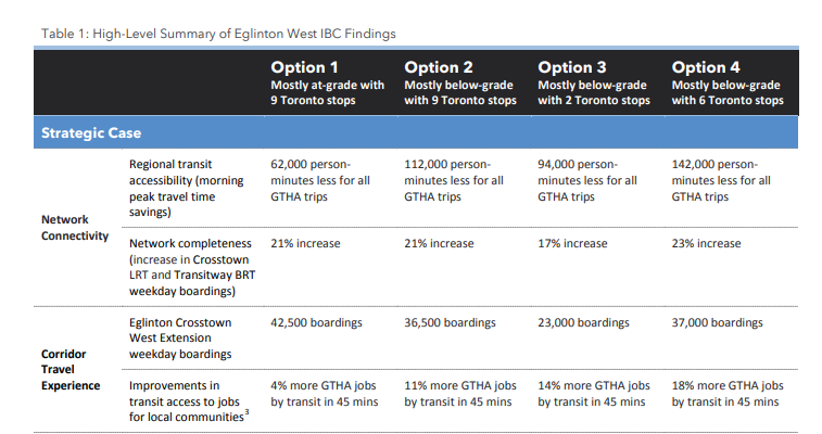

For a perfect example, the Eglinton West portion, the ridership dropped from 42,500 to 37,000 when it went from at-grade LRT with 9 stops to underground LRT with 6 stations. If there is major requirement for a fast connection across Eglinton, then ridership should've gone up when comparing at-grade LRT vs underground with fewer stops. The same might've been the case for Eglinton East as well. You can read more about this here: Eglinton Crosstown West Extension Initial Business Case

Already provided information that an at-grade proposal on the western side had higher demand and ridership than a fully grade separated line. 42,500 for at-grade vs 37,000 for grade separated.
