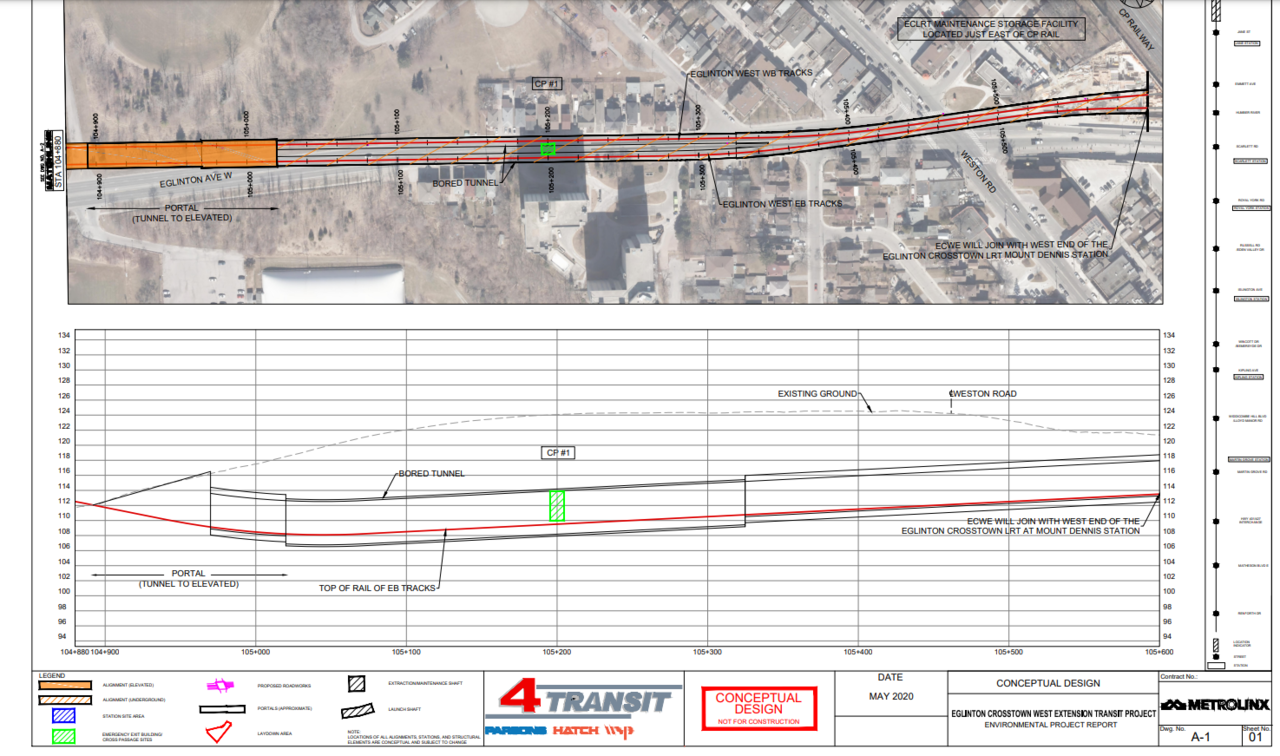

That's fair enough. I think it's safe to say this tunnel will be built in a cut-and-cover method. Though, from the Design Plates in the Environmental Assessment, it calls 300 metres of this section as a "Bored Tunnel". Please help! My brain cannot comprehend!
"Bored" would imply that they are digging out the tunnel sequentially from one or both ends, as opposed to digging a trench and covering over it - the colloquial "cut-and-cover".
A TBM is one way to bore a tunnel, but by no means the only way.
Keep in mind too, that they don't have to follow the exact drawings as presented in the EA, but just to use them as a guideline. I don't know if changing from a bored tunnel to cut-and-cover would necessitate a fresh EA - others here will be able to answer that better than I.

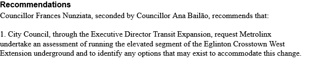

Should we also let Councilor Nunziata know about all the GO tracks that are above ground?
/s
