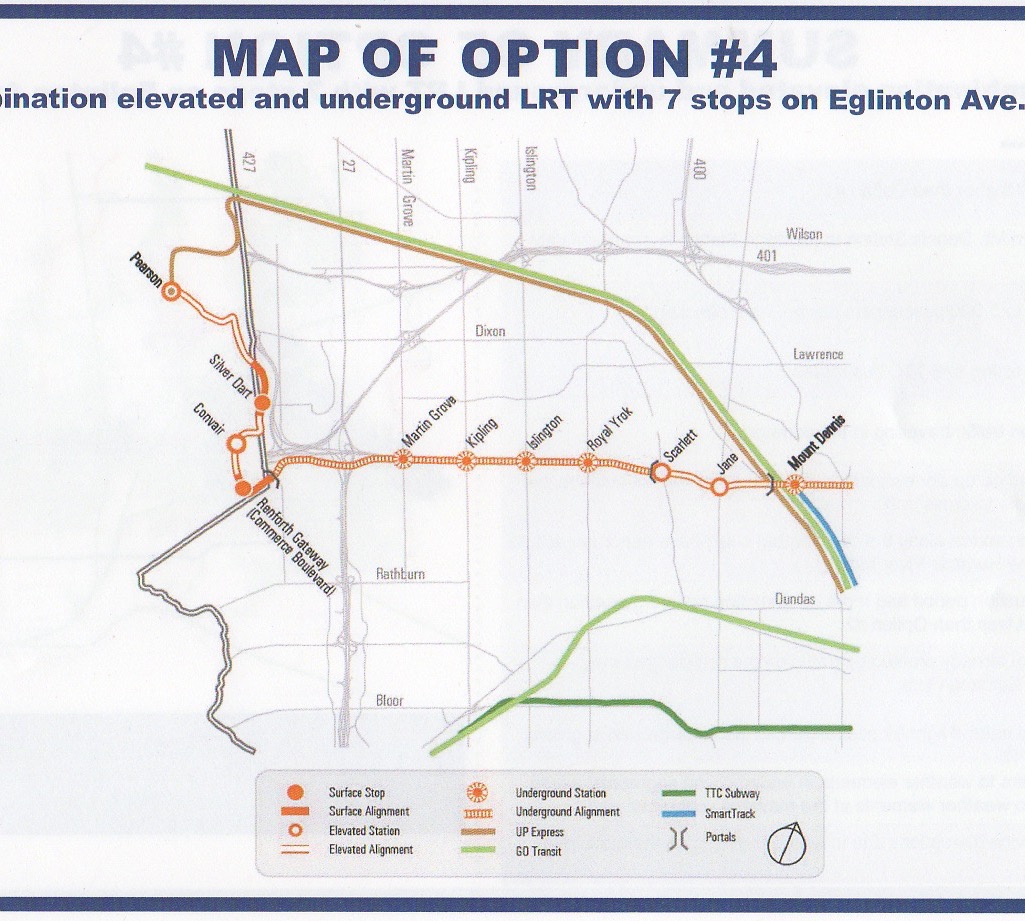

^ Mea culpa. I didn't get that exactly right. There are some differences in the Options. Option 2 is completely tunnelled, Options 3 and 4 are elevated over the Humber. Beyone Renforth, all options have the same mix of elevated and surface.

What doesnt make sense to me here is why with Option 4 the portion from Martin Grove to Renforth would have to be underground.
To me it looks like it is south of Eglinton and in a space that is able to be grade separated with underpasses etc without having to be tunneled.
I look at Option 4 and wonder why any of it needs to be underground. Why does the line suddenly have to go underground after Scarlett? The entire stretch of Eglinton from Scarlett to Martin Grove is suitable for an Elevated alignment. It just seems to me the planners just had to have an underground section for reasons beyond my comprehension. Is there some sort of mandatory underground mileage quota we don't know about? Why else would they just toss the elevated line underground in an area that doesn't need it?
Indeed it seems strange that so much tunneling is deemed necessary for all options, except Option 1.
I'd like to try something in between Option 4 and Option 1. For example: Jane to Islington elevated, Kipling and Martin Grove underground.
Or: Jane elevated, Scarlett and Royal York at grade, Islington elevated (can be done cheap due to the intersection being depressed), Kipling and Martin Grove underground.
Maybe the project team feels that if any tunneling is involved at all, then they should put the TBMs into the ground and let them dig as far as possible. Saving on the portals etc.
Anyhow, if we must choose from Options 1-4 and no more variations are allowed, then my preference is #4, the runner-up is #1.
