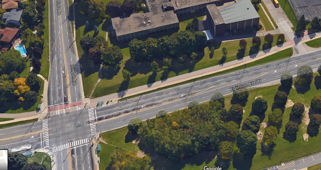

I see what you mean.
However, the top right is Richview Collegiate. TDSB might be induced to consider a redevelopment where the corner becomes a building (either residential, part of the school, or both) which includes an access to the LRT platform.
The return-to-grade issue could be dealt with by moving the rear accessway from the school further along Eglinton or else mandate right-in, right-out.

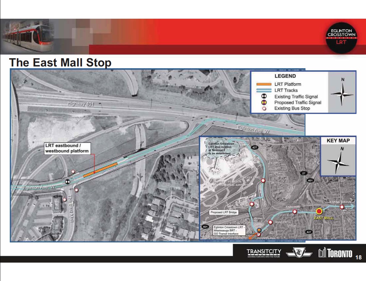

This intersection, or more accurately, intersections (plural), is the main problem with having an at grade LRT along Eglinton Avenue West.
While the East Mall stop has been removed, they still want the LRT to make turns crossing all the eastbound traffic coming off the 401, 427, and 27.

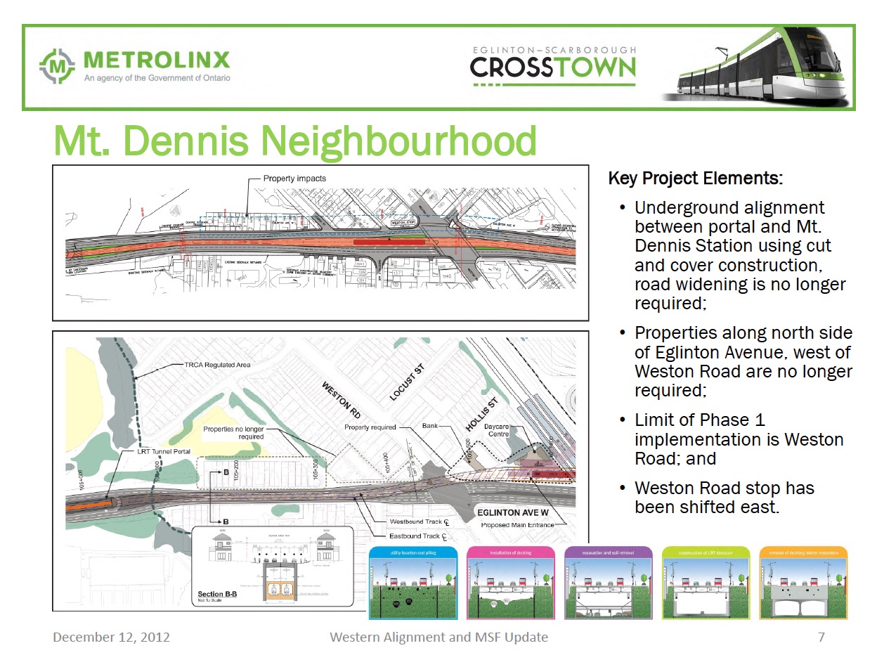

The current plans are for the LRT to emerge out of a portal on the east side of Eglinton Flats. However, the LRT would be in the middle of the Eglinton Avenue West roadway, running all the way to the 401/427/27/Eglinton intersection.
If the powers-that-be are so set on using at grade for the entire Eglinton West LRT, then they should set up the portal at Eglinton Flats to emerge on the south side of Eglinton Avenue West. Then by having the entire LRT right-of-way at grade level on the south side, by the time the trains get to Martin Grove and the 401/427/27/Eglinton intersection, they would already be on the south side. They'll avoid crossing the very, very, very busy traffic congestion by doing so.
If the right-of-way has to be in the middle as it exits the Eglinton Flats portal (east of Jane Street), it could continue down the middle until just before Islington. Since the intersection of Islington and Eglinton is below grade, the light rail right-of-way could get grade separated there and go over Islington to reach the south side of Eglinton. Then by continuing on the south side of Eglinton past Martin Grove, the right-of-way will avoid the very congested intersection between the ramps of the 401/427/27 and Eglinton.

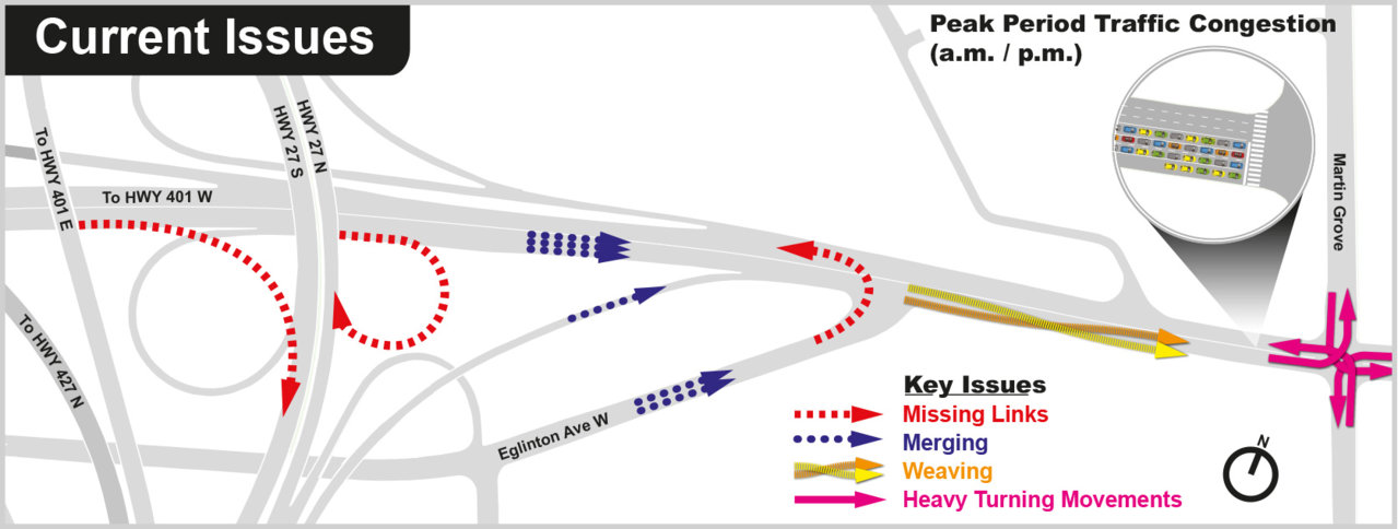

Noticed a few points from the Crosstown West "Current Work" website, at this link.
1. Martin Grove and Eglinton West anticipated report: Early 2018
2. History of the Eglinton and Martin Grove Area
  • - Early 1970s – Plans completed for the Richview Expressway – an expressway along Eglinton with an interchange at Martin Grove – with construction of high speed flyover ramps to and from Eglinton at the Highway 401/ 427 interchange.
  • - Late 1970s – Construction of the Richview Expressway was not carried forward but the interchange and highway ramps remained, feeding traffic directly onto Eglinton Avenue.
  • - 2016 - The Martin Grove intersection was identified as one of the top 10 congestion hotspots in the City – implementation of several interventions (e.g., optimized signal timing) to try to address traffic issues.
3. Current Issues
  • - Highway ramps feed onto Eglinton, resulting in high volumes of merging, weaving, turning and diverting traffic.
  • - Missing links in the road network force some highway traffic to use Martin Grove Road to reach Highway 401, and some Eglinton Avenue traffic to use Martin Grove Road to reach Highway 27.
  • - Martin Grove intersection sees two to three times more left-turns than an average intersection. (Because of the missing 401 west to 27 north link?)
4. Next Steps
Identification of design alternatives to improve traffic. These could include:
  • - A simplified, more connected road network
  • - Intersection capacity improvements
  • - New ramps
  • - Transit links
  • - Traffic management techniques
Noticed that they may have "funds" available for highway or road improvements. Just wonder if there will be the same "funds" available for the Eglinton West LRT.
Will have to wait for "Early 2018", before commenting. Will be focusing on ramps, bridges, overpasses, and/or underpasses for both the road improvements and light rail or just for roads.

This is the most problematic on the route. Based on the EA, the solution here is a eastbound-to-northbound flyover, so that left turn can be removed. Once that's fixed, this intersection will be mostly fine.
Wanting to be sure I'm understanding this correctly.... an east on Eglinton to north on 27 flyover?
