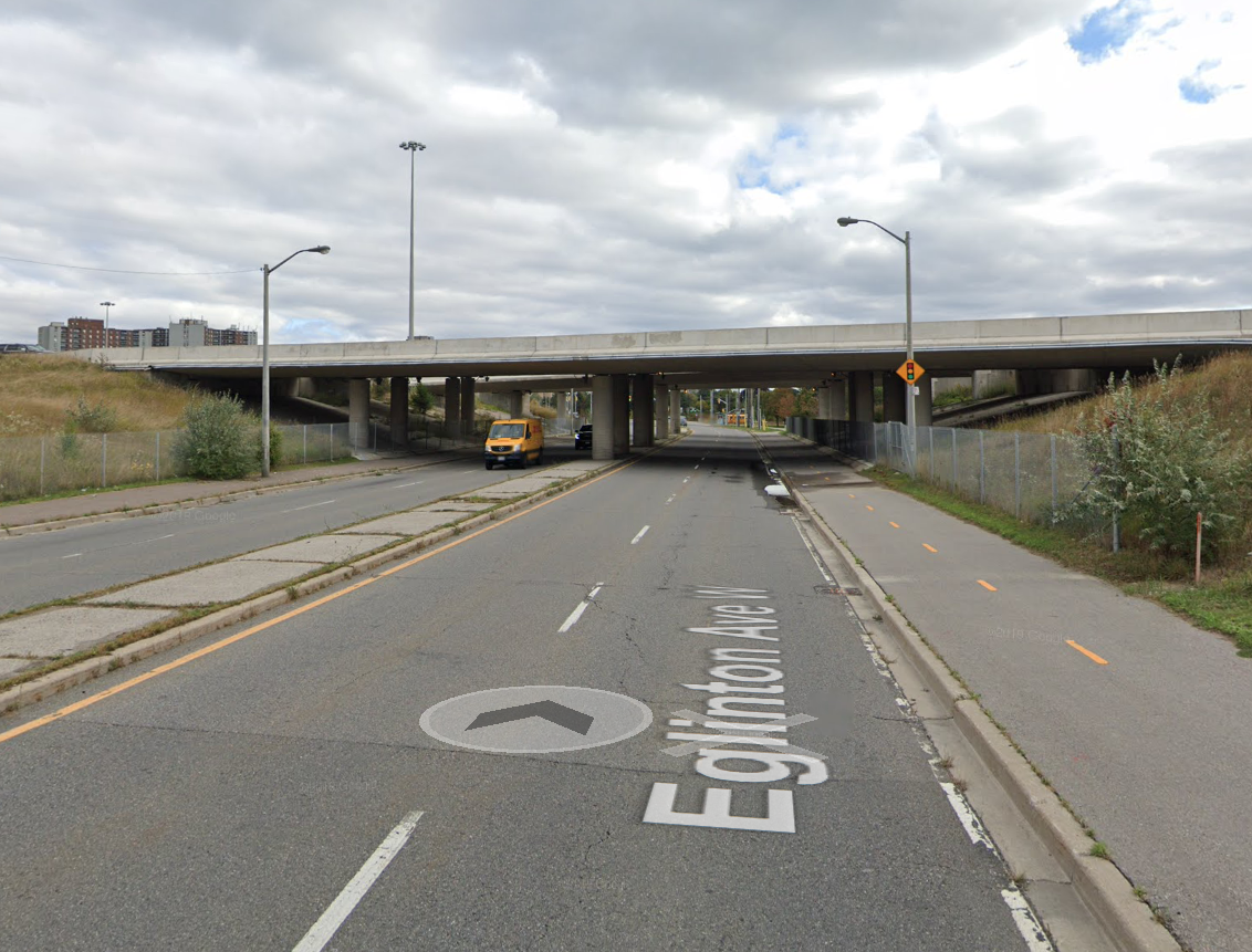

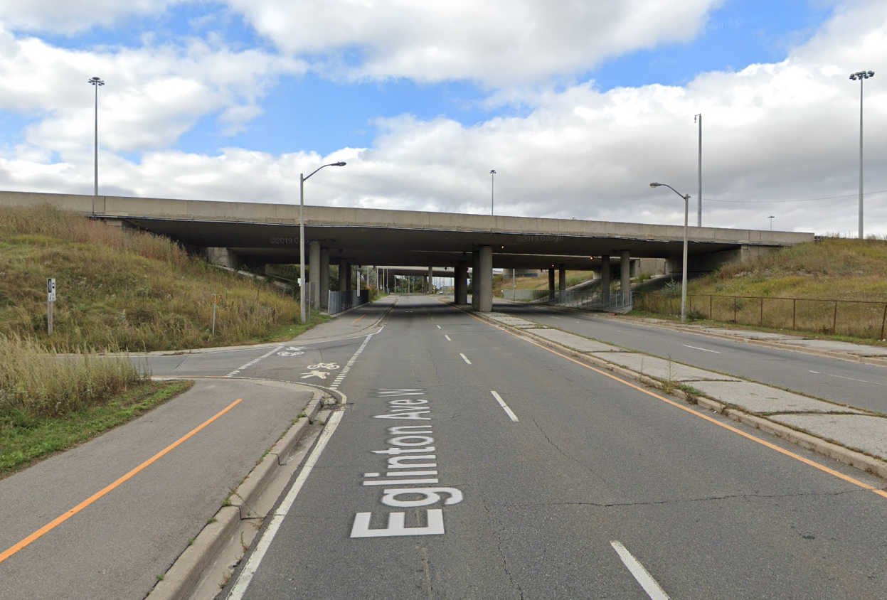

I forget where that gas main is buried, but it sure is a puzzle why the space under these overpasses can't be carved out to permit LRT. One certainly sees such widening under bridges along the 401 west of Hurontario. Just put the sidewalk and bike lanes outside of the pillars - there's room for 3 lanes wide between the pillars.
Maybe if the planners thought they were widening Eglinton to six auto lanes, they would suddenly remember how to do it?

Not sure if you can thread an elevated line above Eglinton/Martin Grove and below the hydro line - I think it would be hard. Tunneling this 2km to Renforth really kills your cost savings - putting the least residential area underground. If you are going under Martin Grove, may as well just dig the remaining 3.2km portion as cut-and-cover.
Why not over?
The hydro lines are key. if you can get by them, going over 427 is no problem.
View attachment 274860View attachment 274861
The gas line was generally along the south side of Eglinton. past Martin Grove, it sort of followed the multi-use path and stays south of the Eglinton. I am not sure you can fit both directions of LRT through the north end spans, but closing the north sidewalk and putting one branch of LRT on either side of the bridge pier would work too.
