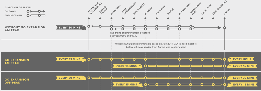

The 'Go Expansion Full Business Case' that was accepted by the Metrolinx Board in December 2018 has services that start in Barrie (Allandale) skipping King City and Maple. I believe the 15-minute 2-way service will now start in Newmarket rather than Aurora.
Using the the Kitchener line express + stopping trains operate as reference, the southbound connection at Newmarket/Aurora may be timed to be a 5 or 6 minute transfer from express to stopping, then the "express" will gain several minutes headway on the stopping train by missing 2 stations resulting in close to a 7.5 minute clock-face service from Rutherford to Union at peak times.
Where did you get that diagram? Are there more of them for the other lines?
This is a business case, not an engineering document. The graphics were probably done by someone whose sole understanding of trains is what the go train looks like.
Yea but look how watered down the vision has fallen to reality. It's not like the vision was outlandish or utopian. It was strictly about money
