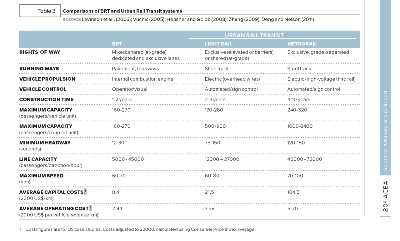

You are speaking in absolutist terms in regards to what BRT can or can't do, which I take issue with because it is way more complicated than that and has to have regard to the specific conditions of the transit corridor and transit operations. You say that BRT can't handle high ridership, and yet there are many international examples showing that it can.
As you can see, BRT when well designed, surpasses LRT in many ways. Note that this is an outdated source, and some areas where LRT prevails (e.g. vehicle propulsion and vehicle control) are no longer valid due to technological change.
A bus every 12sec, and 45k capacity per direction? Are riders dumped in through the roof with a hopper, and ejected out a hole in the floor? How many lanes would something like that need.. I don't think that's the greatest chart.
Lol, they aren't all being crammed into one bus. Picture many buses and long platforms. Here is an example of Brisbane's busway:
These numbers are highly fudged and don't make sense here because of drivers' salaries.
The TTC can't even manage a bus that comes every 2 minutes and you expect them to be coming every 12 seconds? If a bus came that frequently on a 10 km route and buses traveled at 20 km/h on average, you'd need 300 operators and buses. That's more than the number of subway CARS (not trains) running on lines 2 and 4 combined (route km of 31 km, so 3* that of the busway).
The subway can theoretically get to every 90 seconds, but Idk of any subway train anywhere (not even NYC) that can regularly hold 2400 passengers.
The vehicle operation costs make no sense at all either. 1 bus revenue km costs 7,800 CAD, and the LRT costs 2.5 times that despite running on electricity and having fewer operators.
Even then, just look at it more closely, if 6 buses come for every LRT vehicle, you're paying for 2.93 * 6 vehicles/hr, or 17.58 * 2000 USD per LRV. In other words, the LRV is more efficient than the bus if it's running 1/2.6 * as frequently as the BRT buses are. If you want train frequencies of every 4-5 minutes, you only need a bus corridor that sees a bus between 1.5 min/bus - 2 min/bus.

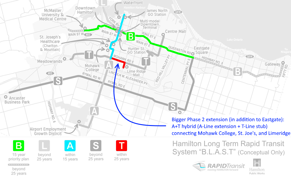

In other cities, I've seen plans resurrected as expanded plans that satisfied a larger area = bigger voter base voting for higher-order transit.
One possible initiative to resurrect the LRT -- MAY be to expand the LRT plan somewhat, if 2022-2026 window provides a triple-pitch-in opportunity (Municipal+Provincial+Federal). Who knows? Demographics can change a lot in that time.
This plans covers 6 wards instead of 4. An additional 2 city councillors onboard can mean a city may finally be able to vote to end area rating and/or vote to raise bonds for their 1/3 share.
While Hamilton has refused to fund the LRT, but Hamilton did fund the famous 2011 Business Case. Lots of local taxpayer money was spent on THOSE documents that was used to pitch province/Metrolinx to award $1B to Hamilton LRT.
But that does not mean another council (2022 or 2026) might vote on an expanded LRT plan that satisfies a larger number of Amalgamated Hamilton wards.
Now, if you also extend to Dundas, there is a potential 7-ward coverage for a Hamilton LRT plan. Sure, each level will have to pitch over $1B each level, but the demographic changes (population) and climate pressures (slow migration to additional options beyond cars) solves that city council problem (eventually), and the next couple councils later may actually vote to go with a local third pitch-in. Who knows?
The A-Line BRT can still be built to the airport, the A-Line becomes a real LRT serving "Waterfront-GO-GO-Mohawk-StJoe-Limeridge" with a very spetacularly good business case and densification opportunity.
An expanded LRT before 2030 is one of the possibilities of an LRT resurrection, because many Mountain residents were voting against LRT because of a lack of Mountain LRT. Sure, the A-Line is poor density nearer airport, but if you start with the stub -- (A single LRT route that combines the densest A-Line + densest T-Line) -- and you magically solve the Mountain Business Case problem.
