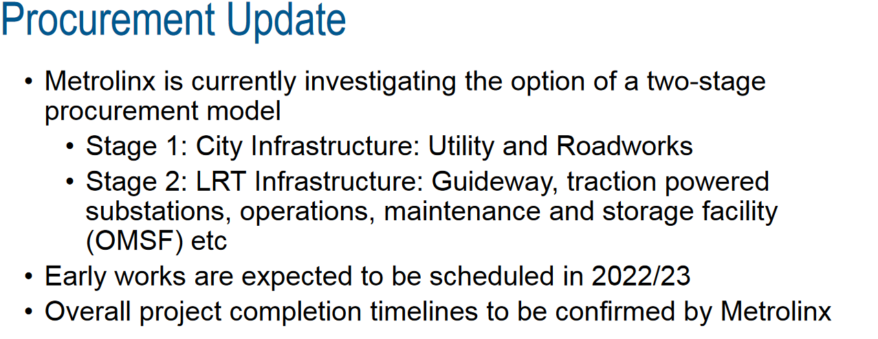

IF it works as its supposed to, Alliance is a smart way to go, and shouldn't increase costs. Take it this way. The project might have always been a $75M project, but the owner estimated the cost at $60M and traditional DBB bids were awarded in that range. Changes, claims, etc., get the project up to $75M. If they instead try to force all the risks to the contractor, their bids might actually be closer to $75M (baking in the unknown risk), but the claims take it over that. In an Alliance, the contractor is helping you set the budget and any changes in assumptions are transparently available to both parties...so maybe you come in at $68M. So its higher than what might have been a low/inaccurate estimate, but its lower than it 'should' have been because you've got early contractor involvement and can squeeze out efficiencies and do better planning.

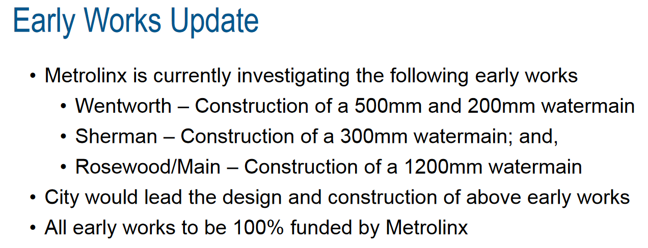

As part of the renewal, it was mentioned that the sewers will also be enlarged (possibly provisions for separated sewer for all condo newbuilds along corridor — currently Hamilton is combined).
I think the utilities upgrades are well worth it long-term.
It was already known by me since 2015 that a large part of LRT fund was the utilities redo cost.

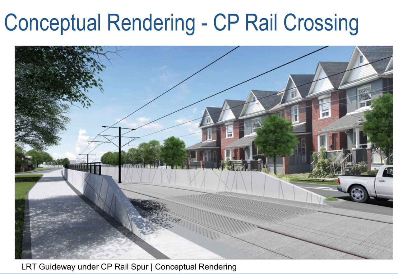

One of the infrastructure quirks I love about this project is the CP Rail spur underpass. I specifically love how the LRT goes under the freight spur, while the road stays at the surface. It makes complete sense to avoid transit delays.
I do like the idea of separating the two infrastructure components. It would seem to me that there would be a lot more expertise and bidders for the city component, so, maybe we could get a slightly better overall outcome.
Has this been done with previous transit projects?
That spur sees like 1-2 trains a day, and they are usually small trains only a couple cars long that pass quickly. That underpass is actually quite pricey for the minimal delay it saves, IMO. I believe the reason it's required is because light rail vehicles aren't safety rated to cross heavy freight tracks at grade. It's an odd quirk of railway regulations forcing a $200+m underpass that really isn't needed. The money would be better spent elsewhere to improve travel times, like perhaps building the now cancelled West Harbour LRT connection.
At 200 million, even if they ended have to have someone flag every lrv across a level crossing it’s a LONG period of operation before this grade separation makes any sense.
