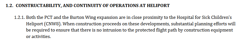

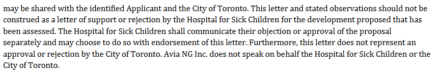

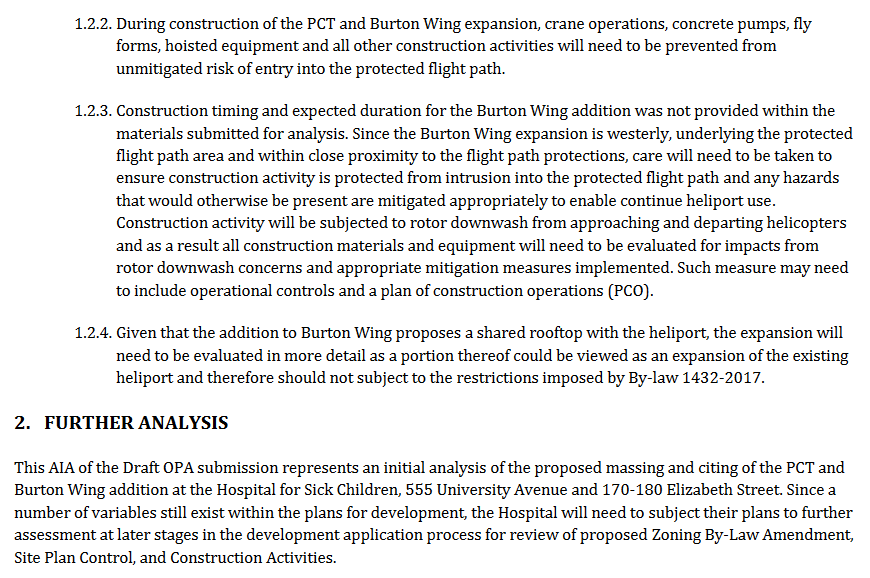

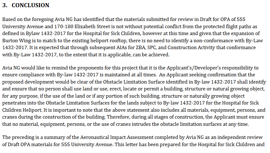

In reading the Aeronautical Impact Assessment; they do intend to keep the current helipad on the current wing.
There does appear to be sufficient clearance overall, though I believe the new tower will come quite close to the protected path. There will be implications for construction.
The Assessment is under 'Linked Document' in the files.

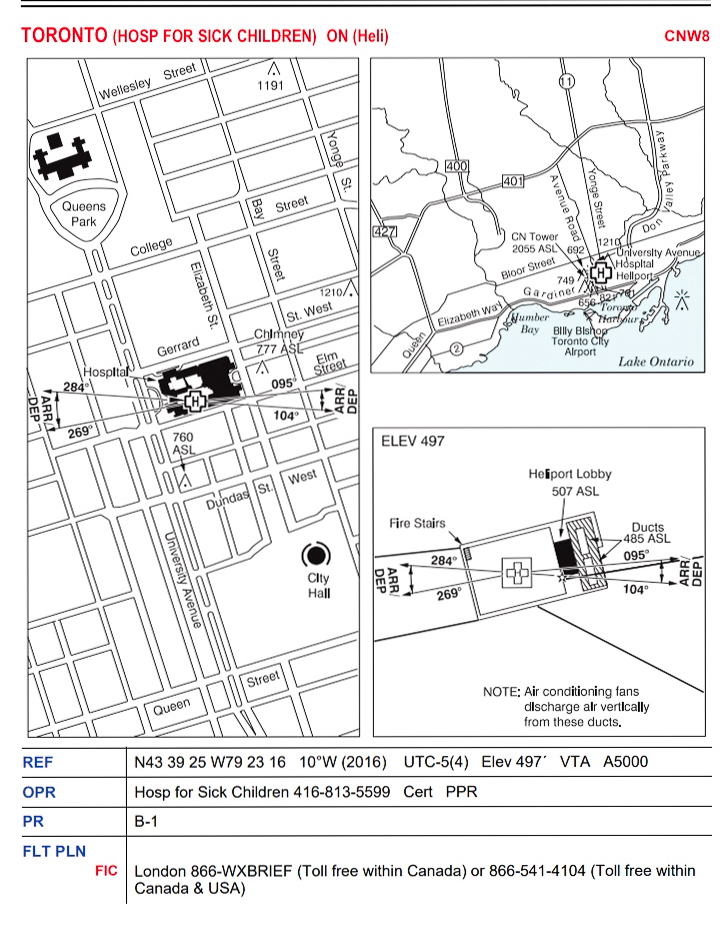

Reference the attached diagram of the HSC heliport as published by Nav Canada.
The approach / departure corridors are marked "ARR/DEP".

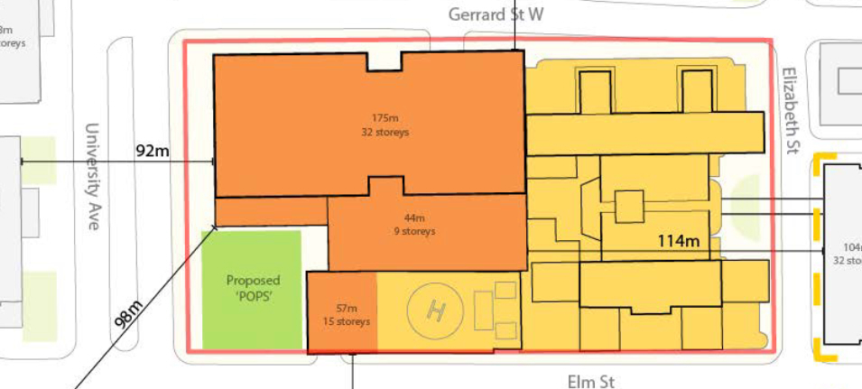

I'm not sure I'm reading this site diagram correctly, but does the orange indicate the areas of proposed construction? If so, what is that section attached to the west side of the heliport? While there may be a way to accommodate the construction of the new tower, it would be extremely difficult to continue flight operations while that heliport level of the building is extended to the west.

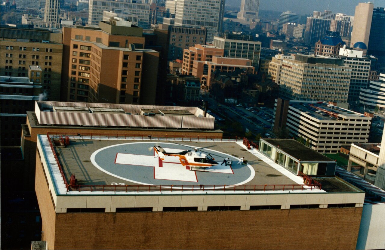

Here is a photo from the '80's that may help. Understood it's dated, but I don't believe a lot has changed since then. (FYI the H on a hospital heliport points North)
Back then the building south of HSC (525 Elm?) was being built. It may be approximately the same distance from the heliport as the new 32 storey tower.
While 525 Elm was under construction, the radius of the tower crane jib allowed it to encroach into the flight path. To ensure it was out of the way, the crane operator was contacted prior to landing / take off. Regardless, pre landing / pre takeoff checks included crane visual / confirming contact with the operator and we were especially cautious when the crane was not occupied and the jib was left to weathervane with the wind.
Flight operations to HSC continued without interruption during that time.
