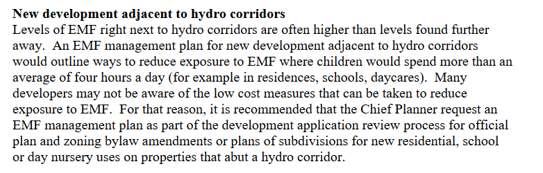

The most comprehensive, credible report I have thus far found on EMF and development/corridor usages in the City is a City report from The Board of Health dated 2008.
On hydro corridor adjacent development, it has this to say:

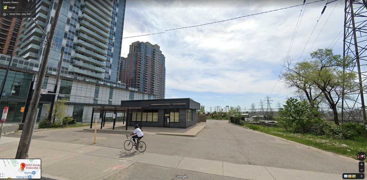

Held off posting until I took some shots of the site since I pass it on my trips to/from Kipling Station and wanted to reconfirm what I knew.
There are a number of issues for the site. The address is odd as it said its 5261 on the current building. Unless TTC is willing to allow access through their parking lot, it will be a right in/out off Dundas only. The only access will be for delivery and garbage as it will be a nightmare trying to get cars in/out for some underground parking if any at all.
If the building is on an angle or square to the property line, is there enough room to have 75 feet distance between it and the Station Tower to allow viewing to the east???
The main Hydro transmission tower is over 100' from the property line by Dundas with the wires on an angle going away from the property line heading south.
Will be surprise if anything tall is built here since there is no place to park cars other than a 10 floor parking above grade which will be over kill with transit at the front door that runs 7/24/365 a year.
