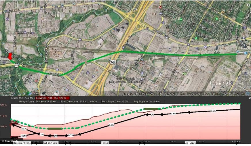

  • The first phase would be a simple extension just on the north side of the railway ROW (maybe need to expropriate a 6m swath to widen it, but I do not think so).
  • It would continue at grade to the East Mall (Honeydale). This Honeydale station would be 350m away from a Cloverdale station - essentially the exact same catchment area.
  • The next phase would require tunnelling to get under the railway and 427. There is 400m to drop the 10m or so to get under those obstacles.
  • The extraction site for the 1.5km tunnel would be in the parking lot of Sherway, where the station would be located.
  • The tail-tracks would be cut-and-cover under West Mall.
  • Depending on where the line will continue to, a new tunnel launch site could be located just west of the West Mall, or it could still elevate over Etobocoke Creek with a steep, but still reasonable slope.
Issue 1: You have about 250 m to the GO Tunnel and you need to be down 15-20 m min by then from the current west end of the station, not the trail track.
Issue 2: You need to be down 35-50 m by the time you hit the condo as there 3/4 levels of parking there.
Issue 3 You will raze most of the plazas & industry west of the condo to get to grade to go over Shorncliffe Rd. Doing so will create empty unused land until development surface for it.
Issue 4: You need to do a deep dive for the Honeydale terminal to get under both the rail corridor and the East Mall which is no simple feat going over Shorncliffe. You are better off being below grade. You are creating a roller coaster engineering nightmare in designing it and building it as well having equipment not being able to handle it.
Issue 5: You just reduce the development land unless there is provision for development to be built over your plan.
Issue 6: You have created a greater walking distance than a central one being beside the rail corridor.
Issue 7: There is nothing at Sherway to support a station there now nor 50 years from now other than a mall, 3 towers and strip malls. Look how long it took to get One Sherway towers sold and built.
Issue 8: You need to raze Homes and industrial going west of Etobicoke Creek as well a GO station to take the line to Dixie. You are asking people to spend 5-10 minutes walking to a bus route as buses will still have to run along Dundas to service the area.
Issue 9: Based on the design of the terminal that just been posted, next to no room for any extension, let alone room for construction of one without having an impact on the terminal.
Issue 10: All the south side of Dundas has development plan for it from Kipling to 427 and having the line going along Dundas, it allows the north side to be develop, but at a slower rate since you have an old low density area there now.

1. There is a pedestrian tunnel at the east end of the platform. That is already under the TTC tracks.
2. There is room between the GO tracks and the condo – no need to go under the condo.
3. One factory may be affected. Much of the industry will be removed for redevelopment.
4. Oh, now I see what wrong. I was planning on going above Shorncliffe and East Mall, not under. My point was to build the extension to Honeydale to have a station near the 427 for as cheap as possible.
5, 6. The short distance between Honeydale and Cloverdale means there is virtually no difference on the development potential of the area.
7. At Sherway, there is land and the mall owner could jointly contribute and the box stores could be redeveloped.
8. I have not put that much thought into where the line would go after Honeydale. It could go south to Sherway. It could also tunnel under the 427 and Etobicoke Creek and join back up with Dundas. I also do not know where it would go after Dixie. Does it follow Dundas to Hurontario, or, does it go up to Sq.1 – like I said, I have not considered it that much, but the extension to Honeydale does not preclude any farther westward extension.
9. The terminal that is posted is assuming there is no extension happening to the subway, so of course it does not allow for expansion. The thing is EITEHR we build the terminal at Kipling, while maintaining an active subway, bus and GO station, OR, we extend the subway one stop and build the necessary infrastructure away from any active transit areas. We do not do both – and with the less disruption at a Honeydale location, and the possibility of an at-grade extension, the additional costs may not be as much as it first appears.
10. The 350m distance from Honeydale station at CPR and Cloverdale station at Dundas will not be enough to affect the development of the lands – especially the south which you say will be more dense.
