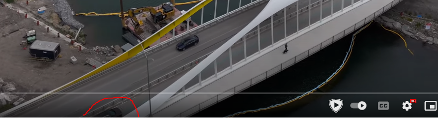

I love how the flyover manages to capture someone driving in the bike lane in the first ten seconds

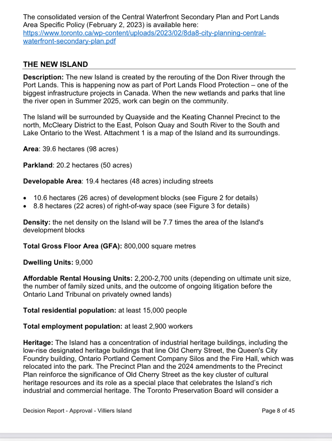

Thanks all for the attention to my piece last week. I’ll make a few points and duck out.
1. Villiers is not close to the densest big project in Toronto. Ignore the 20ha river parks, and it is 450 dwellings per ha and 4 FSI gross. Most if not all of the big private masterplans in Toronto exceed those numbers, many of them by a lot. And they lack the presence of the river parks, an incredible amenity.
2. 45% of the neighbourhood (8.8/19.4) is roadway. That’s why the neighbourhood is not in fact very dense. The math is punishing.
3. No one has ever made a clear defence of that design decision. Where is the rationale? Where are the precedents? What I’ve heard, including on here, is basically: big streets are nice and the West Don Lands is great.
That’s nowhere near rigorous enough to explain a decision to spend several hectares of the most valuable land in the country.
I also think it’s wrong. The good things about the WDL are Corktown Common and arguably two blocks of the Front St promenade. It’s car-heavy with a lot of dead space. One of its main components, Lawren Harris Square, is a complete failure.
I see sloppy, undisciplined thinking, both about design and about the potential use value of this land, and it makes me sad for the lost potential. YMMV.

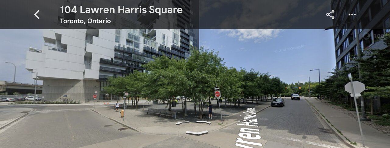

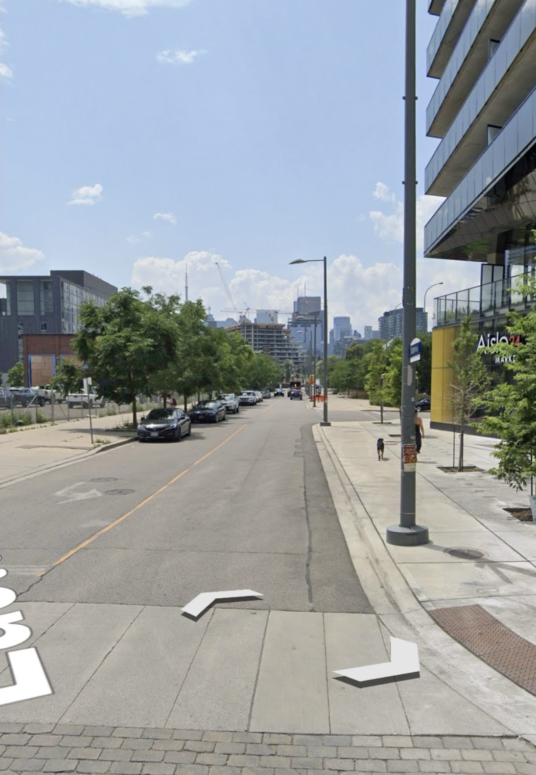

View attachment 573484View attachment 573485
Thanks, Alex, I appreciated your column and Twitter threads on Villiers Island. We agree on some items, while diverging on others.
Quick question:
Does the 45% figure include the land used for the LRT lines, bike lanes or private roads? I'll admit I've found it difficult to ascertain the total HA of Villiers between the channel, parks and roads.
Also, how does this 45% figure compare to the West Don Lands, or say, Liberty Village?

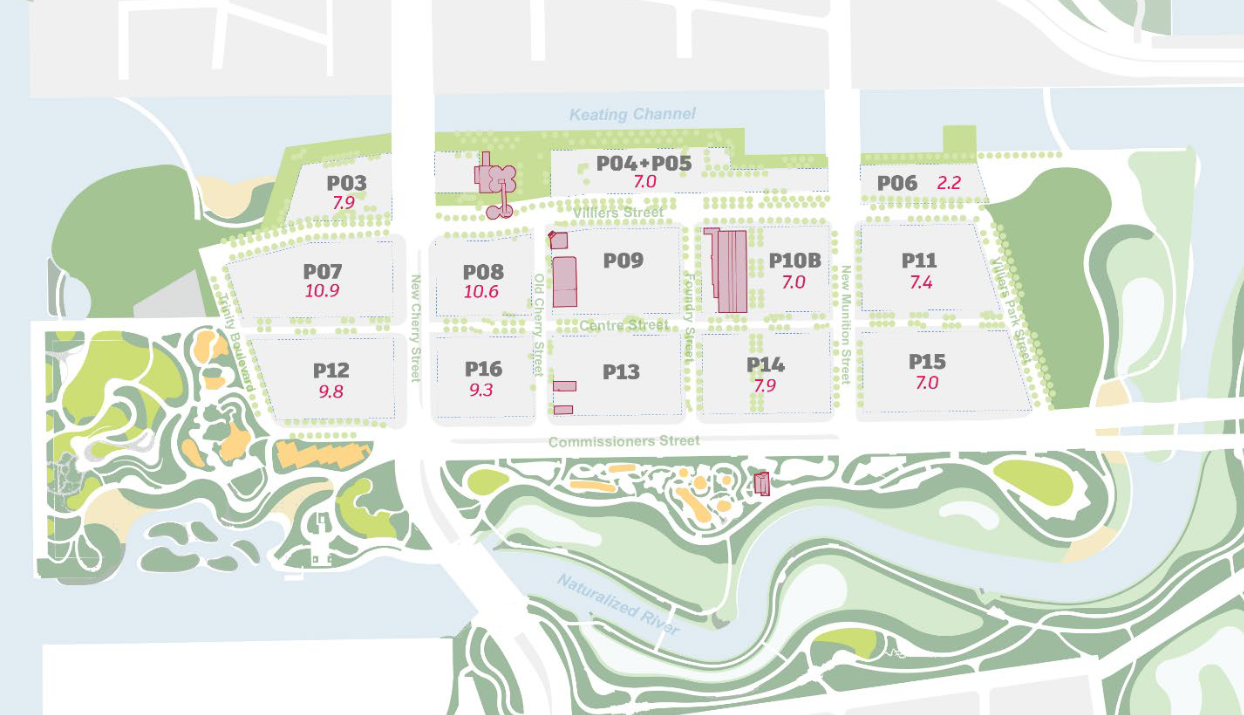

This is not correct. This includes the river valley lands.
The FSI of the developable parcels is 7.7. But that is misleadingly low.
That includes the provision of non-river valley parklands, and a site for a school that has an FSI of 2.2
Here's the actual FSI on a block by block basis: (in Pink)

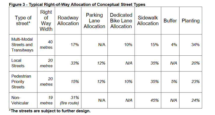

Please cite a source for this.
Roadway is a percentage of ROW and that distinction needs to be made. ROW includes pedestrian exclusive and pedestrian priority streets, describing those as roadway is simply not reasonable. (one can debate the size of the ROW, no problem there, but let's be clear and not confuse this with space devoted to cars)
This is fair. LHS was questionable at best conceptually (it's small, awkward and surrounded by roads) but the actual design, such as it is, is abysmal, and clearly hasn't worked.

TFS are definitely an issue, in the past, (I haven't spoken to Planning about this recently) their demand was 11M curb to curb (so sidewalks/boulevards are extra).
The minimum functional requirement for two-way traffic is 6M, though some would argue for 7M (3-3.5m per lane). That minimum presumes no on-street parking.
Looking up to the chart I posted, travel lane + parking appears to be allocated at 9M, so they seem to have reduced the TFS demand, at least a little. (Local Street - Sidewalk plus Planting Zone shows as 11M, out of a 20M ROW)
