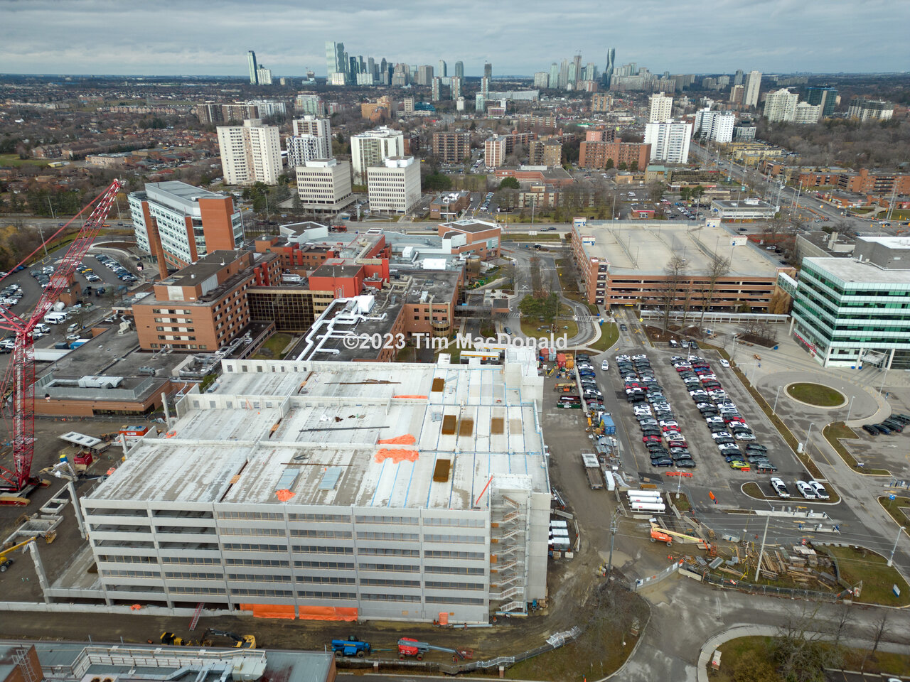

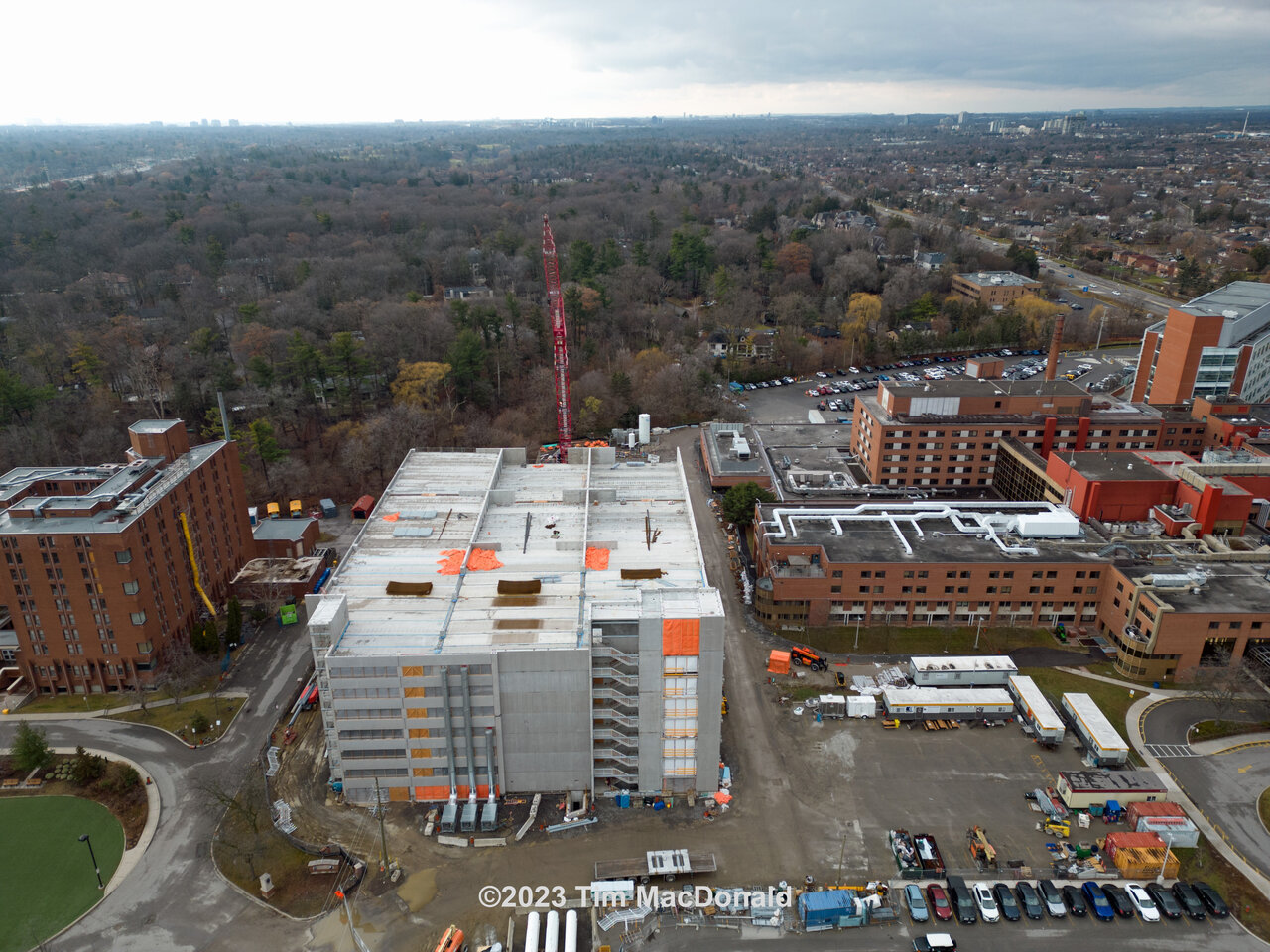

Only 2 more bays to be installed to complete the parking structure and could see service by the summer.

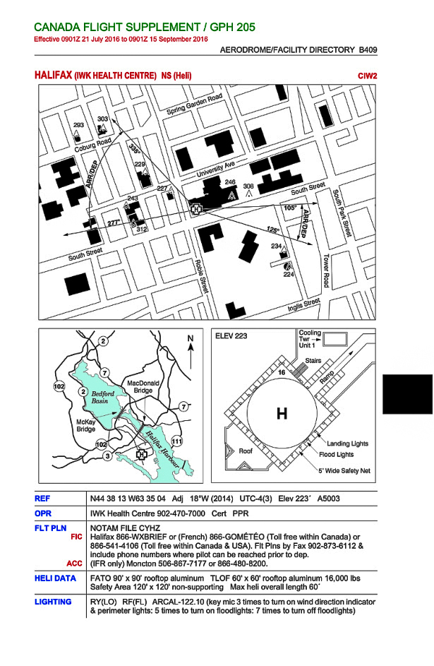

This 2016 look at the IWK rooftop shows an excellent example of ideal approach departure corridors (marked ARR/DEP). Built on an older structure, IWK used the same deck system as St. Mikes.

5 more floors to be installed for the last bay
Once this open, the old one can be torn down.

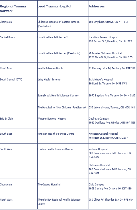

This is the current list of facilities in Ontario of this type, several are actually a step down from the level of care at Sunnybrook, etc. But are far enough away they are the go-to for trauma in their area.

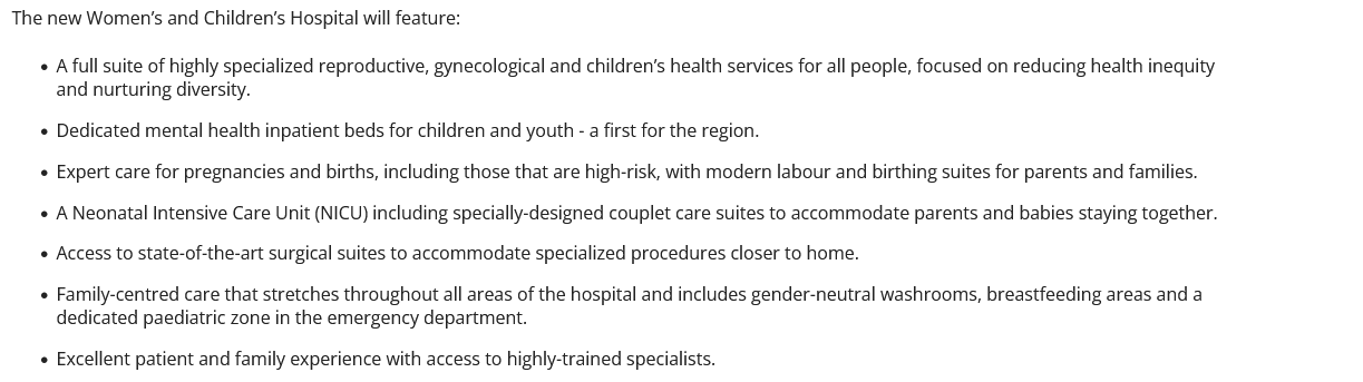

The redevelopment will include the construction of a Women and Children's Hospital, per a recent news article.
I don't keep up on all the Mississauga threads the way I should..........
* Note, the link above does not go to an article ; but ya got me looking for info.
So.......I found this:
From which we learn that they are marketing this as a women and children's hospital, but .....it's really 2 floors out of the main hospital building, with a focus on certain care aimed at women (obstetrics etc.) as well as pediatric care.
This is the explainer bit:
A lot of this can be found in most larger community and teaching hospitals; but the program sounds a bit more robust, and they've maybe done a bit more to co-locate some services than in the past.
It is my understanding that the hospital will have the largest ER in the GTA on a 7 x 24 base as well as a Trauma Centre including operating rooms.
As for the women and children hospital, I don't expect it will be a standalone building, but a section of the main building.
