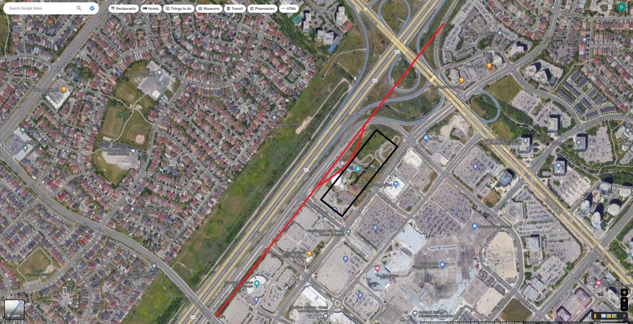

After having been to Ottawa, I was inspired by what I say with their own bus transitway. There is so much room for improvement for the Mississauga transitway. There needs to be a grade separated, bus lanes that runs by Square One. Has there been any consideration by the Ontario government to purchase the Playdium land and turn it into a proper transitway station? Have the bus lanes tunnel under Hurontario until it connects with the existing Transitway. Allowing buses to completely bypass Rathburn.
- Design the SquareOne Transitway Station in a similar fashion as Tunney's Pasture in Ottawa. Direct connections with MiWay buses. New bus loop.
- West of the station have the bus lanes below ground level, running parallel with City Centre. The lanes would go under Duke of York and Station Gate. Construct bridges for both roads to go over the transitway.
- East of the station, tunnel the lanes under Hurontario, LRT and the on/off ramps and then bring the lanes back up until it connects with the existing transitway lanes.

In before, "you can't just draw lines on a map, blah blah blah."

This I agree with and something the City and ML are looking at or supposed to be. Hazel couldn't find the $20 Million to tunnel under Hurontario St to the underground Station at CCTT that was build in the 90's for it when it came time to built the Transitway.
I been pushing for over 15 years to move CCTT closer to Hurontario for the LRT and better access to the Transitway that can handle 150,000 riders a day considering we are close to 70,000's today, if not more.
The New underground station is to support short tunning of GO Buses as well doing layover. Since this is part Square One District Lands, development needs to be built over the Transitway
The transitway Transit Terminal is supposed to be underground on either one side or another for Station Gate/GO Terminal. How to get to the northside is another story as it was proposed over a decade ago to use an elevated overpass for Duke of York to connect to the new North Service road with the Transitway being next to it. Another option would see a tunnel under the 403 to the north Transitway to fill in the missing link.
Using that block as noted, it puts GO and miWay on the northside of the LRT Station and all of transit in one location. You can even put development over all of the transit station
To do any of this boils down to money to build it, cost of the land OMERS wants for it as well give up and why I am pushing for development over the whole transit including the tunnel section as it becomes a win win for everyone.
