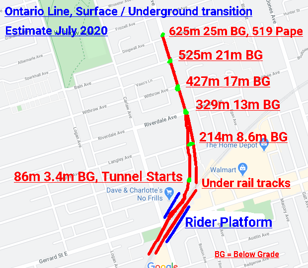

Please give some feedback as to the Ontario Line track slope and if I have it correct.
Depth / Slope of tracks ascending to surface OR descending to tunnel
  • Based on a discussion with a Metrolinx Engineer at the Open House Tuesday, January 28, 2020 - he confirmed that Ground zero would be the No Frills Grocery Store at Gerrard and Carlaw. He also confirmed the following
  • 25m - depth subway portion runs underground ( Below Grade )
  • 4 degree, 4 percent slope for the track
  • 25m / 0.04 = 625m for the sloped portion to reach Grade OR reach 25m depth
West Side Track that travels South - this will be the slope and depth looking north
  • 0m NoFrills Ground Zero, S side of NoFrills at the train tracks
  • 86m Tunnel starts i.e. no more daylight 3.4m BG Just SW of Carpet Mill front door
  • 214m Langley 8.6m Below Grade (BG)
  • 329m Riverdale 13m BG
  • 427m Withrow 17m BG
  • 525m Bain 21m BG
  • 607m Dingwall 24m BG
  • 625m 519 Pape 25m BG
Route to Surface
  • West Track - Travelling South, 86m from NoFrills, the tunnel will see daylight at 3.4m BG
    • Just SW of Carpet Mill
  • East Track - Traveling East along the Go Corridor, descending for 86m, the track will reach 3.4m and will no longer see daylight. This will allow it to turn NE and travel under the Go Corridor. The tunnel will continue N till it meets up with Pape at Langley
  • In an email and phone call with Metrolinx, they could not confirm the above and only said we would get the data once the RFQ’s were made public.
