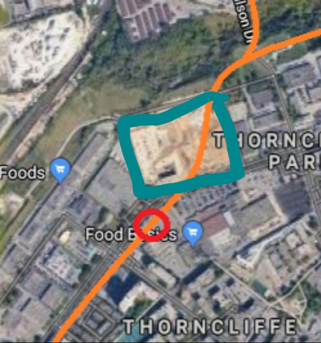

WRT the Thorncliffe Park alignment, is it possible to divert the line from Overlea across the Costco parking lot to the hydro RoW then across the valley? SkyTrain in Burnaby cuts across a Home Depot parking lot the same way.
Stations would be located on the mall parking lots allowing for cheaper "side-of-road" configurations instead of median stations which require mezzanines and have to be taller.
This is what I could see based on the way SkyTrain has been fit into the urban fabric in Metro Vancouver.
It would also explain why Metrolinx would be in discussions with stakeholders - for station sites and rights-of-way.
That would also put the line next to the proposed Maintenance and Storage Facility site with a short spur.
This is the alignment that makes sense to me:
So this site is available? Looks like it was recently cleared?
Still thinking that this sort of allignment is possible in the Thorncliffe Park area,
maybe with the valley crossing to Don Mills a bit farther north to shorten the bridge.

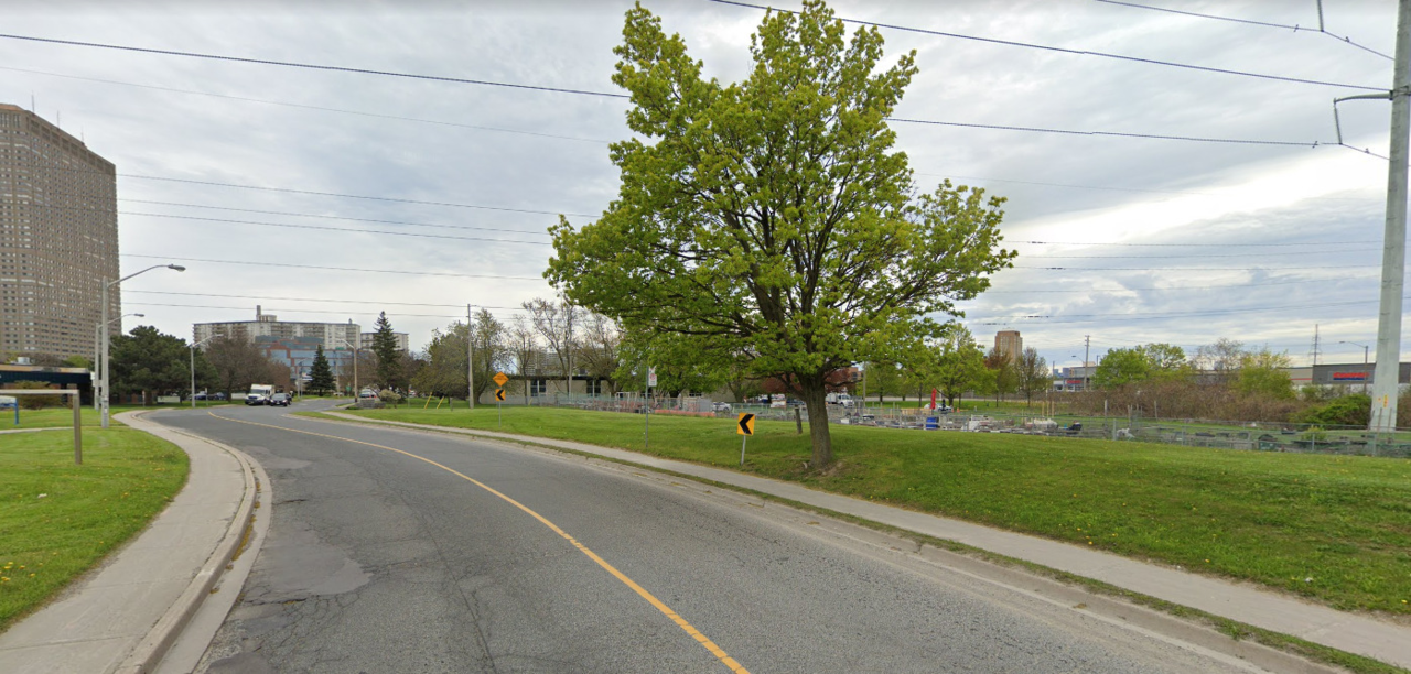

That valley is the Gatineau Hydro corridor.
I don't see Hydro one allowing anyone to run under or over their towers, and I expect there's a minimum clearance to the side as well.
Assuming one could get around those challenges, portions of that landscape are environmentally sensitive and constructing supports in them would be very damaging.
The alignment would also likely pass directly over a community garden (one of the largest in the City); and also a cricket-pitch/school yard that the community fundraised to build.
Also, dropping people in the Costco parking lot would be highly inconvenient for area residents whose homes are all south of Overlea, and either east or west of this location (on Thorncliffe Drive).

The hydro corridor might be an issue, but lines could be raised if necessary.
The SkyTrain shown in the Home Deport parking lot segment actually goes under a BC Hydro transmission line as well, so that's probably an access issue, not a proximity issue.
The Canada Line North Arm Bridge is also near some transmission towers:
The columns and bridge towers could be placed to minimize impact on environmentally sensitive areas.
There are community gardens under Vancouver's SkyTrain guideway, so the uses are not incompatible.
I was thinking that the station would be on the Food Basics mall parking lot south of Overlea - that site would be ripe for transit oriented redevelopment - like Burquitlam Station in my post.

As to redeveloping East York Town Centre (the landlord of Food Basics)
I certainly agree that's overdue for redevelopment and ripe for intensification.
However, the landowner knows that too.
I expect the price would be steep for crossing the land at grade.
Would have made a world of sense of the City or Province to buy this site before announcing the Ontario Line.........It has now surely doubled if not tripled (or more) in value.
I looked at the Google image of the lines too and they'd have to be raised.
The guideway coming down to grade would probably take up too much space, but Vancouver's SkyTrain ducks under the Georgia viaduct that way.
Conceivably, Metrolinx is a provincial agency and Hydro One is at least partly owned by the Province of Ontario.
Maybe they might play nice with each other !
I wouldn't expect to cross the Food Basics lot at grade. I'd think they'd elevate and just take a portion close to the road.
The landlift from having a station on site would also benefit the landowner.
In the Burquitlam Station / Burquitlam Plaza example in my post, the landlord is Morguard and the plaza is slated for redevelopment.
Hey - just googled and East York Town Centre is also owned by Morguard!
