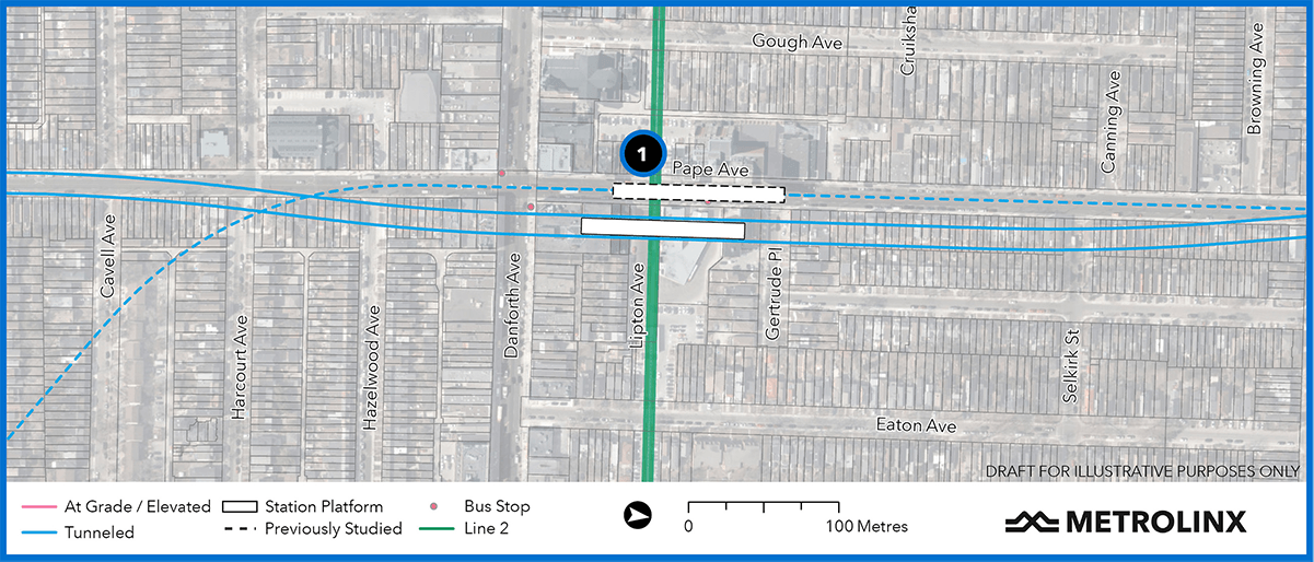

What is the line heading off to the South-East. I thought both the Relief Line and previous Ontario Line would be coming straight up Pape
That was a notion to swing to the east and back in order to get up onto the rail corridor sooner and have Gerrard diagonally across Pape and Gerrard. It would have been more expensive to build and operate.
