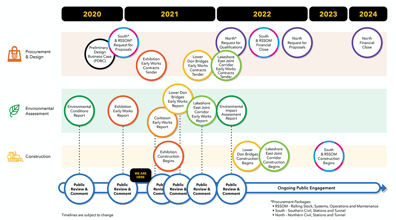

And the bad news...
The exact vehicle used for the Ontario Line will be determined by the successful proponent for the Rolling Stock, Systems, Operations and Maintenance (RSSOM) contract, based on Metrolinx’s requirements.
So still don't have the exact dimensions other than guesses.

And the bad news...
This is good news at the end, it means that an international operator with more experiencing running metro systems will be making the train decision, not the TTC. Likely will mean a more modern and reputable train design.
