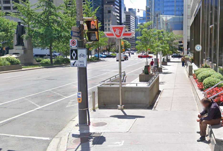

There is already a shelter at the Queen and University stop. Why can they not instead make it longer? If you wait in the proposed station building, you'd likely not even see the streetcar approaching!
. Not to mention, I doubt with modern safety standards a sidewalk entrance would fly. Looking at the entrance on the SouthWest of the intersection, the amount of sidewalk left is basically non-existan
If you mean the entrance on Queen, I agree. If you mean on University, I don't agree, there seems to be ample clearance, and there is a substantial stroad right next to it that could be encroached on.

Have you looked at the width of the sidewalk at that intersection?
Curiously enough, I have.
I think your armchair vantage point is faulty, I see plenty of space. Expand the sidewalk at the cost of the rightmost lane, build the building, and leave the damn park alone.

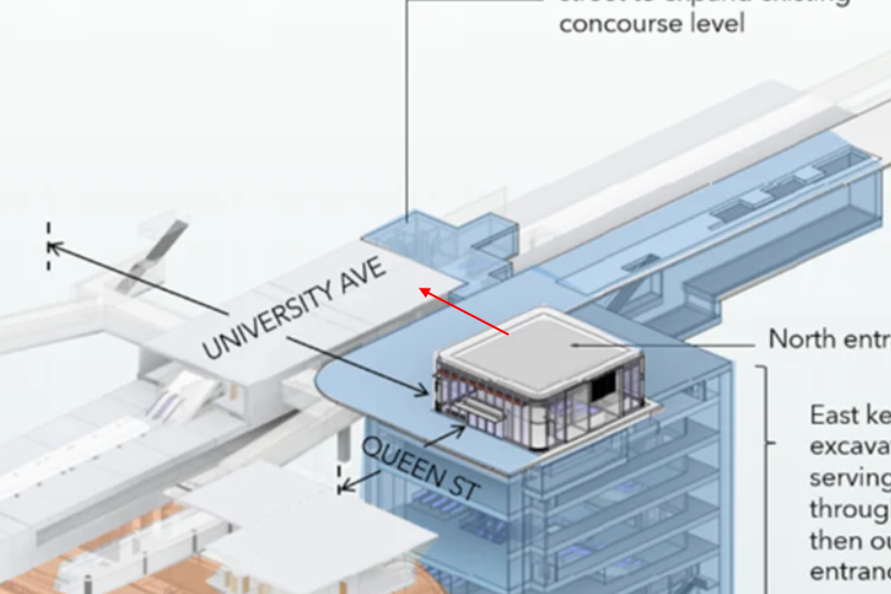

Doesn’t matter how big the entrance building is, as long as that access shaft has to be dug, those trees will have to be moved or cut down

The existing station box is what Metrolinx is trying to avoid by putting the access shaft westward.

Metrolinx is trying to learn from their previous experiences in constructing the Eglinton Crosstown (Entuitive Engineers Are Playing a Major Role in Crosstown LRT Project: Robert Mackenzie Dec 4 2020, UrbanToronto). Avoid underpinning existing station boxes because that is expensive and time consuming and you never know what you might discover underneath. Additionally, by providing the existing station box a buffer from construction vibrations, you can work at a faster pace. This was a problem in the Crosstown because Yonge/Eglinton remained at peak capacity during the construction and there were very tight tolerances about how much the existing station structure could shift during construction.
Quotes from the article above illustrate some of the challenges that happen in such complex working conditions.
The TTC had very strict limitations on the amount of movement, explained Michael Meschino, a Principal at Entuitive. "The requirement was three millimetres of differential movement at any one joint. Think of it as a string of sausages, with joints between each of the pieces. So, each piece of subway box is an element and there's joints in between them. So, each of those pieces can't move any more than three millimetres, and any more than that you start to distort the box, you start to distort the tracks and you interfere with the subway operation."
"The engineering work to get this done was actually a very elaborate staging analysis," Meschino said. "We had to model the stiffness of the soil and what happens when you remove a portion of it. Every single stage along the way was modelled. We had to model the stresses and deflections of every stage—100 stages at Cedarvale, over 400 at Yonge. The needle beams had to have their loads adjusted and reduced as the jacking forces were applied."
According to Stephen Brown, also a Principal at Entuitive, "The situation at Yonge was a bit more difficult than at Cedarvale in terms of the ground conditions and the width of the TTC box. The ground was a bit less stable at Yonge-Eglinton than at Cedarvale. Each one of the props was jacked immediately, to reduce deflections further. Since the current Yonge-Eglinton subway station had a middle platform, the station box was wider. Joints were badly placed for what we were doing and we experienced more sensitivity to movements. We had to keep loading and unloading the props to get them to balance against the excavation work that we were doing."
Brown said, "A different engineer was doing the bulk of the excavation. We had responsibility for the area directly underneath the TTC box, each side, for somewhere around the first three metres. Basically, the depth of the underpinning beams and the related work. And that has to be self-supporting with the final excavation, which was going many more metres down, supported somewhat separately in there. It's a complex piece to get sorted out because it's critical to keep the TTC box in proper shape, keep the soil which is directly under that corner from softening and allowing a settlement to occur. So, it's actually laterally pre-stressed into the wall, much as we were doing vertical pre-stressing, while jacking our props all the way along. And then the other engineers got to take over for the rest of the work going down."
In total, the underpinning process required a total of sixteen weeks, from the start of tunnelling to finalizing the cradle. The subsequent excavation work required another six months.
"This was as complicated a piece of engineering as most of us have done," Brown said.
A relic from a previous transit project near Cedarvale also presented a problem for the engineers to solve.
Meschino told us, "In the early 90s there was an Eglinton subway actually planned, designed, and under construction before it was shelved by the Ontario government. As part of the Eglinton subway construction, they built a huge new sewer structure that runs north-south through this site and they lowered it to be able to go underneath the subway structure."
He continued, "Well, now fast forward till we get to the LRT, and the actual LRT box is deeper than the subway structure was going to be along Eglinton Avenue. So that sewer that they relocated was now in the way. It was actually interfering with the [station box], so the alignment had to run above the sewer. And the sewer, by the way, is to the west of the existing subway, so we had to get above the sewer, but below the subway structure. It really squeezed the alignment for the new LRT, but it also created a situation where we had to analyze the actual sewer structure to figure out how to protect it and make sure it wasn't damaged during the construction of the new LRT structure.
Yu said, "I was standing on top of that sewer myself, when it was excavated. The geometry was so tight, we had to arch the permanent placement of the new station just a little bit, arch it over the existing sewers. We also insulated the pipes to minimize the construction impact to the new station."
So we can see in the design of Osgoode and Queen, Metrolinx learning from their experiences at Cedarvale and Eglinton in trying to reduce the complexity of construction.
Perhaps they are overlearning those lessons but given how bad the result has been on Line 5, there might be alot of institutional scarring going on. (Of course they might have not learned any lessons because Royal Orchard is so deep).
