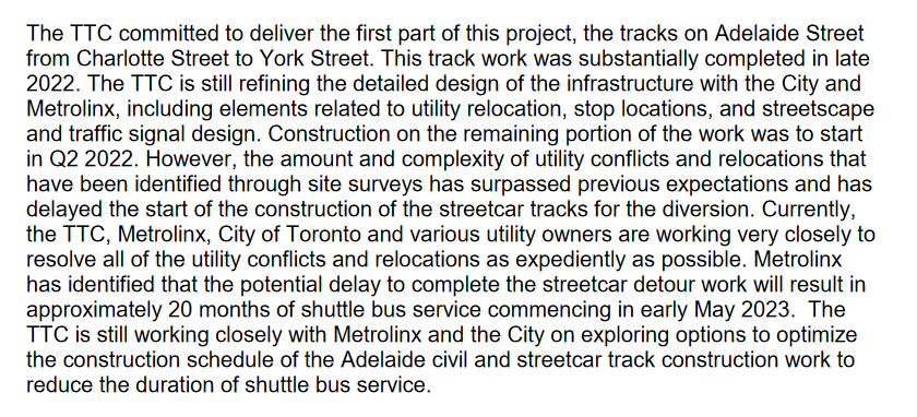

The closing of Queen Street from Victoria to Bay will be a HUGE mess no matter what but it might have been slightly better for transit users if the Metrolinx Gang had got their acts together to build their part of the Adelaide Street and York Street tracks. (The TTC and the City managed to finish the tracks in their section - York to Spadina - a bit early and are now working on the new overhead.) No doubt the City cannot refuse to close Queen until they get the detour tracks up and running but ....

seems like the detour work will take almost 2 years before theyre up and running.
2 years of shuttle busses instead of streetcars going down adelaide
