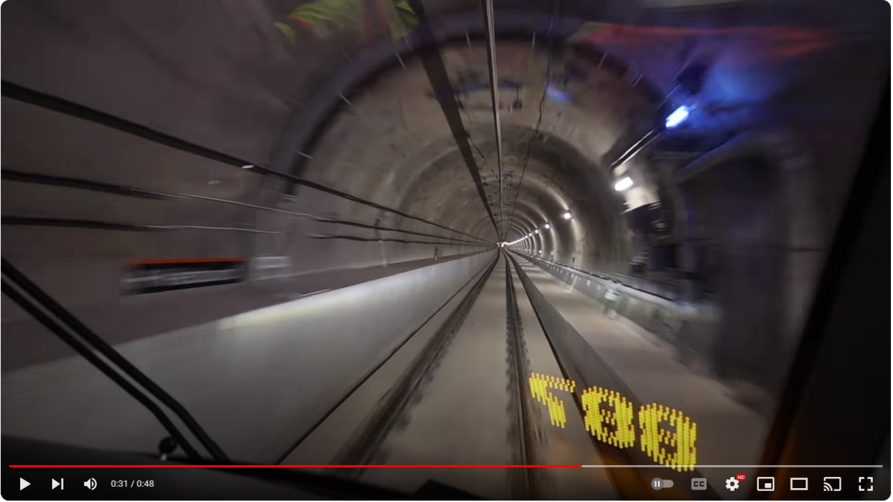

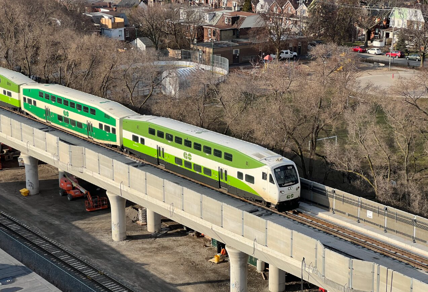

A quick screen grab from the testing of the Eglinton LRT shows rolling stock entombed in concrete, that extends far behind the tunnel walls visible to a rider. On the contrary, the Davenport Diamond is a flat deck of concrete with support posts ever 10mish. This is no hard science but one is clearly using less concrete.

View attachment 515703View attachment 515704
A lot of the strength of a tubed concrete structure is due to its shape. All of the tunnel liners are shaped to lock into themselves, and are then reinforced to each other with long bolts. The pieces that form the walls are surprisingly thin, only about 12 to 15 inches or so. Beyond that distance is just dirt and sometimes grout, but in the context of something like a tunnel the amount of grout is negligible when compared to the amount of concrete.
With the elevated guideway, a box (chambered girder) is required for strength under each track. And it's surprisingly deep - in this particular case I believe that the box is about 8 feet from the top surface to the bottom. While the box is hollow, the walls are almost the same thickness as those for the tunnel liners.
The volume of the pillars on the elevated guideway is not inconsequential, either - they go down far more than what you see above the surface.
Feel free to do the maths on this, but I suspect that you'll see that the difference per foot of length is not so great.
I'm not saying you are wrong on the amount of concrete being more, but entombed in concrete is a bit of an overstatement. Most tunnels are built with precast concrete tunnel liners and not some guy who dug a hole and is filling it all back in over-zealously with concrete. Also, unless the tunnel is running through a liquid, the tunnel does not need to carry the whole weight of what is above it and the shape of the tunnel is about reducing the load the tunnel needs to support. Lastly, unlike an elevated structure the tunnel does not need to lift the train above the ground... it sits on the ground beneath it so it doesn't require cement columns going deep into the ground. So, maybe there is more concrete in a tunnel than an elevated structure but if so I doubt it is by the order of magnitude you think it is.
